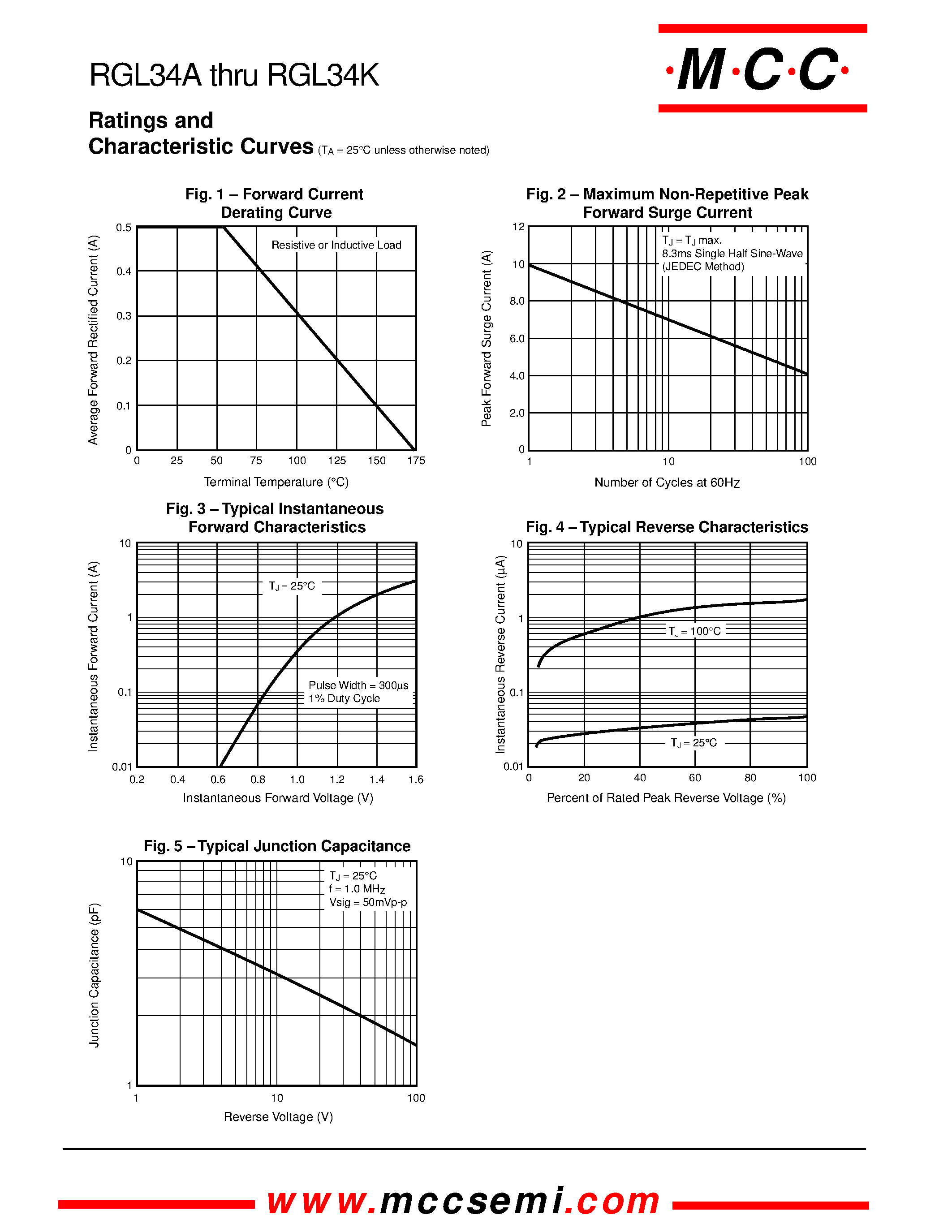

RGL34A-0.5 Amp Fast Recovery Rectifier 50 to 1000 Volts
Description:0.5 Amp Fast Recovery Rectifier 50 to 1000 Volts
Others with the same file: RGL34A
Datasheet RGL34A - 0.5 Amp Fast Recovery Rectifier 50 to 1000 Volts page 1
Datasheet RGL34A - 0.5 Amp Fast Recovery Rectifier 50 to 1000 Volts page 2
