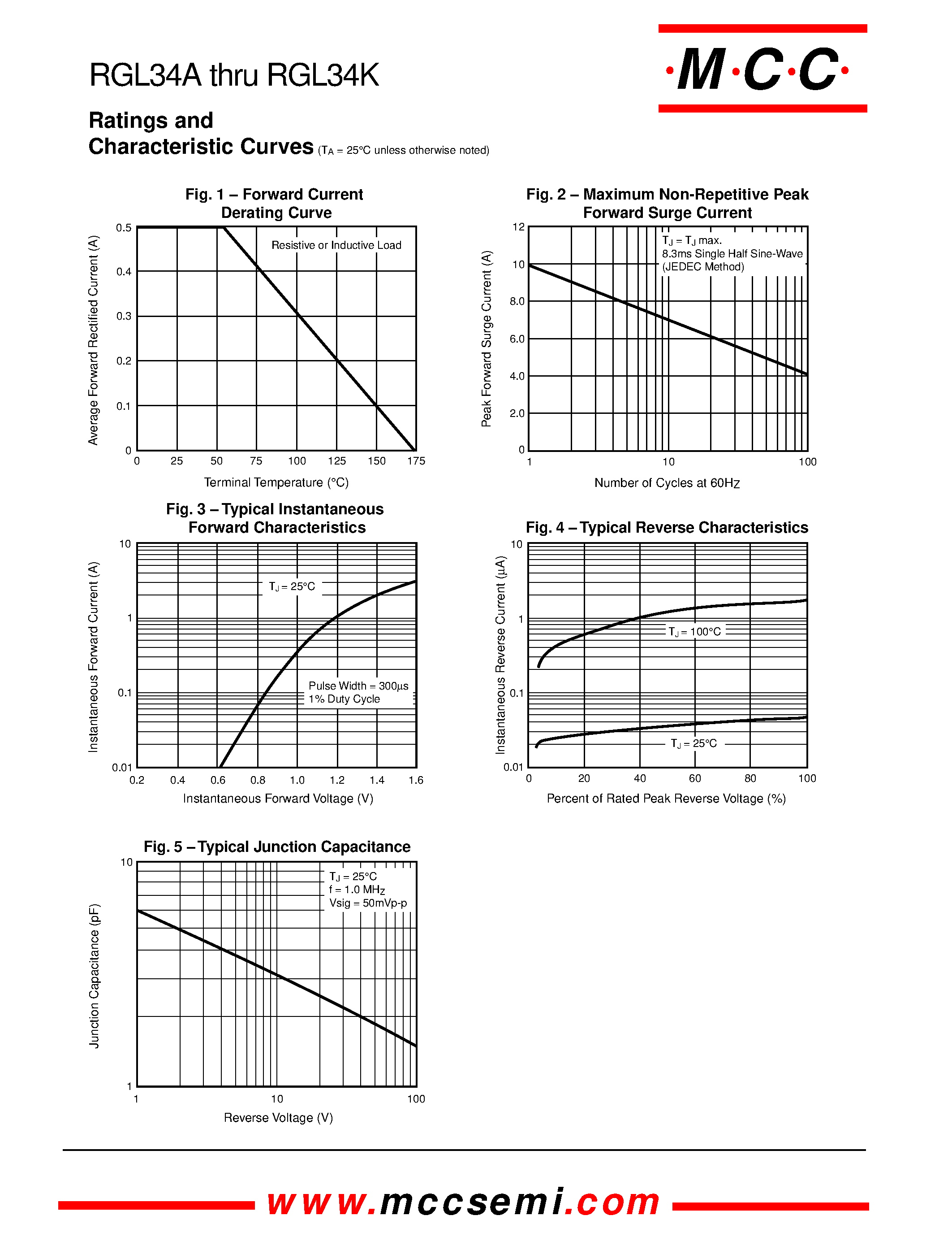

RGL34M-0.5 Amp Fast Recovery Rectifier 50 to 1000 Volts
Description:0.5 Amp Fast Recovery Rectifier 50 to 1000 Volts
Others with the same file: RGL34M
Datasheet RGL34M - 0.5 Amp Fast Recovery Rectifier 50 to 1000 Volts page 1
Datasheet RGL34M - 0.5 Amp Fast Recovery Rectifier 50 to 1000 Volts page 2
