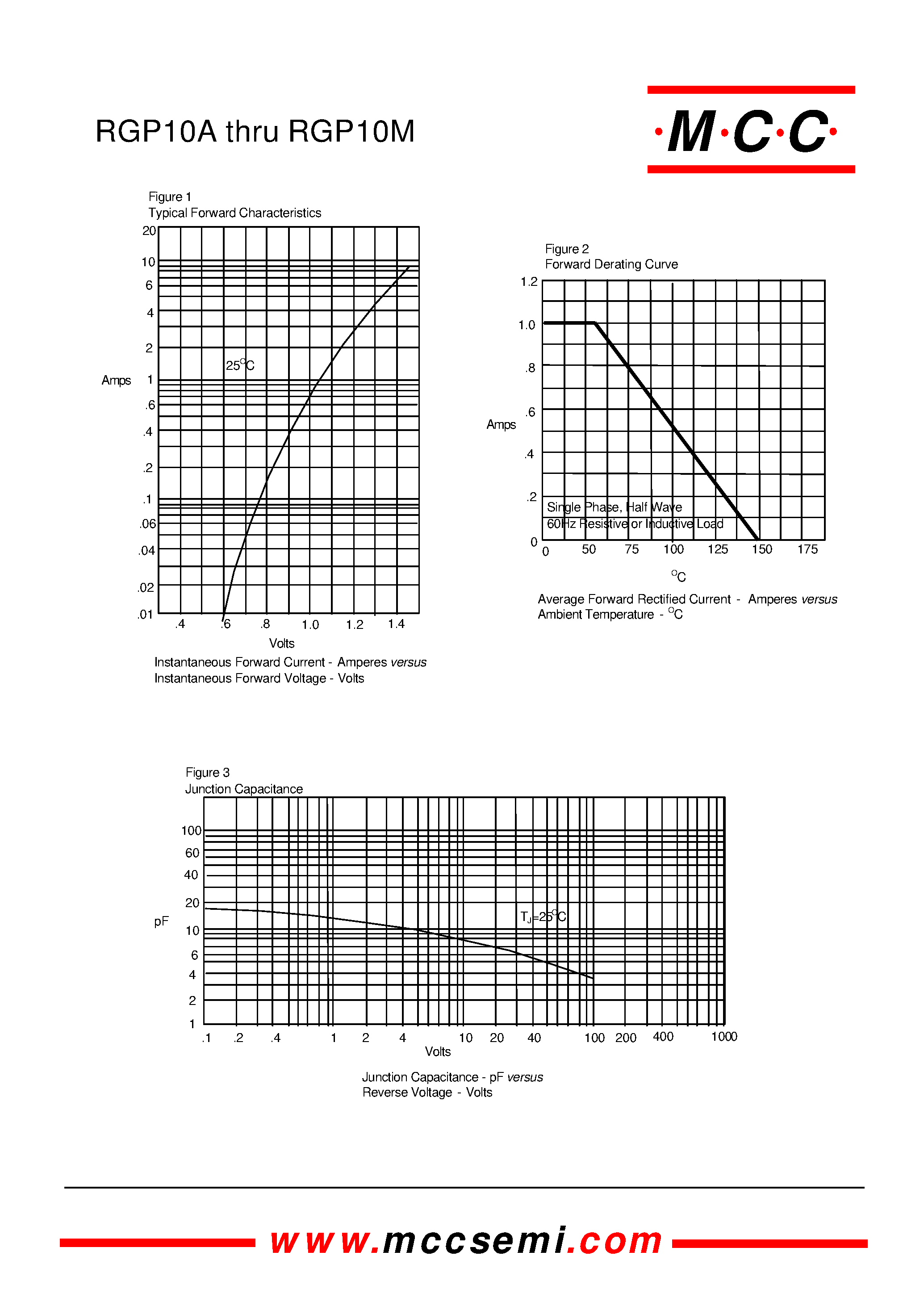

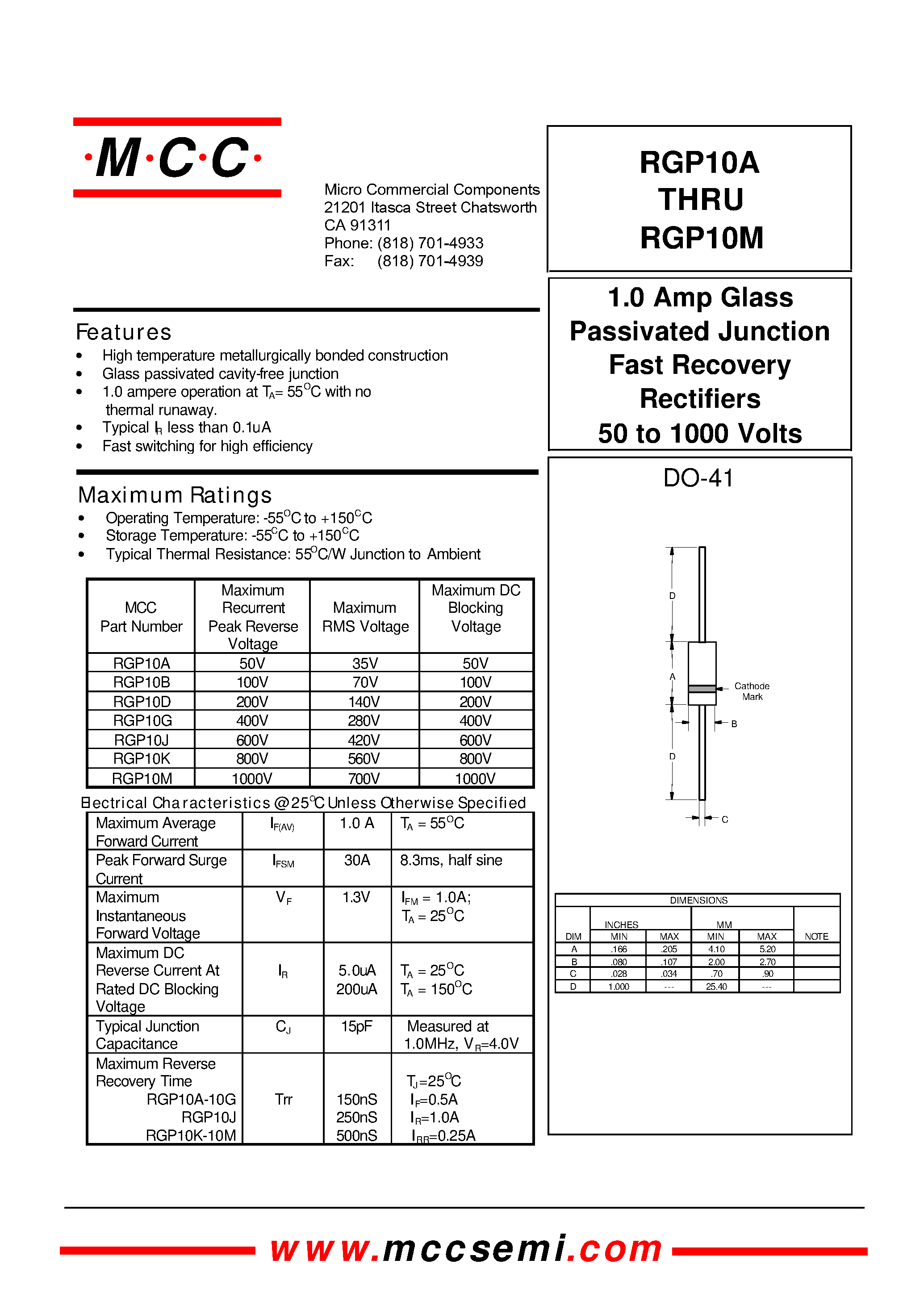

RGP10A-1.0 Amp Glass Passivated Junction Fast Recovery Rectifiers 50 to 1000 Volts
Description:1.0 Amp Glass Passivated Junction Fast Recovery Rectifiers 50 to 1000 Volts
Others with the same file: RGP10A
Datasheet RGP10A - 1.0 Amp Glass Passivated Junction Fast Recovery Rectifiers 50 to 1000 Volts page 1
Datasheet RGP10A - 1.0 Amp Glass Passivated Junction Fast Recovery Rectifiers 50 to 1000 Volts page 2
