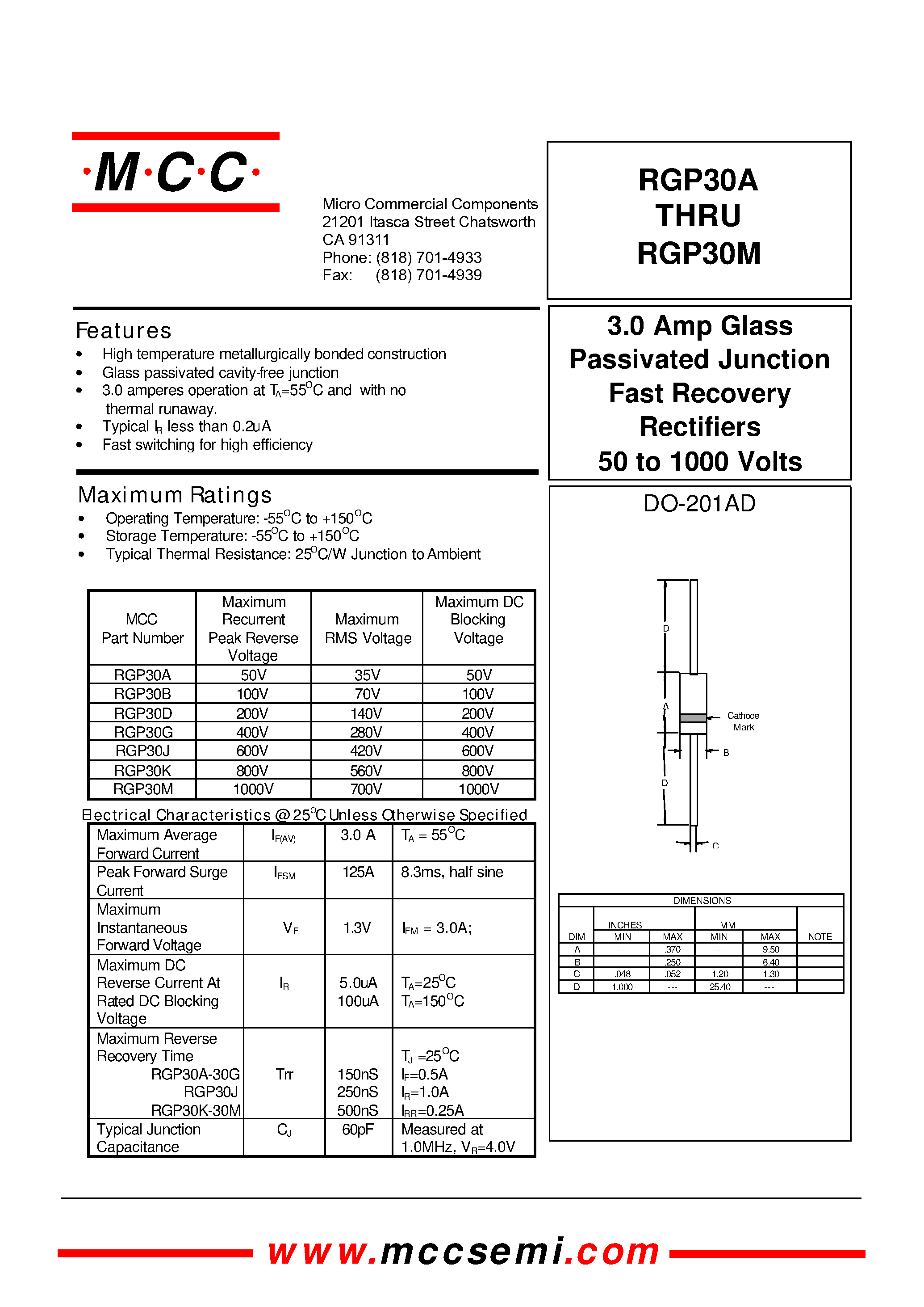

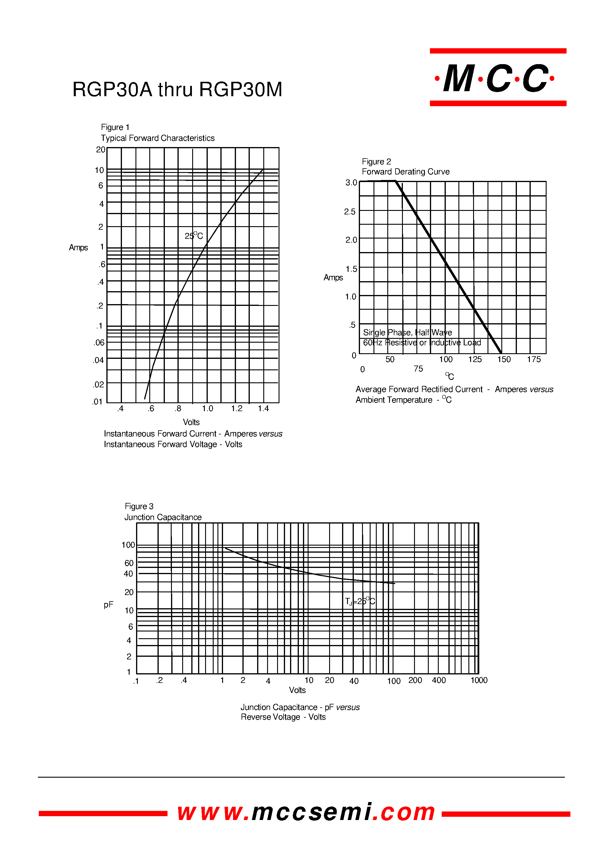

RGP30-3.0 Amp Glass Passivated Junction Fast Recovery Rectifiers 50 to 1000 Volts
Description:3.0 Amp Glass Passivated Junction Fast Recovery Rectifiers 50 to 1000 Volts
