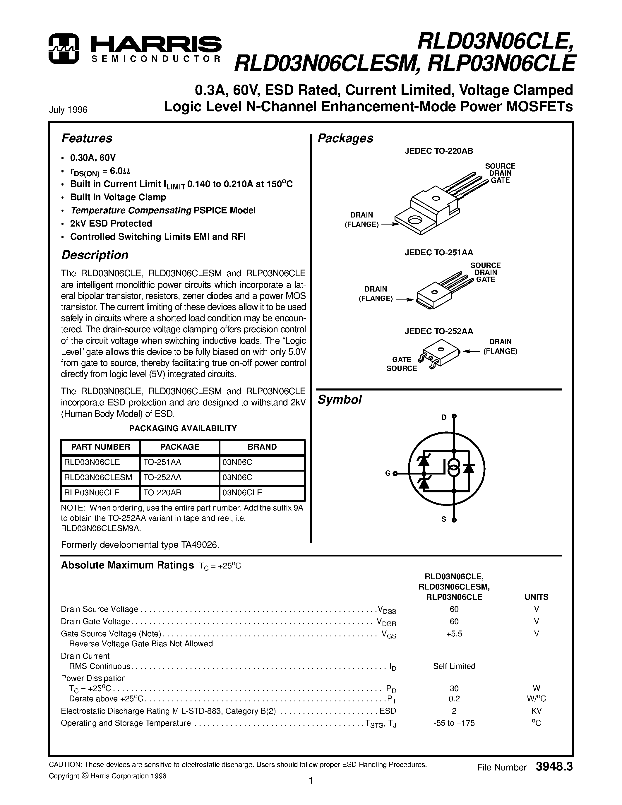

RLP03N06CLE-0.3A/ 60V/ ESD Rated/ Current Limited/ Voltage Clamped Logic Level N-Channel Enhancement-Mode Power MOSFETs
Description:0.3A/ 60V/ ESD Rated/ Current Limited/ Voltage Clamped Logic Level N-Channel Enhancement-Mode Power MOSFETs
Others with the same file: RLP03N06CLE

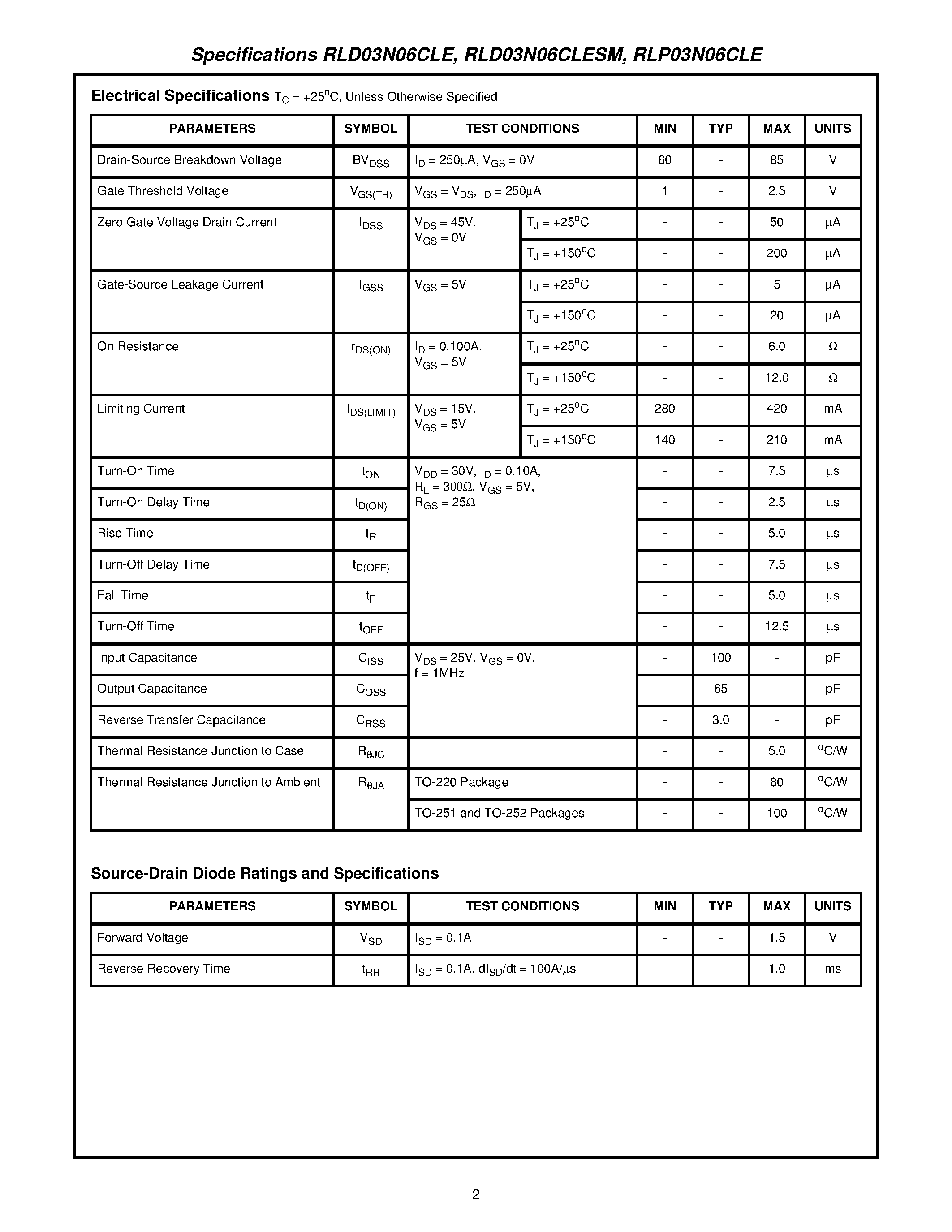

Datasheet RLP03N06CLE - 0.3A/ 60V/ ESD Rated/ Current Limited/ Voltage Clamped Logic Level N-Channel Enhancement-Mode Power MOSFETs page 1
Datasheet RLP03N06CLE - 0.3A/ 60V/ ESD Rated/ Current Limited/ Voltage Clamped Logic Level N-Channel Enhancement-Mode Power MOSFETs page 2
