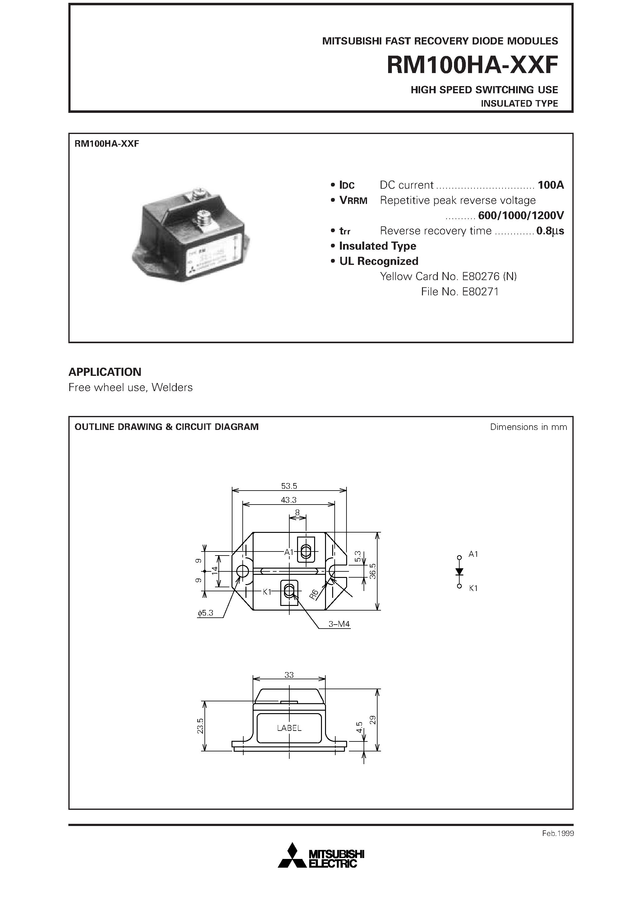

RM100HA-XXF-HIGH SPEED SWITCHING USE INSULATED TYPE
Producer:Mitsubishi Electric Semiconductor
Description:HIGH SPEED SWITCHING USE INSULATED TYPE
Others with the same file: RM100HA-XXF
