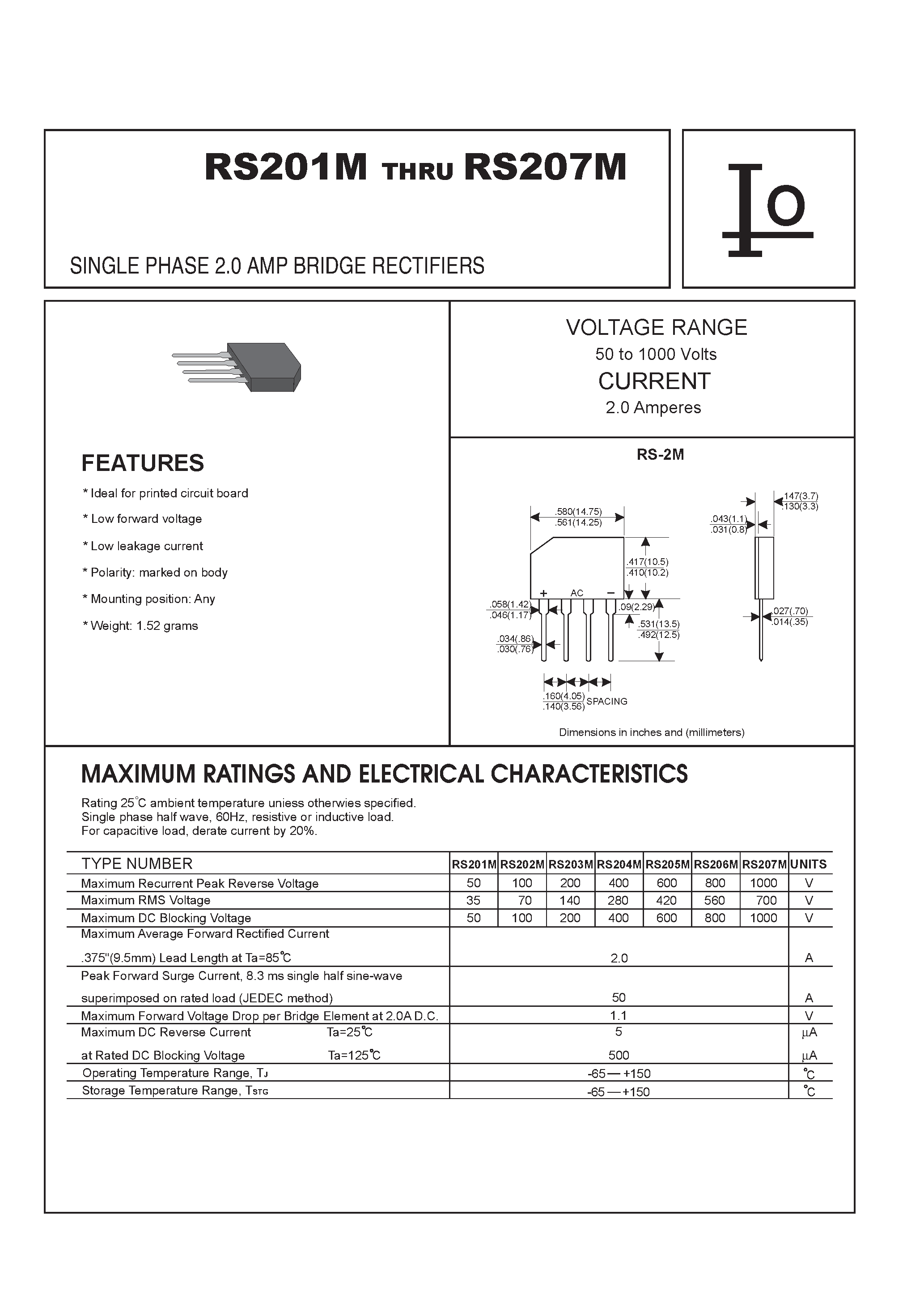

RS201M-SINGLE PHASE 2.0 AMP BRIDGE RECTIFIERS
Producer:Bytes
Description:SINGLE PHASE 2.0 AMP BRIDGE RECTIFIERS
Others with the same file: RS201M
Datasheet RS201M - SINGLE PHASE 2.0 AMP BRIDGE RECTIFIERS page 1
Datasheet RS201M - SINGLE PHASE 2.0 AMP BRIDGE RECTIFIERS page 2
