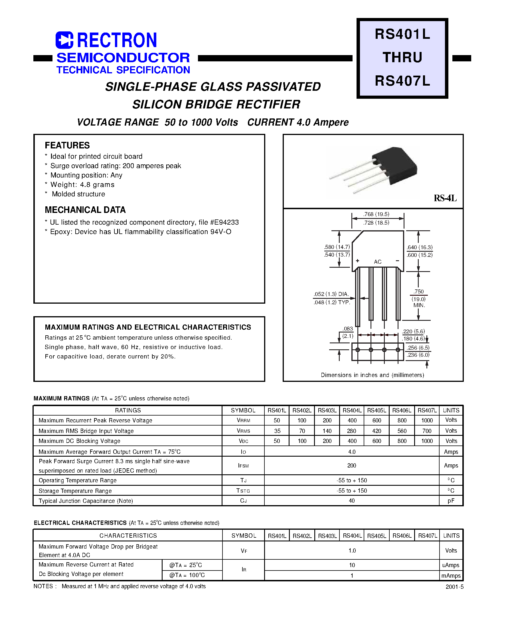

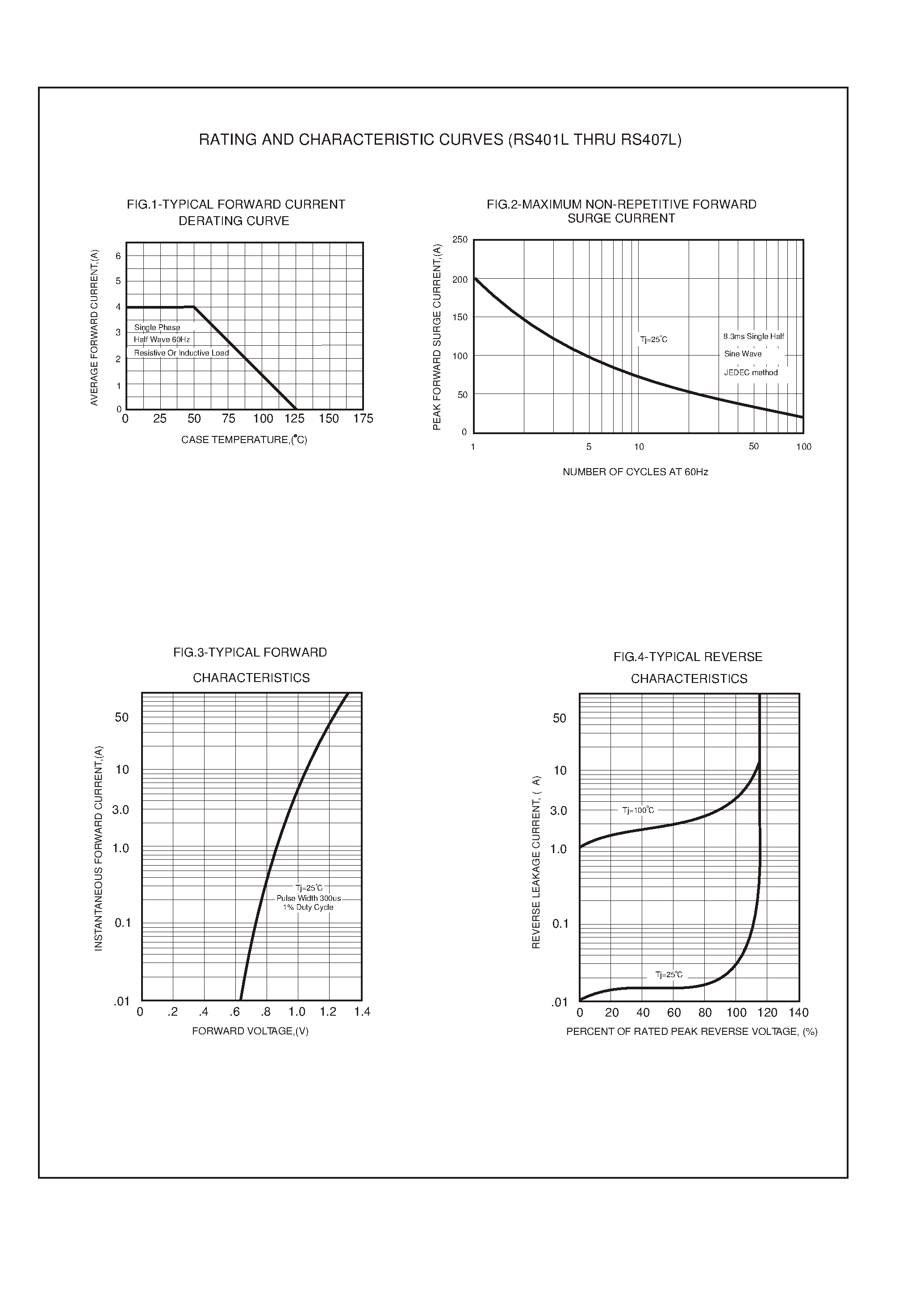

RS401L-SINGLE-PHASE GLASS PASSIVATED SILICON BRIDGE RECTIFIER (VOLTAGE RANGE 50 to 1000 Volts CURRENT 4.0 Ampere)
Description:SINGLE-PHASE GLASS PASSIVATED SILICON BRIDGE RECTIFIER (VOLTAGE RANGE 50 to 1000 Volts CURRENT 4.0 Ampere)
Others with the same file: RS401L
Datasheet RS401L - SINGLE-PHASE GLASS PASSIVATED SILICON BRIDGE RECTIFIER (VOLTAGE RANGE 50 to 1000 Volts CURRENT 4.0 Ampere) page 1
