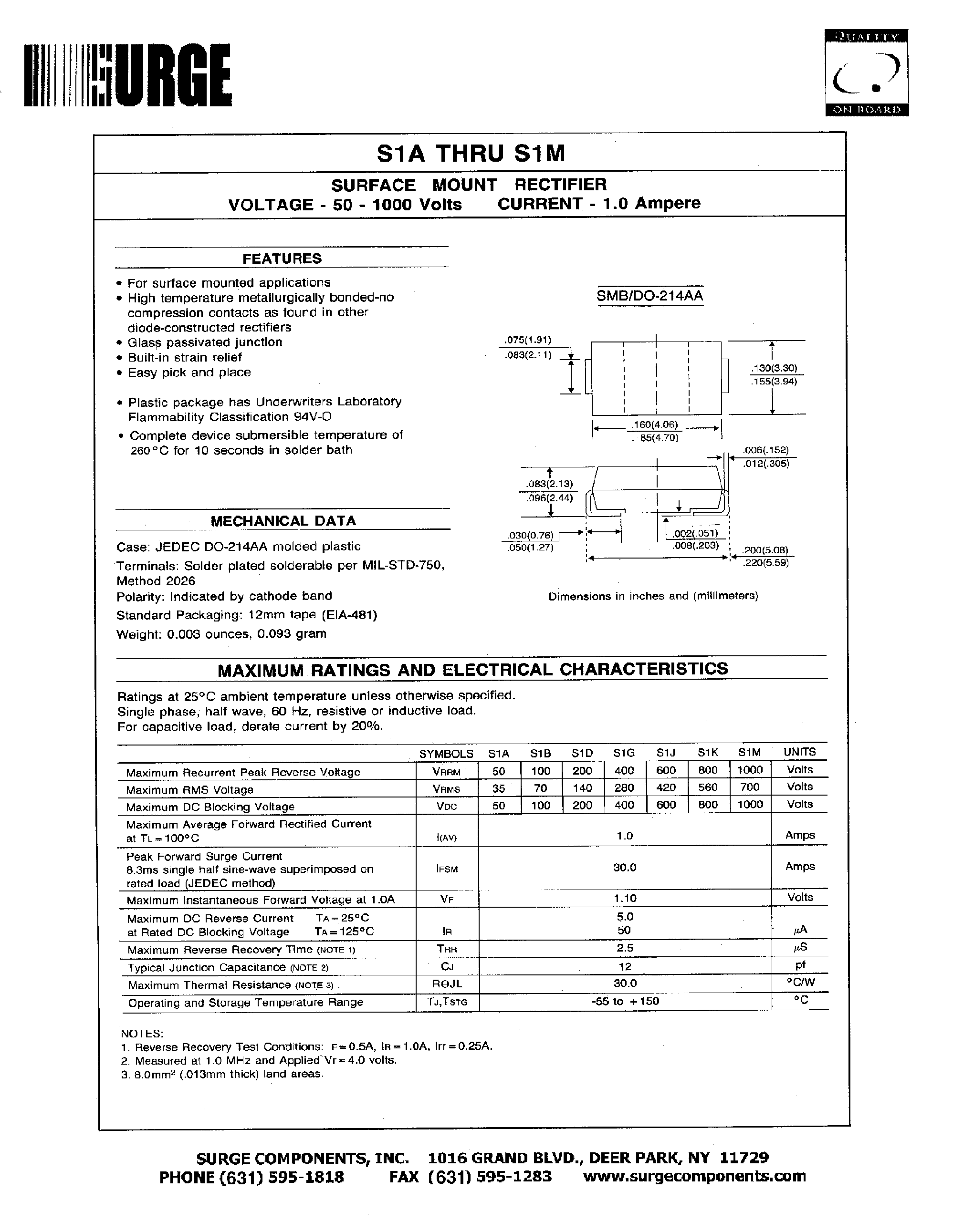

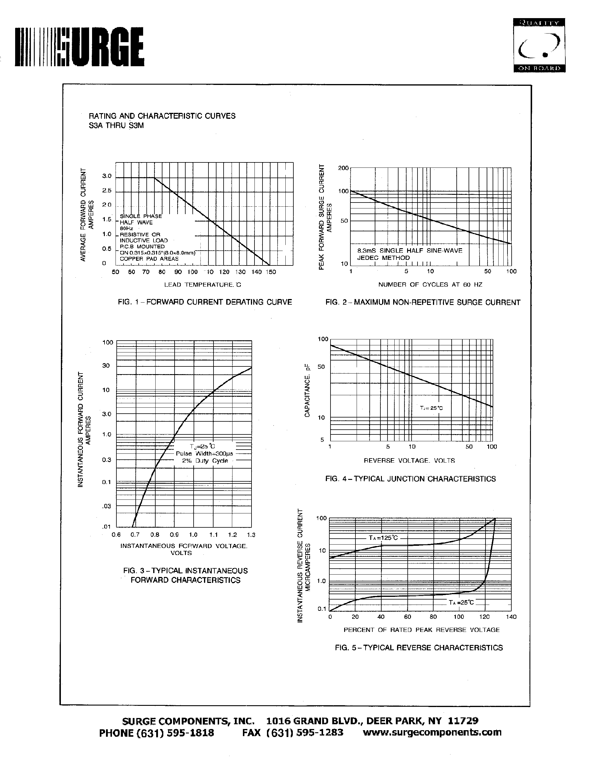

S1B-SURFACE MOUNT RECTIFIER VOLTAGE - 50 TO 1000 Volts CURRENT - 1.0 Ampere
Producer:Surge Components
Description:SURFACE MOUNT RECTIFIER VOLTAGE - 50 TO 1000 Volts CURRENT - 1.0 Ampere
Others with the same file: S1B
Datasheet S1B - SURFACE MOUNT RECTIFIER VOLTAGE - 50 TO 1000 Volts CURRENT - 1.0 Ampere page 1
Datasheet S1B - SURFACE MOUNT RECTIFIER VOLTAGE - 50 TO 1000 Volts CURRENT - 1.0 Ampere page 2
