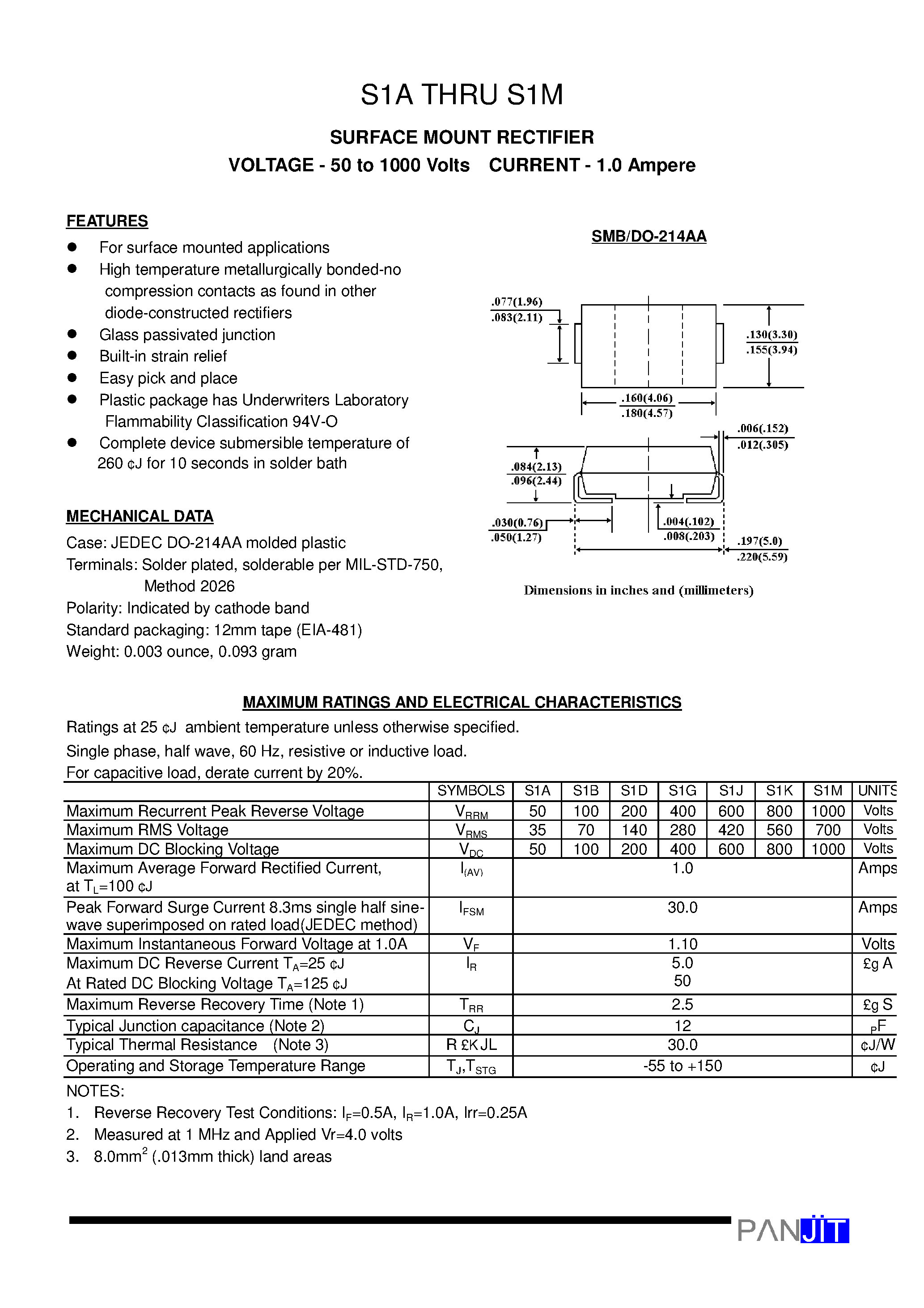

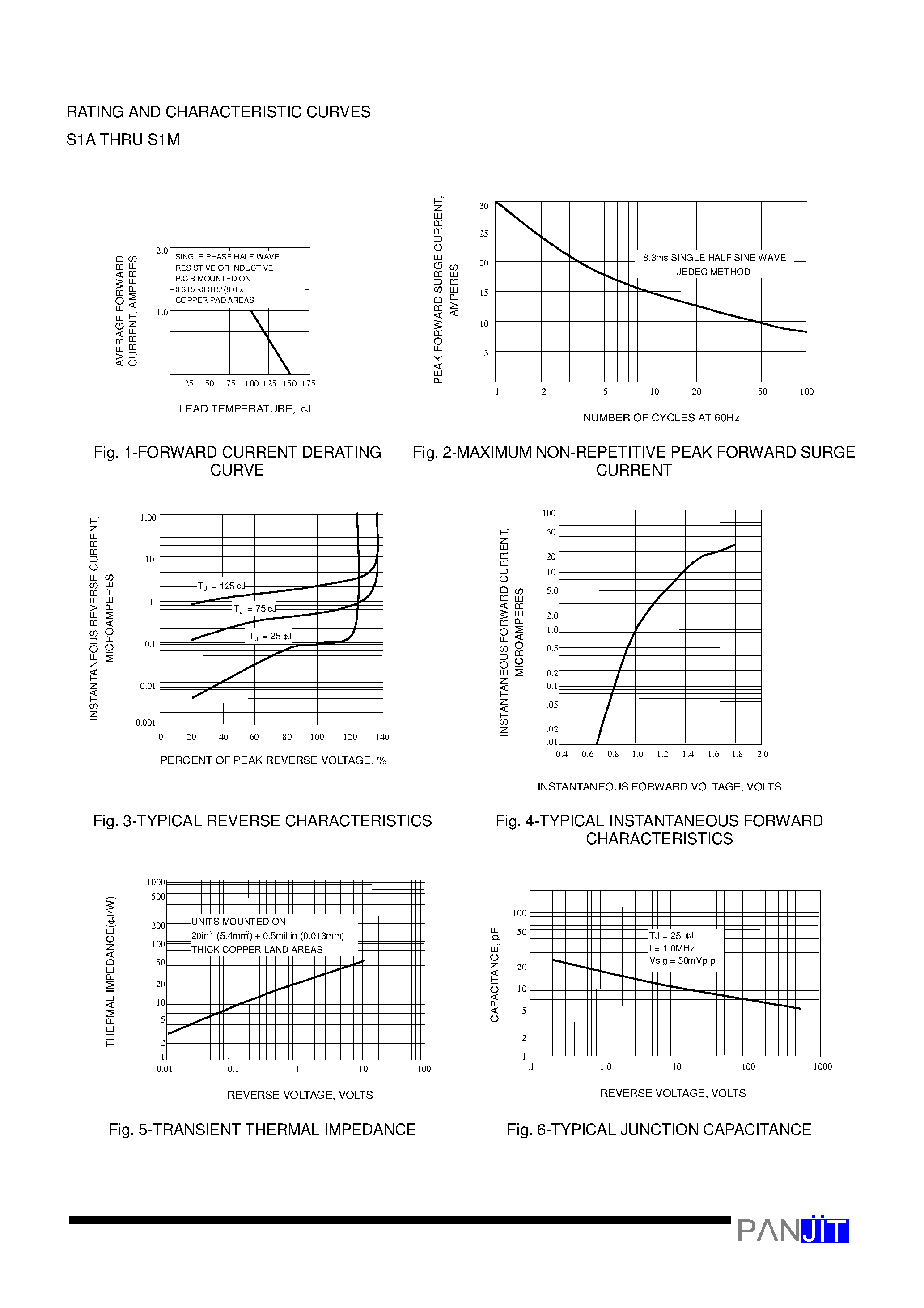

S1J-SURFACE MOUNT RECTIFIER(VOLTAGE - 50 to 1000 Volts CURRENT - 1.0 Ampere)
Producer:Pan Jit International.
Description:SURFACE MOUNT RECTIFIER(VOLTAGE - 50 to 1000 Volts CURRENT - 1.0 Ampere)
Others with the same file: S1J
Datasheet S1J - SURFACE MOUNT RECTIFIER(VOLTAGE - 50 to 1000 Volts CURRENT - 1.0 Ampere) page 1
Datasheet S1J - SURFACE MOUNT RECTIFIER(VOLTAGE - 50 to 1000 Volts CURRENT - 1.0 Ampere) page 2
