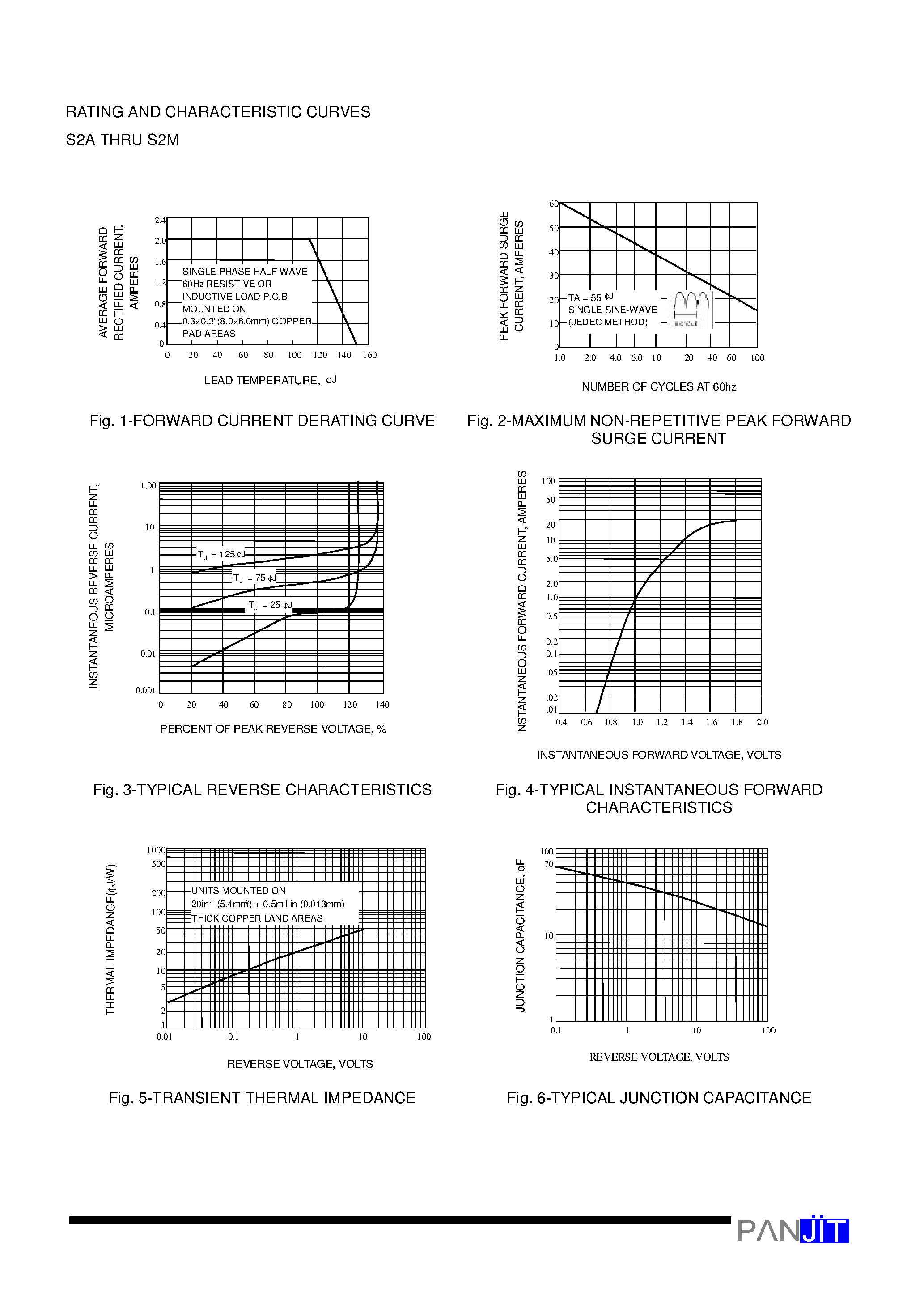

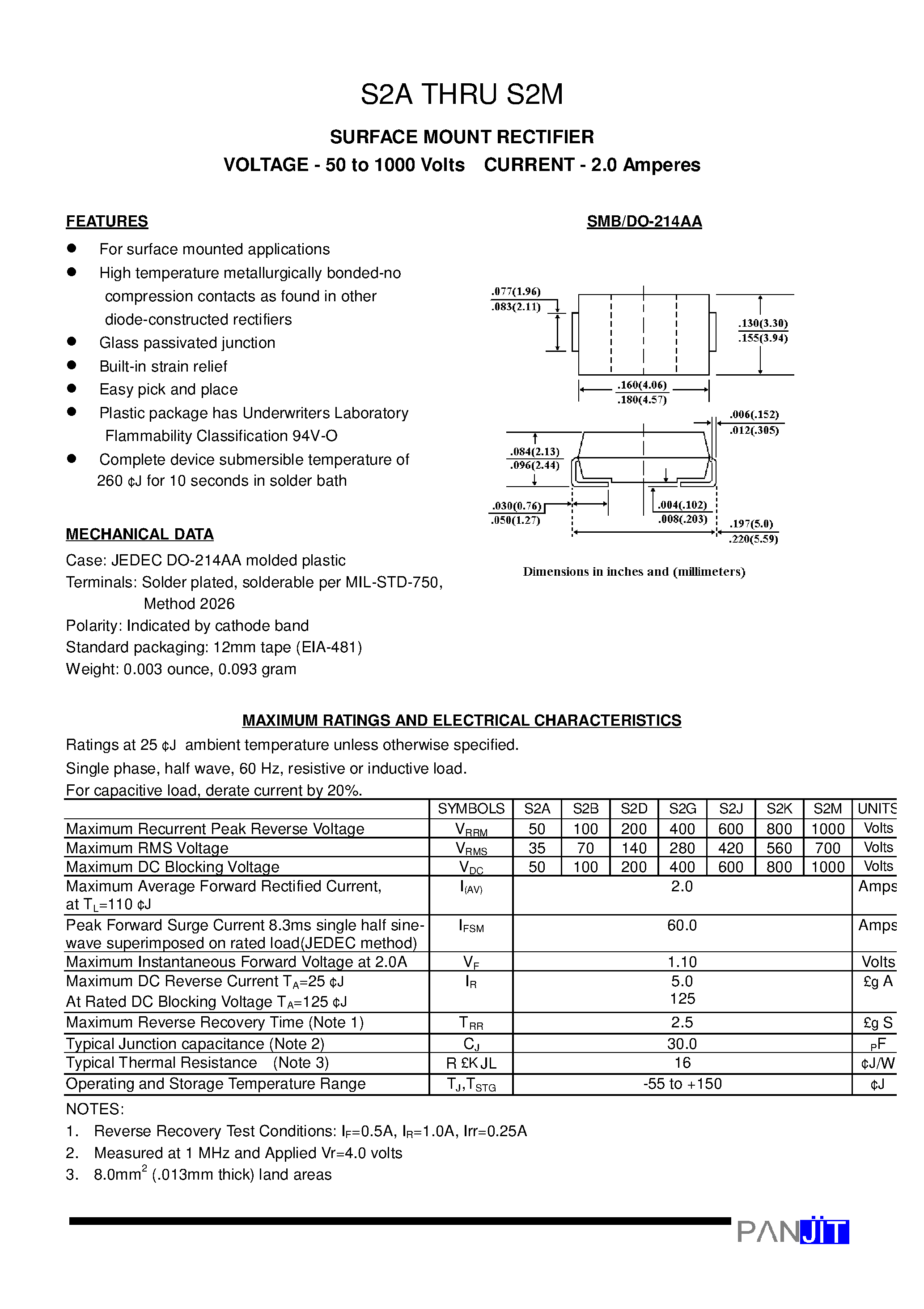

S2K-SURFACE MOUNT RECTIFIER(VOLTAGE - 50 to 1000 Volts CURRENT - 2.0 Amperes)
Producer:Pan Jit International Inc.
Description:SURFACE MOUNT RECTIFIER(VOLTAGE - 50 to 1000 Volts CURRENT - 2.0 Amperes)
Others with the same file: S2K
Datasheet S2K - SURFACE MOUNT RECTIFIER(VOLTAGE - 50 to 1000 Volts CURRENT - 2.0 Amperes) page 1
Datasheet S2K - SURFACE MOUNT RECTIFIER(VOLTAGE - 50 to 1000 Volts CURRENT - 2.0 Amperes) page 2
