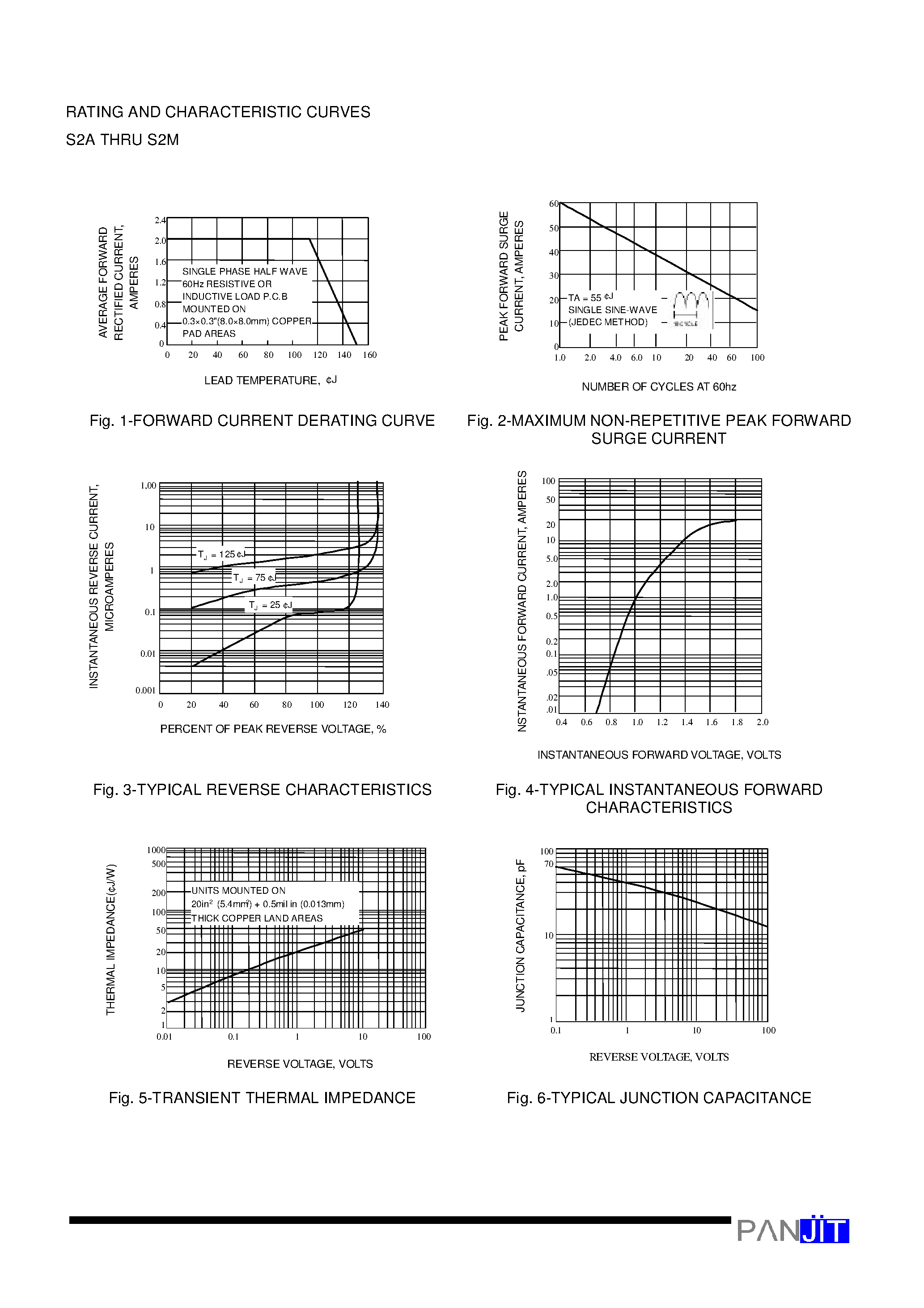

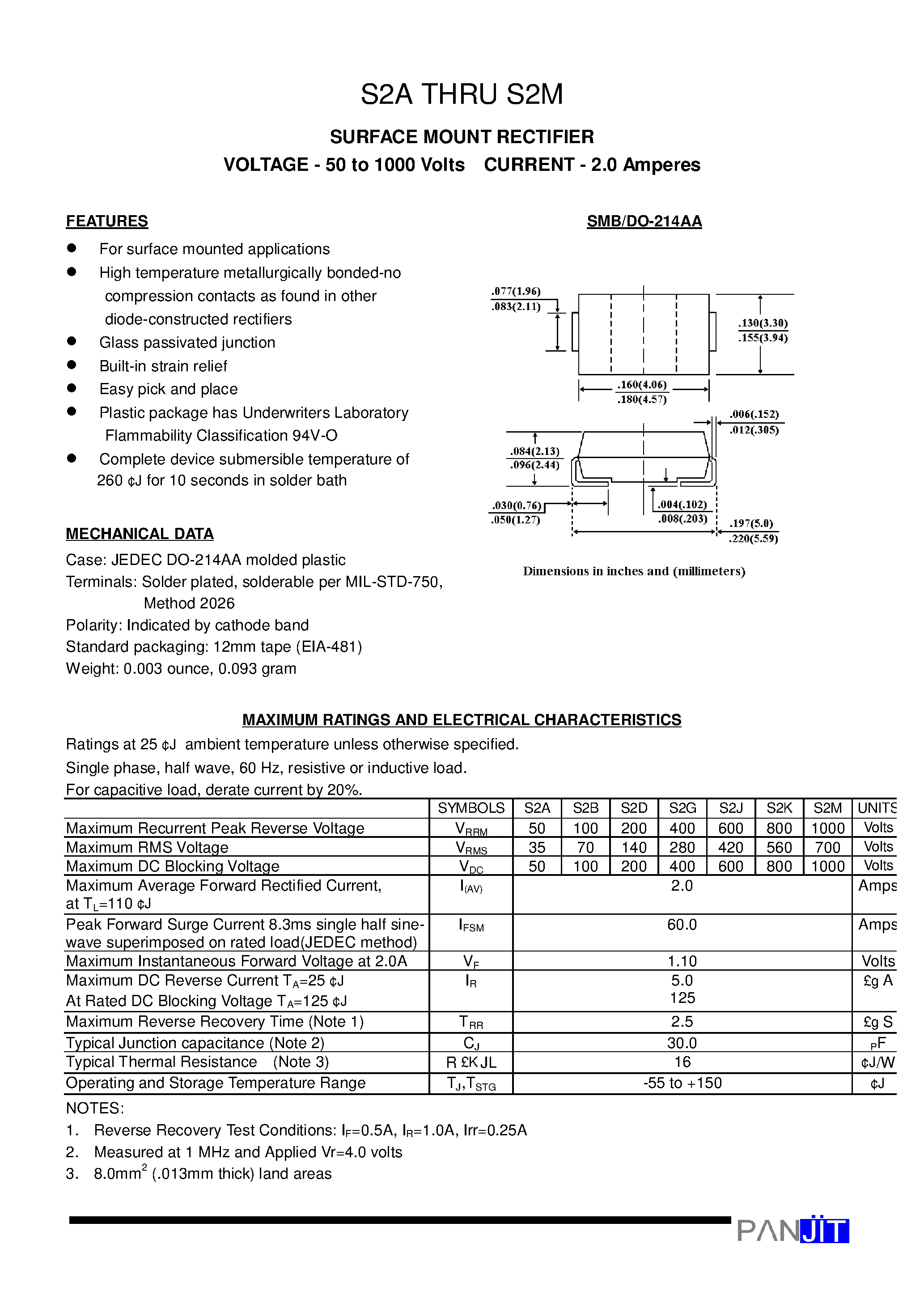

S2M-SURFACE MOUNT RECTIFIER(VOLTAGE - 50 to 1000 Volts CURRENT - 2.0 Amperes)
Producer:Pan Jit International Inc.
Description:SURFACE MOUNT RECTIFIER(VOLTAGE - 50 to 1000 Volts CURRENT - 2.0 Amperes)
Others with the same file: S2M
Datasheet S2M - SURFACE MOUNT RECTIFIER(VOLTAGE - 50 to 1000 Volts CURRENT - 2.0 Amperes) page 1
Datasheet S2M - SURFACE MOUNT RECTIFIER(VOLTAGE - 50 to 1000 Volts CURRENT - 2.0 Amperes) page 2
