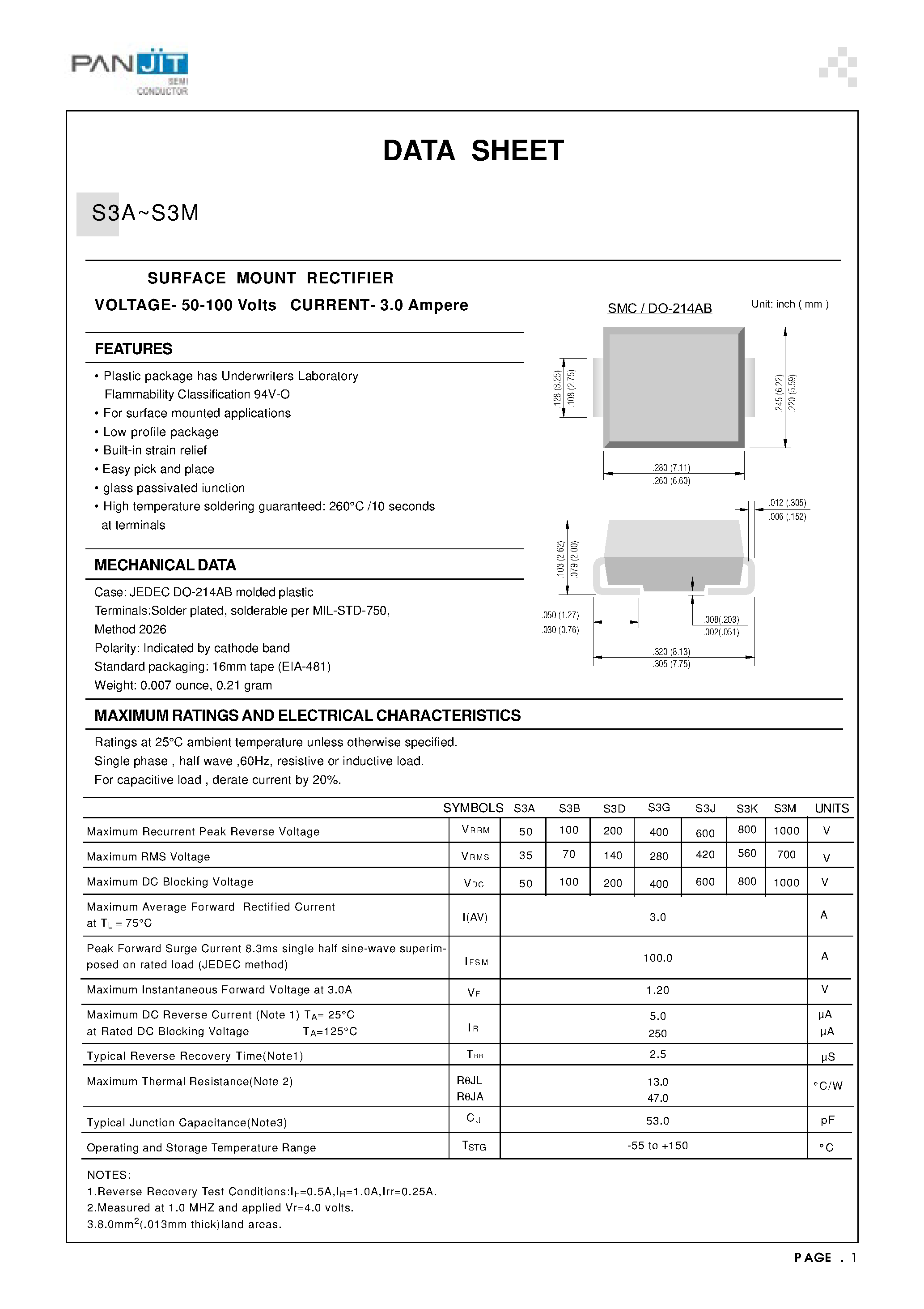

S3A-SURFACE MOUNT RECTIFIER(VOLTAGE- 50-100 Volts CURRENT- 3.0 Ampere)
Producer:Pan Jit International Inc.
Description:SURFACE MOUNT RECTIFIER(VOLTAGE- 50-100 Volts CURRENT- 3.0 Ampere)
Others with the same file: S3A
Datasheet S3A - SURFACE MOUNT RECTIFIER(VOLTAGE- 50-100 Volts CURRENT- 3.0 Ampere) page 1

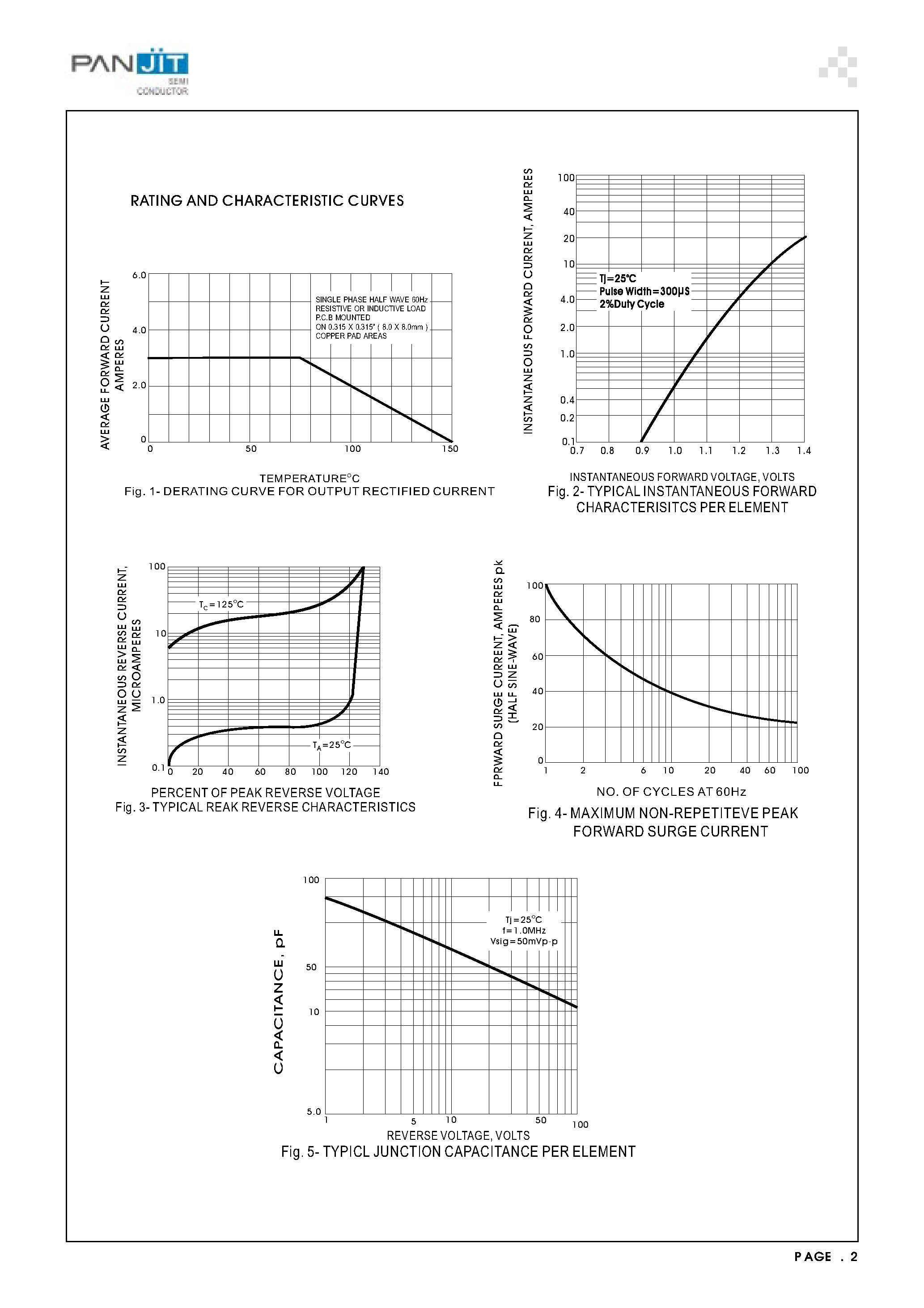

Datasheet S3A - SURFACE MOUNT RECTIFIER(VOLTAGE- 50-100 Volts CURRENT- 3.0 Ampere) page 2
