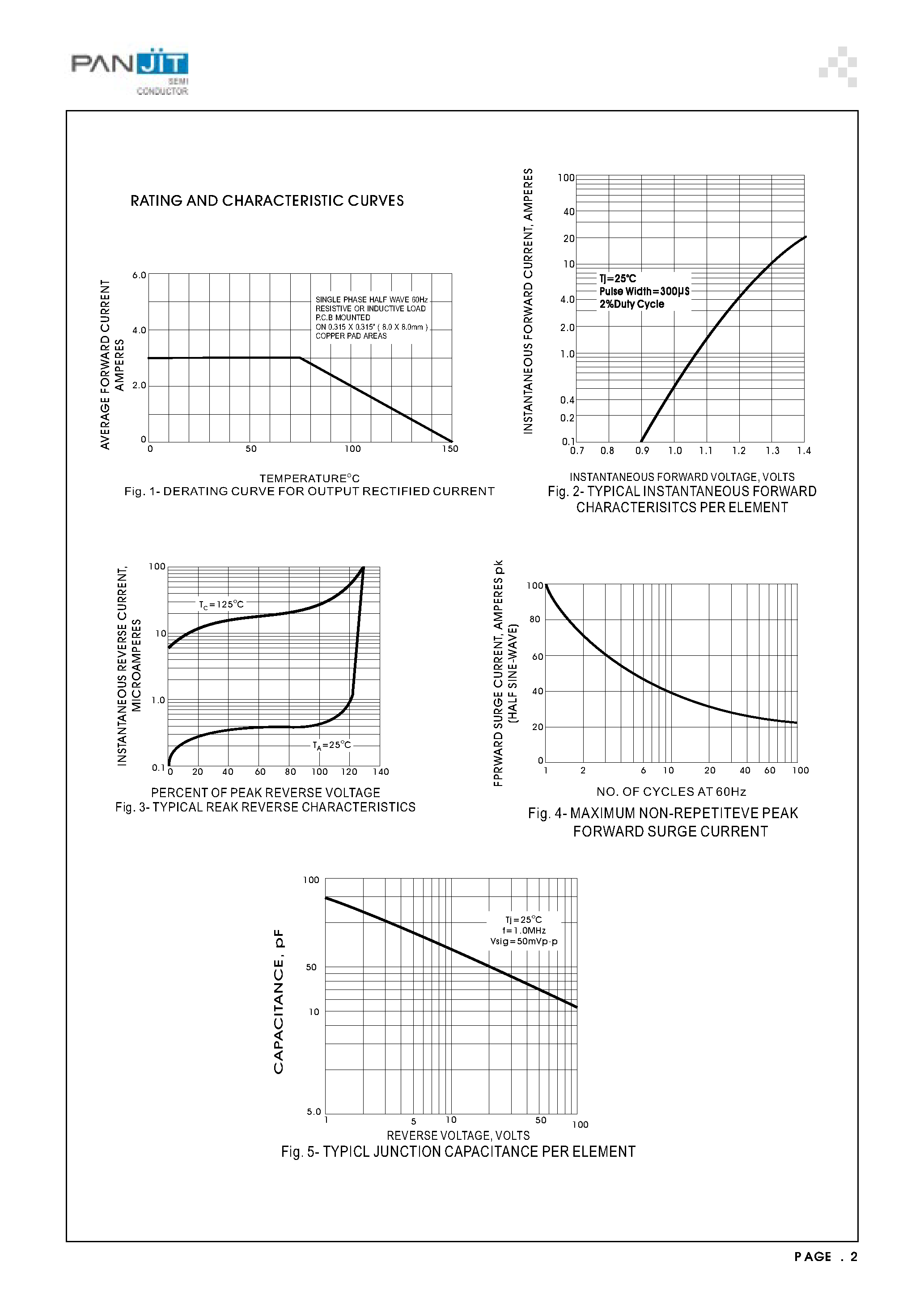

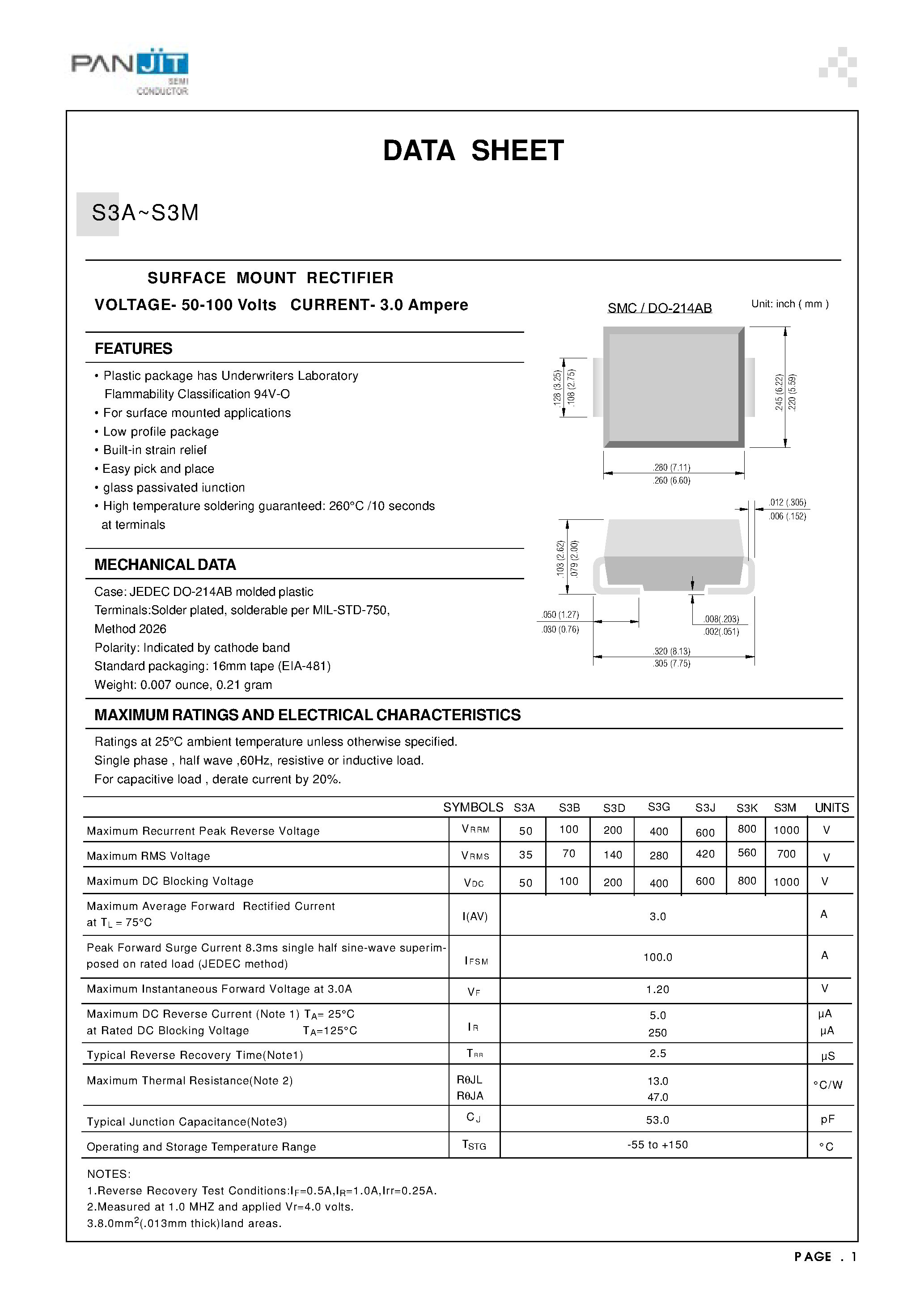

S3D-SURFACE MOUNT RECTIFIER(VOLTAGE- 50-100 Volts CURRENT- 3.0 Ampere)
Producer:Pan Jit International Inc.
Description:SURFACE MOUNT RECTIFIER(VOLTAGE- 50-100 Volts CURRENT- 3.0 Ampere)
Others with the same file: S3D
Datasheet S3D - SURFACE MOUNT RECTIFIER(VOLTAGE- 50-100 Volts CURRENT- 3.0 Ampere) page 1
Datasheet S3D - SURFACE MOUNT RECTIFIER(VOLTAGE- 50-100 Volts CURRENT- 3.0 Ampere) page 2
