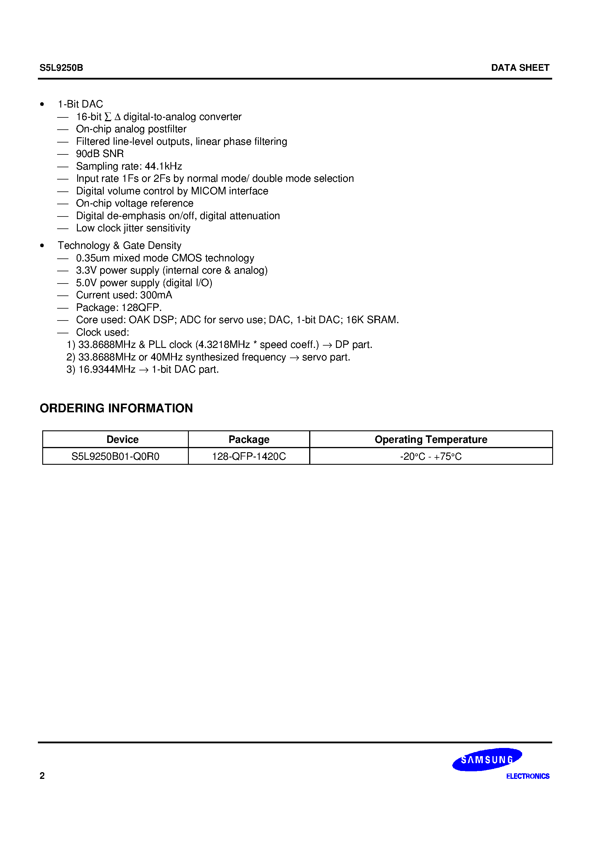

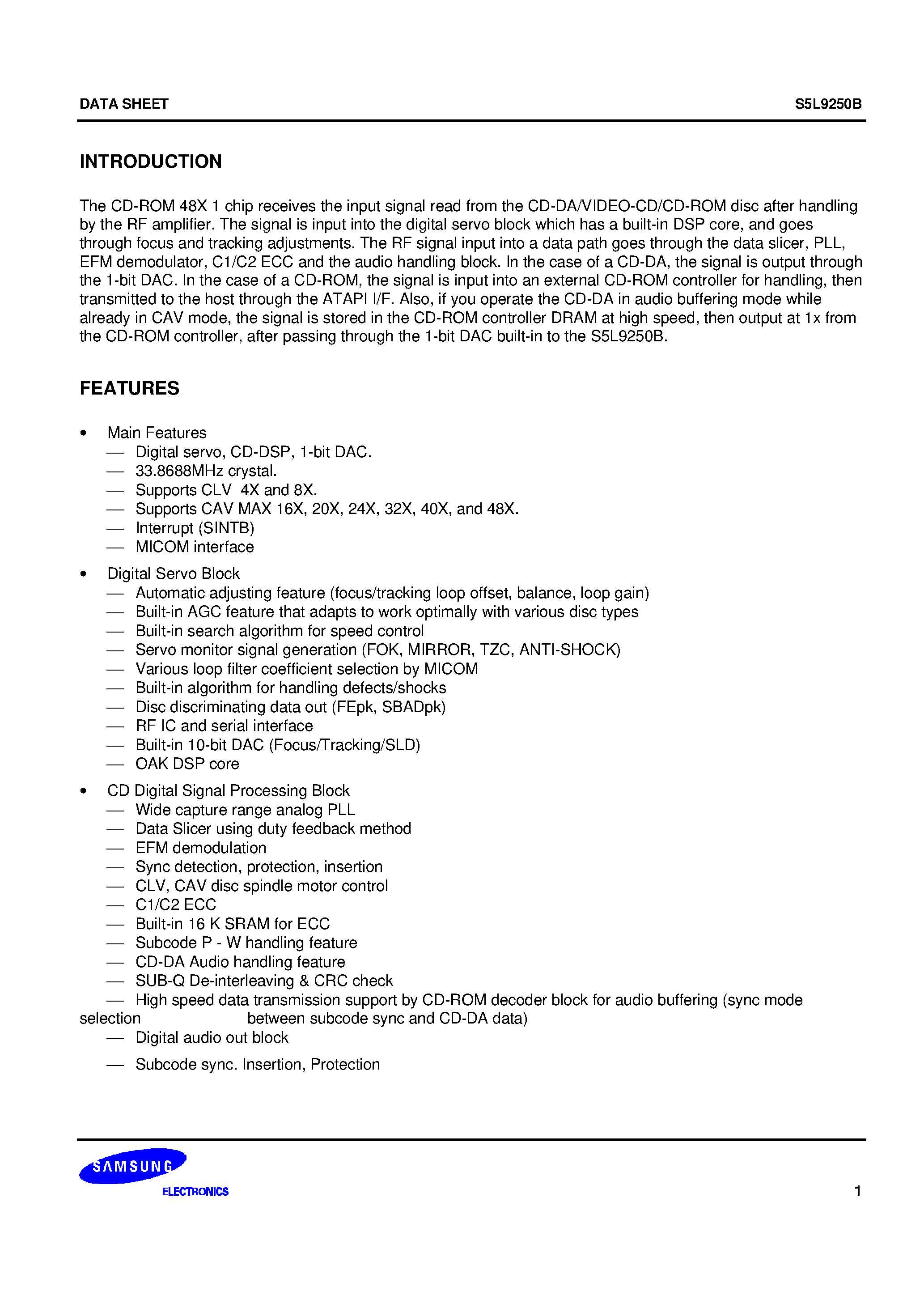

S5L9250B01-Q0R0-The CD-ROM 48X 1 chip receives the input signal read from the CD-DA/VIDEO-CD/CD-ROM disc after handling by the RF amplifier.
Producer:Samsung semiconductor
Description:The CD-ROM 48X 1 chip receives the input signal read from the CD-DA/VIDEO-CD/CD-ROM disc after handling by the RF amplifier.
