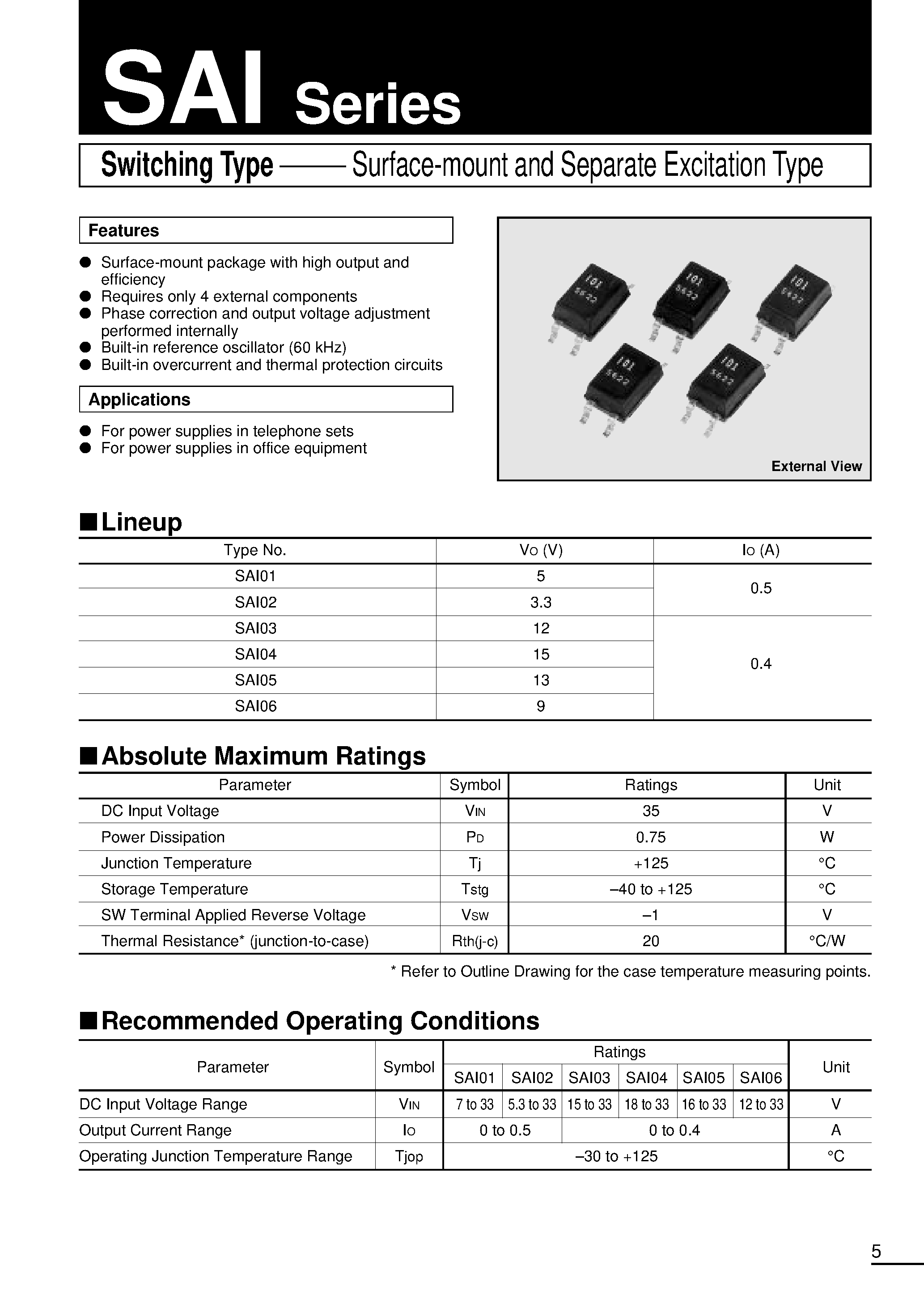

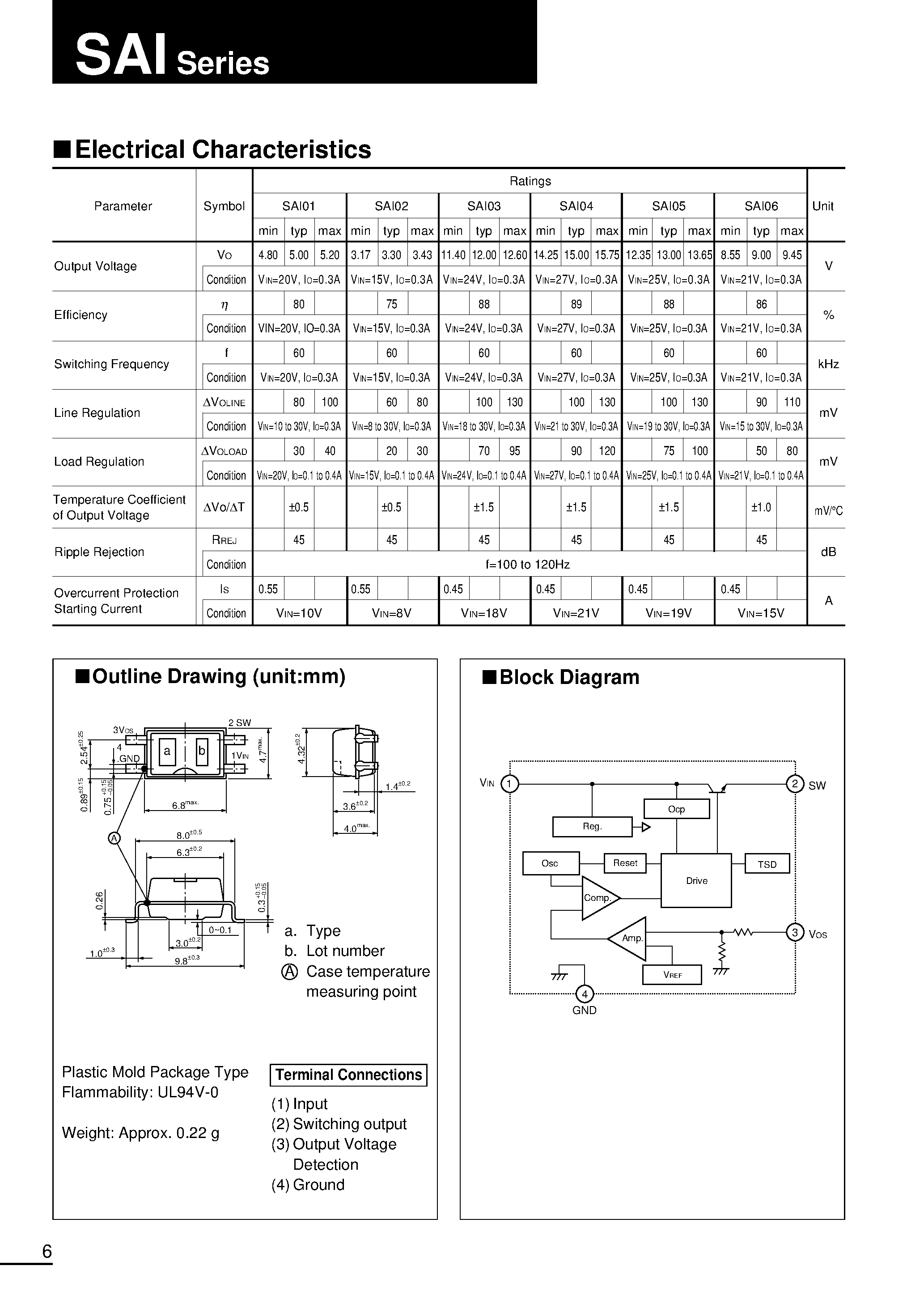

SAI01-1-Surface-mount and Separate Excitation Type
Producer:Sanken electric
Description:Surface-mount and Separate Excitation Type
Others with the same file: SAI01-1
Datasheet SAI01-1 - Surface-mount and Separate Excitation Type page 1
Datasheet SAI01-1 - Surface-mount and Separate Excitation Type page 2
