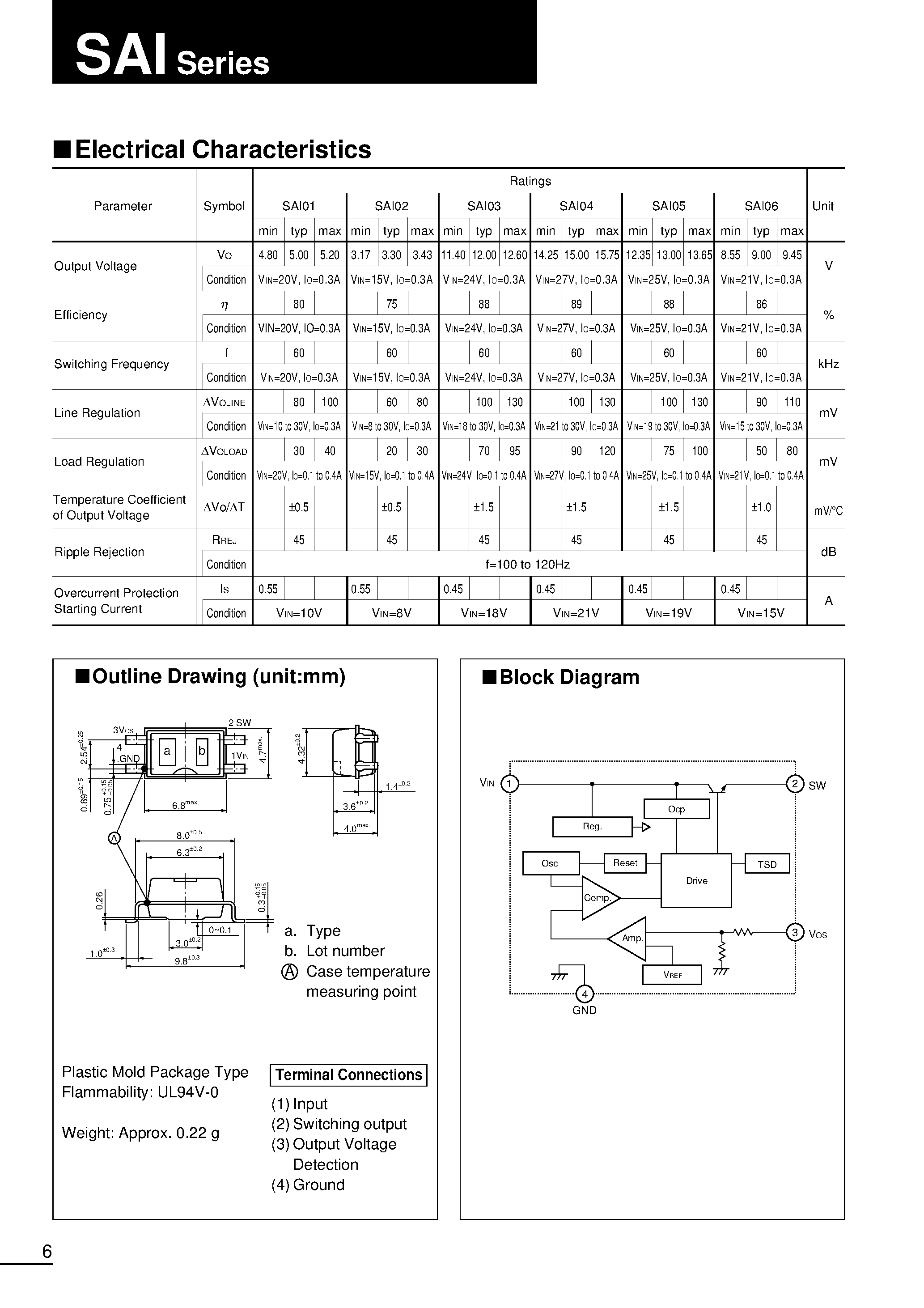

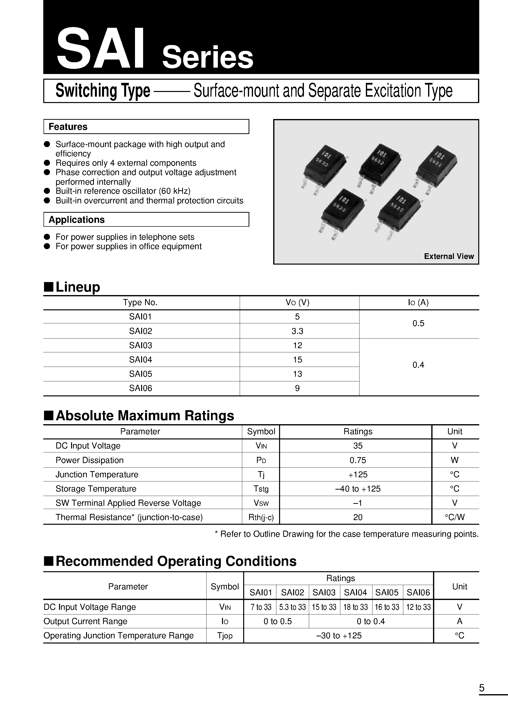

SAI02-Surface-Mount/ Separate Excitation Switching Type
Producer:Sanken electric
Description:Surface-Mount/ Separate Excitation Switching Type
Others with the same file: SAI02
Datasheet SAI02 - Surface-Mount/ Separate Excitation Switching Type page 1
Datasheet SAI02 - Surface-Mount/ Separate Excitation Switching Type page 2
