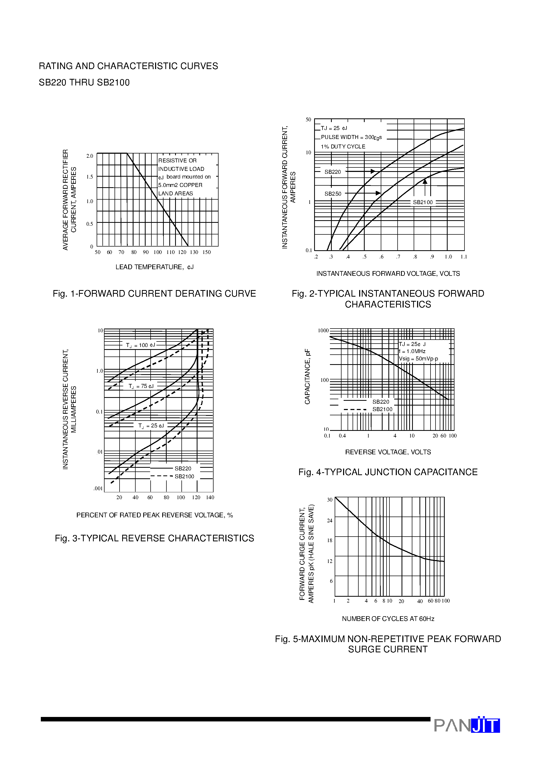

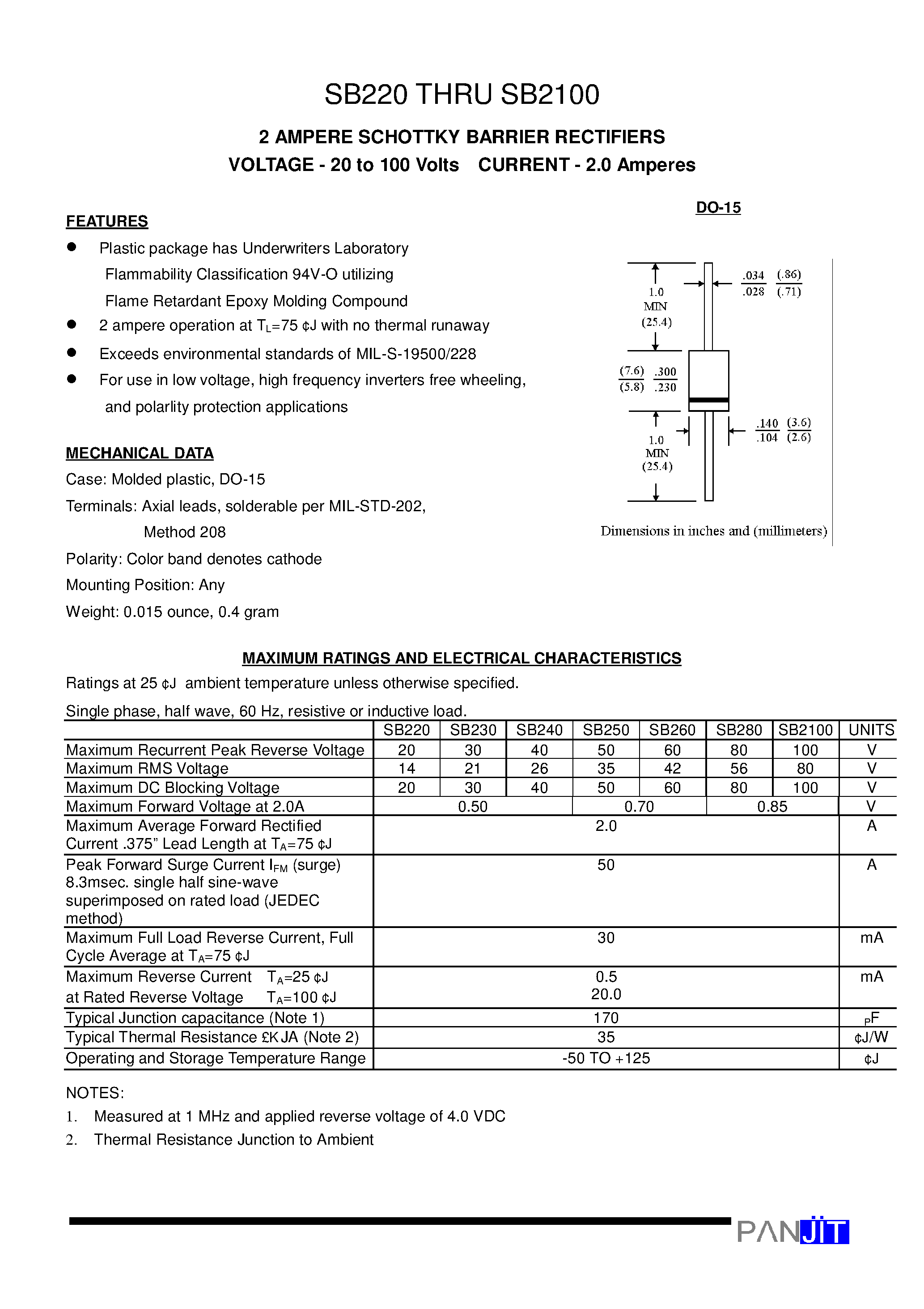

SB2100-2 AMPERE SCHOTTKY BARRIER RECTIFIERS(VOLTAGE - 20 to 100 Volts CURRENT - 2.0 Amperes)
Producer:Pan Jit International Inc.
Description:2 AMPERE SCHOTTKY BARRIER RECTIFIERS(VOLTAGE - 20 to 100 Volts CURRENT - 2.0 Amperes)
Others with the same file: SB2100
Datasheet SB2100 - 2 AMPERE SCHOTTKY BARRIER RECTIFIERS(VOLTAGE - 20 to 100 Volts CURRENT - 2.0 Amperes) page 1
Datasheet SB2100 - 2 AMPERE SCHOTTKY BARRIER RECTIFIERS(VOLTAGE - 20 to 100 Volts CURRENT - 2.0 Amperes) page 2
