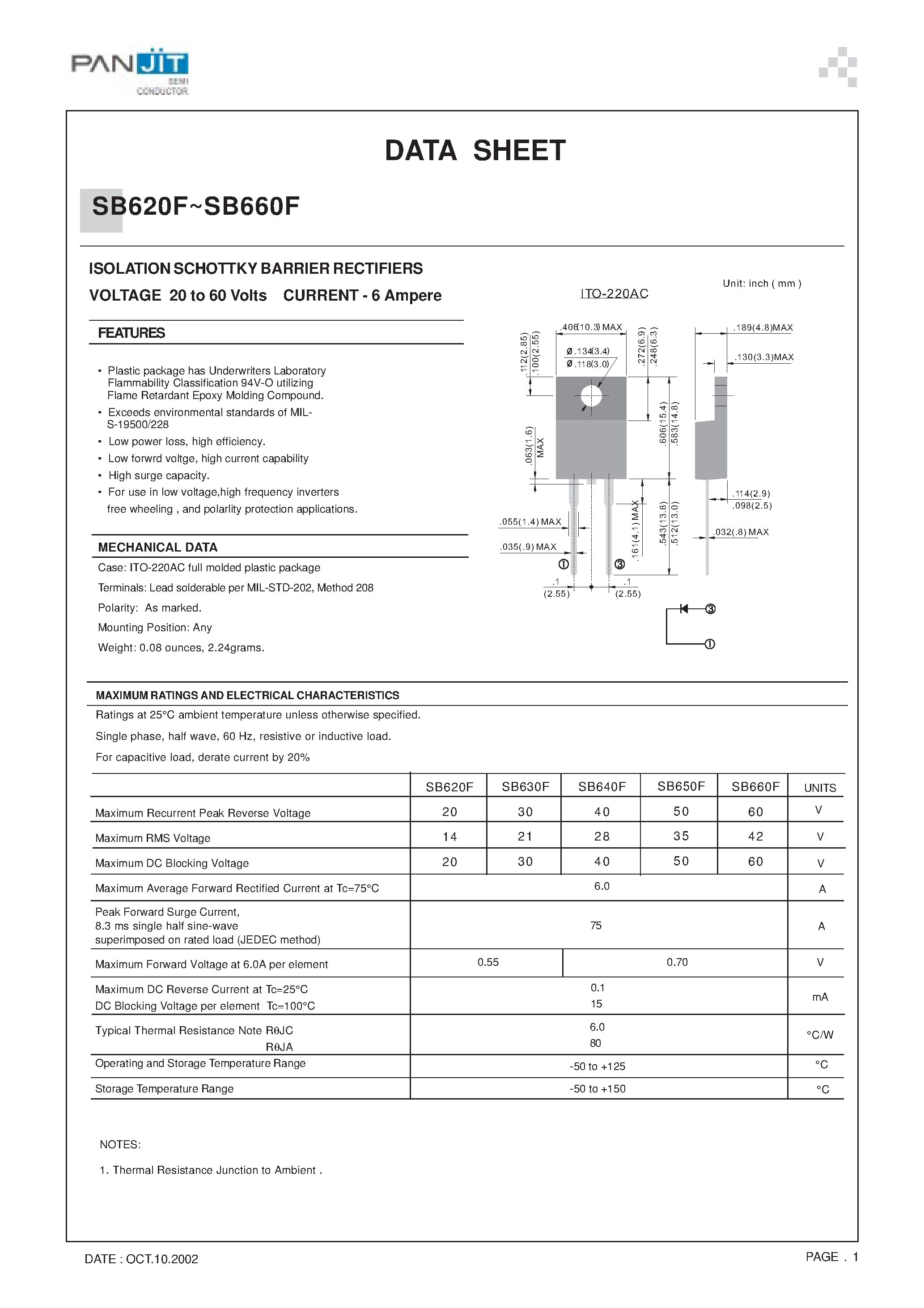

SB620F-ISOLATION SCHOTTKY BARRIER RECTIFIERS(VOLTAGE 20 to 60 Volts CURRENT - 6 Ampere)
Producer:Pan Jit International Inc.
Description:ISOLATION SCHOTTKY BARRIER RECTIFIERS(VOLTAGE 20 to 60 Volts CURRENT - 6 Ampere)
Others with the same file: SB620F
Datasheet SB620F - ISOLATION SCHOTTKY BARRIER RECTIFIERS(VOLTAGE 20 to 60 Volts CURRENT - 6 Ampere) page 1

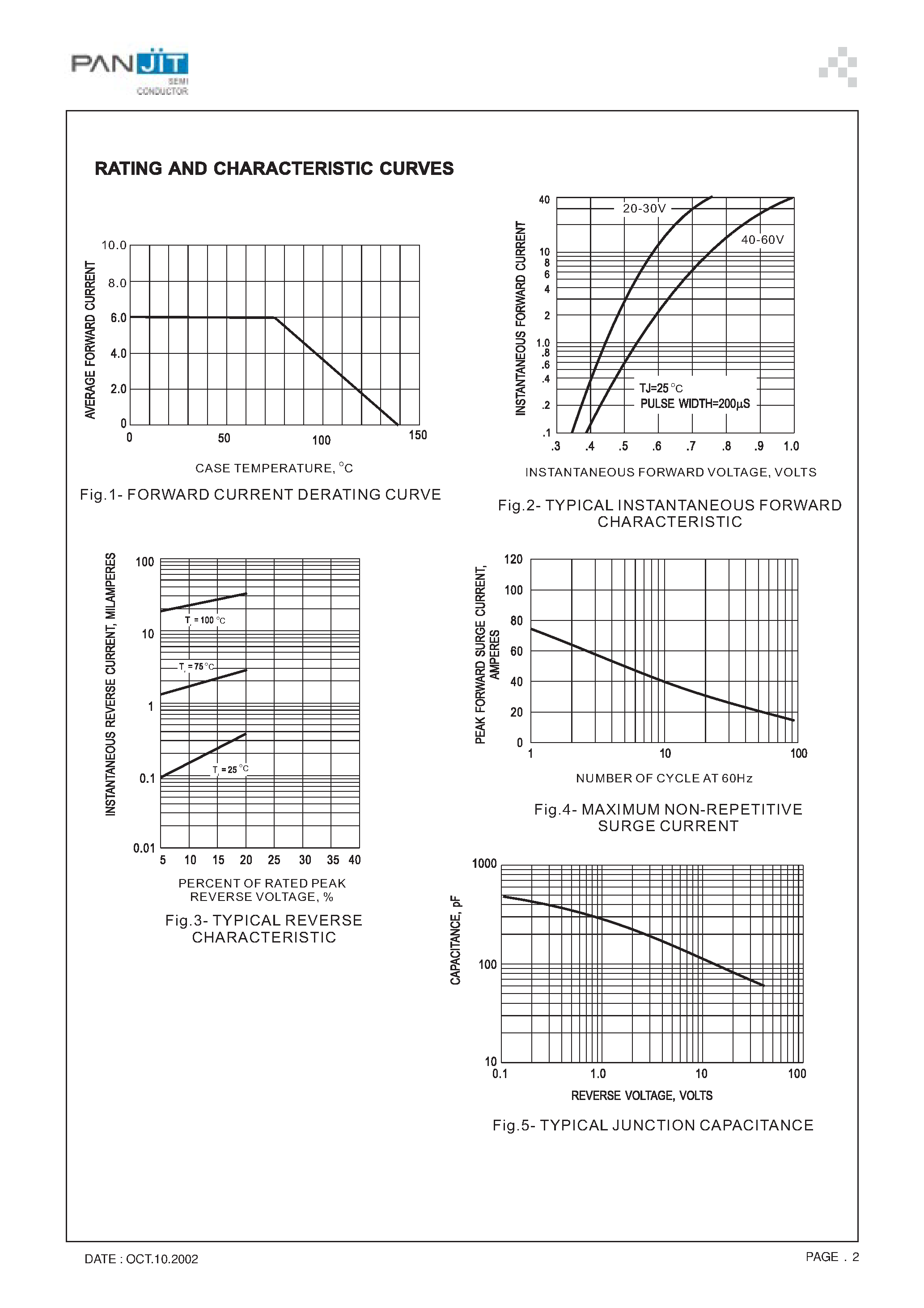

Datasheet SB620F - ISOLATION SCHOTTKY BARRIER RECTIFIERS(VOLTAGE 20 to 60 Volts CURRENT - 6 Ampere) page 2
