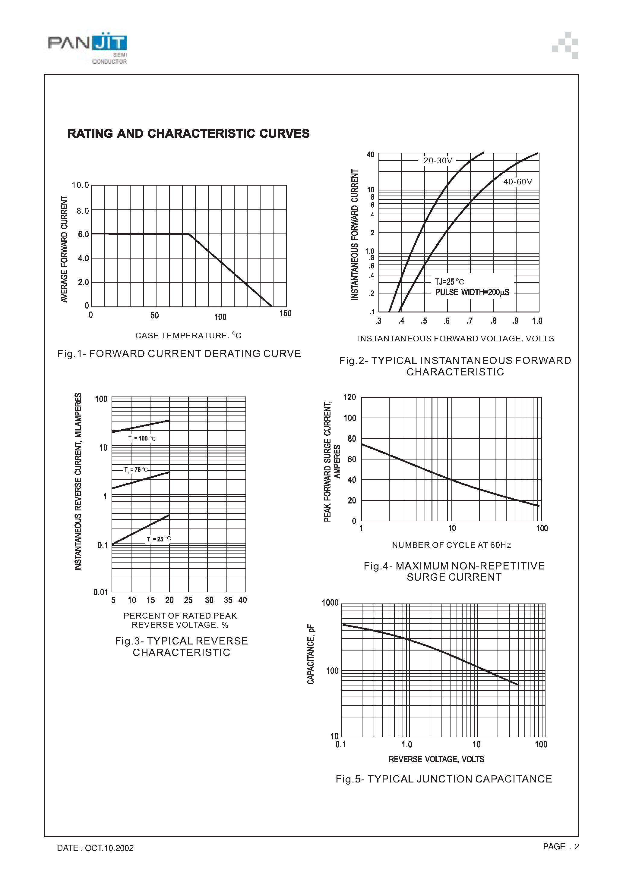

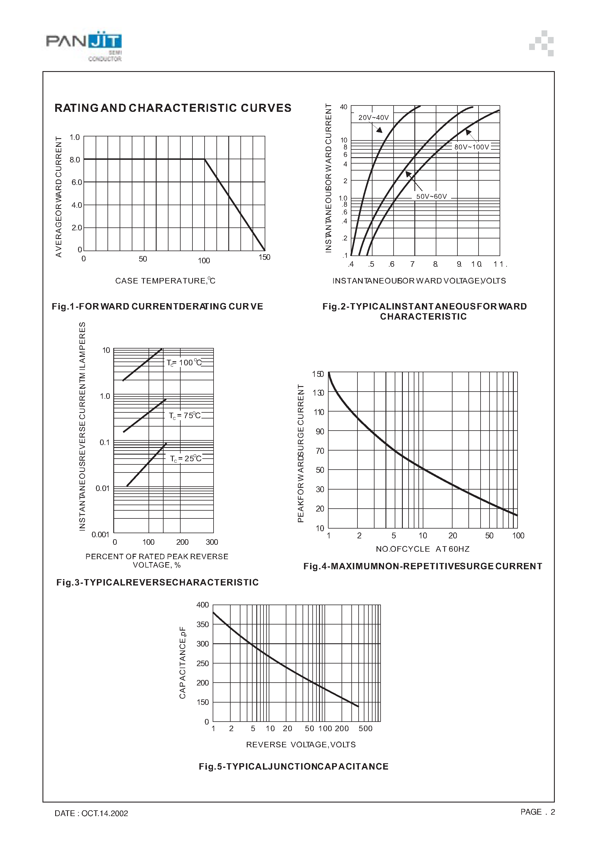

SB8100-SCHOTTKY BARRIER RECTIFIERS(VOLTAGE 20 to 100 Volts CURRENT - 8 Ampere)
Producer:Pan Jit International Inc.
Description:SCHOTTKY BARRIER RECTIFIERS(VOLTAGE 20 to 100 Volts CURRENT - 8 Ampere)
Others with the same file: SB8100
Datasheet SB8100 - SCHOTTKY BARRIER RECTIFIERS(VOLTAGE 20 to 100 Volts CURRENT - 8 Ampere) page 1
Datasheet SB8100 - SCHOTTKY BARRIER RECTIFIERS(VOLTAGE 20 to 100 Volts CURRENT - 8 Ampere) page 2
