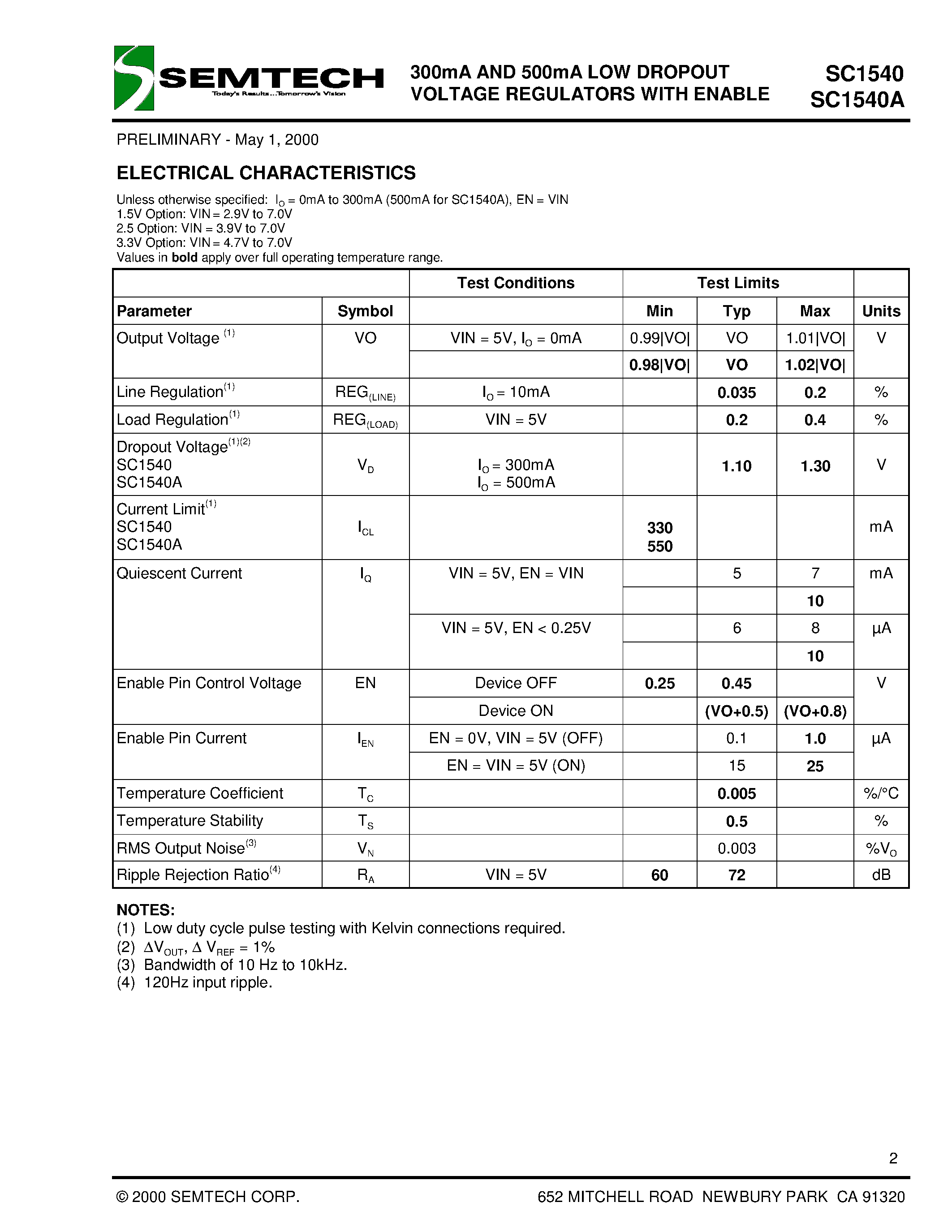

SC1540ACS-1.8-300mA AND 500mA LOW DROPOUT VOLTAGE REGULATORS WITH ENABLE
Producer:Semtech Corporation
Description:300mA AND 500mA LOW DROPOUT VOLTAGE REGULATORS WITH ENABLE
