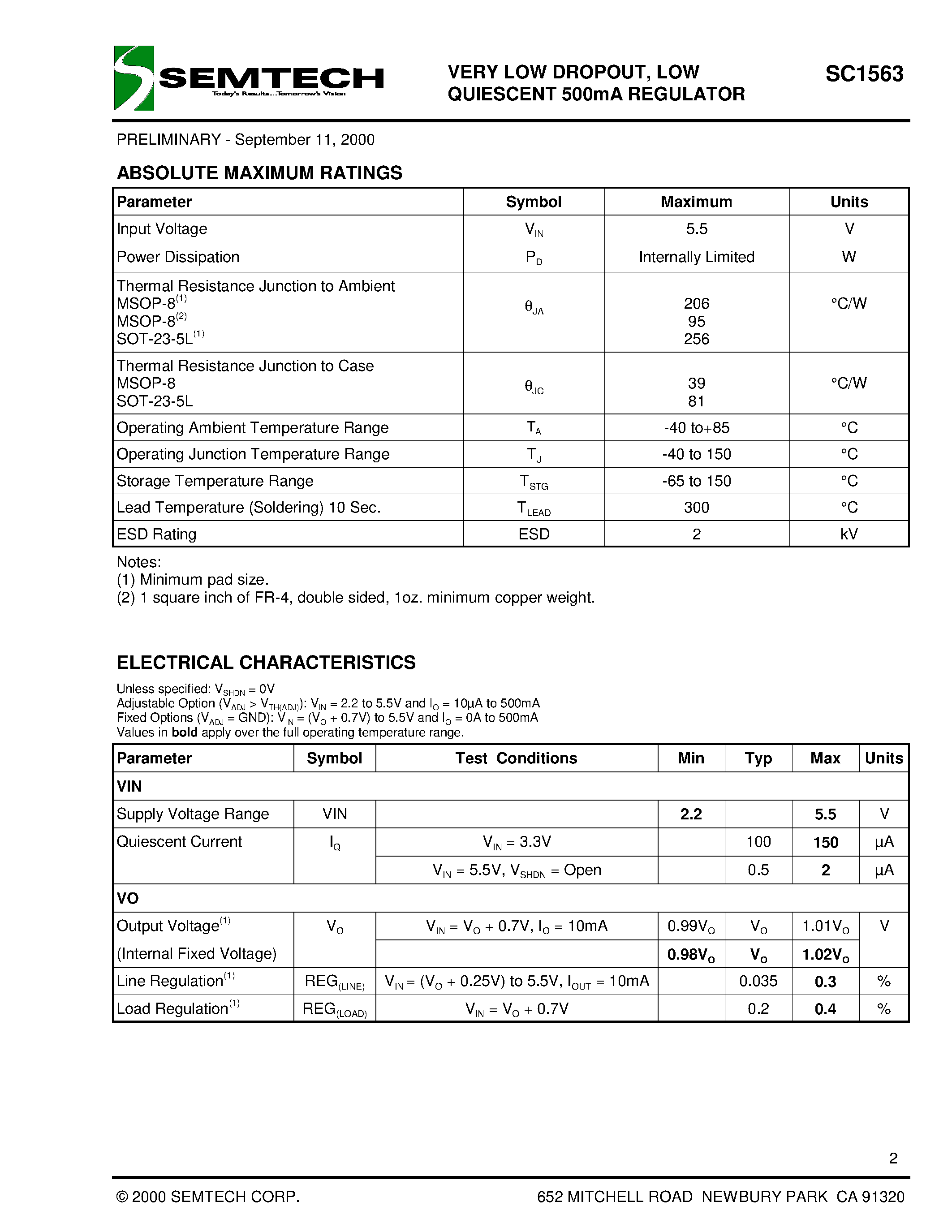

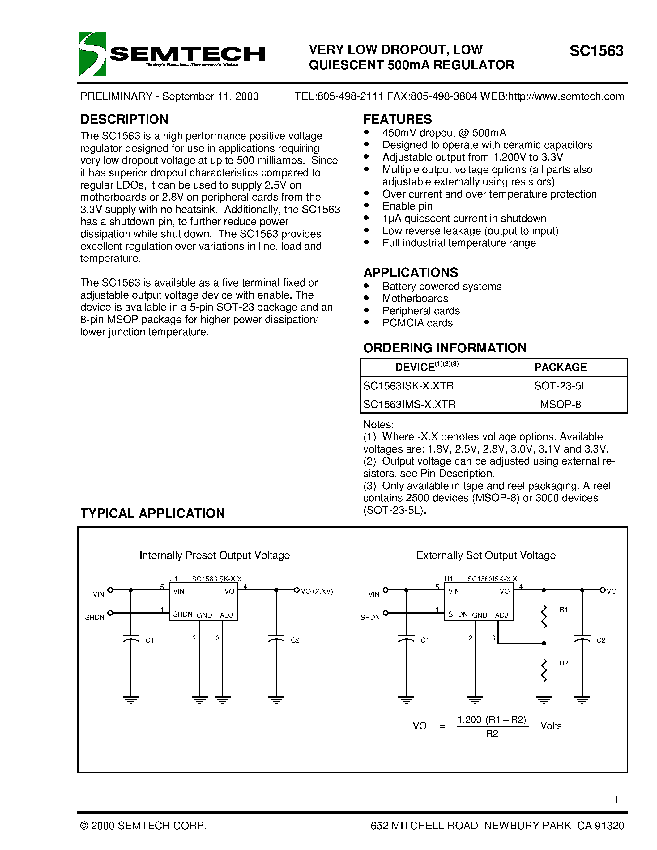

SC1563IMS-1.8-VERY LOW DROPOUT/ LOW QUIESCENT 500mA REGULATOR
Producer:Semtech Corporation
Description:VERY LOW DROPOUT/ LOW QUIESCENT 500mA REGULATOR
