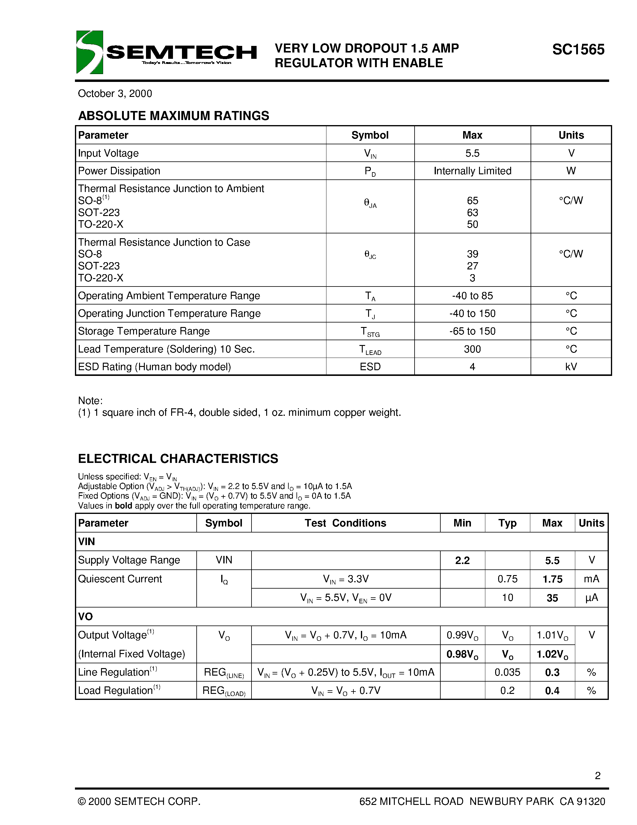

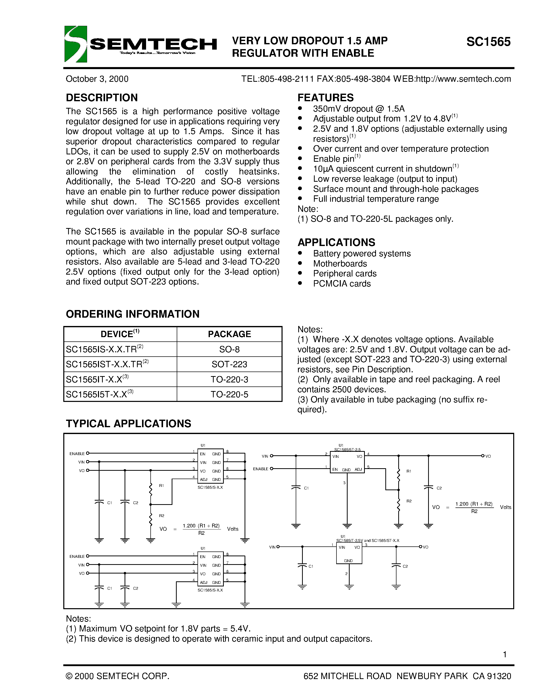

SC1565-VERY LOW DROPOUT 1.5 AMP REGULATOR WITH ENABLE
Producer:Semtech Corporation
Description:VERY LOW DROPOUT 1.5 AMP REGULATOR WITH ENABLE
