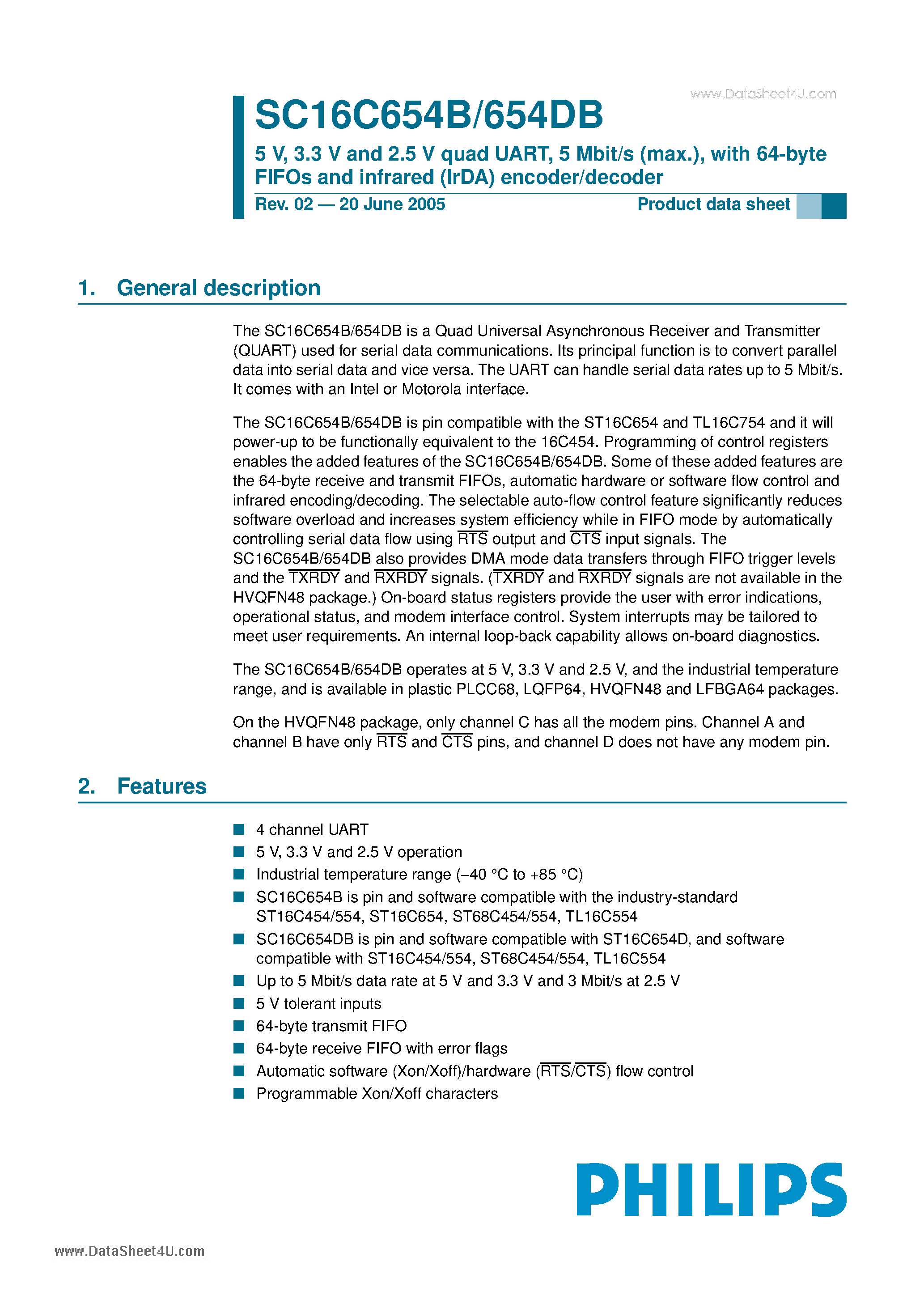

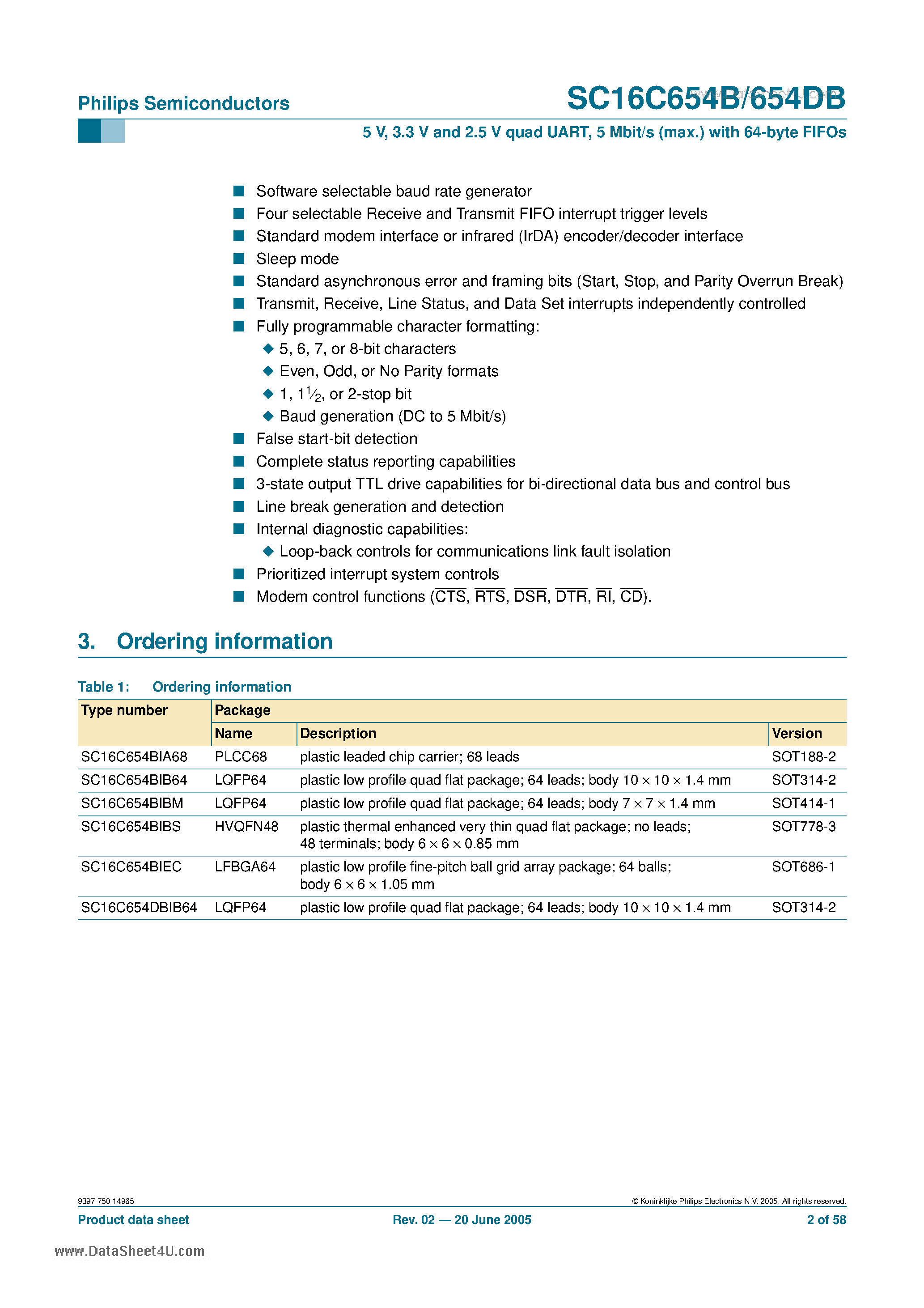

SC16C654B-5 V - 3.3 V and 2.5 V quad UART - 5 Mbit/s (max.)
Producer:NXP Semiconductors
Description:5 V - 3.3 V and 2.5 V quad UART - 5 Mbit/s (max.)
