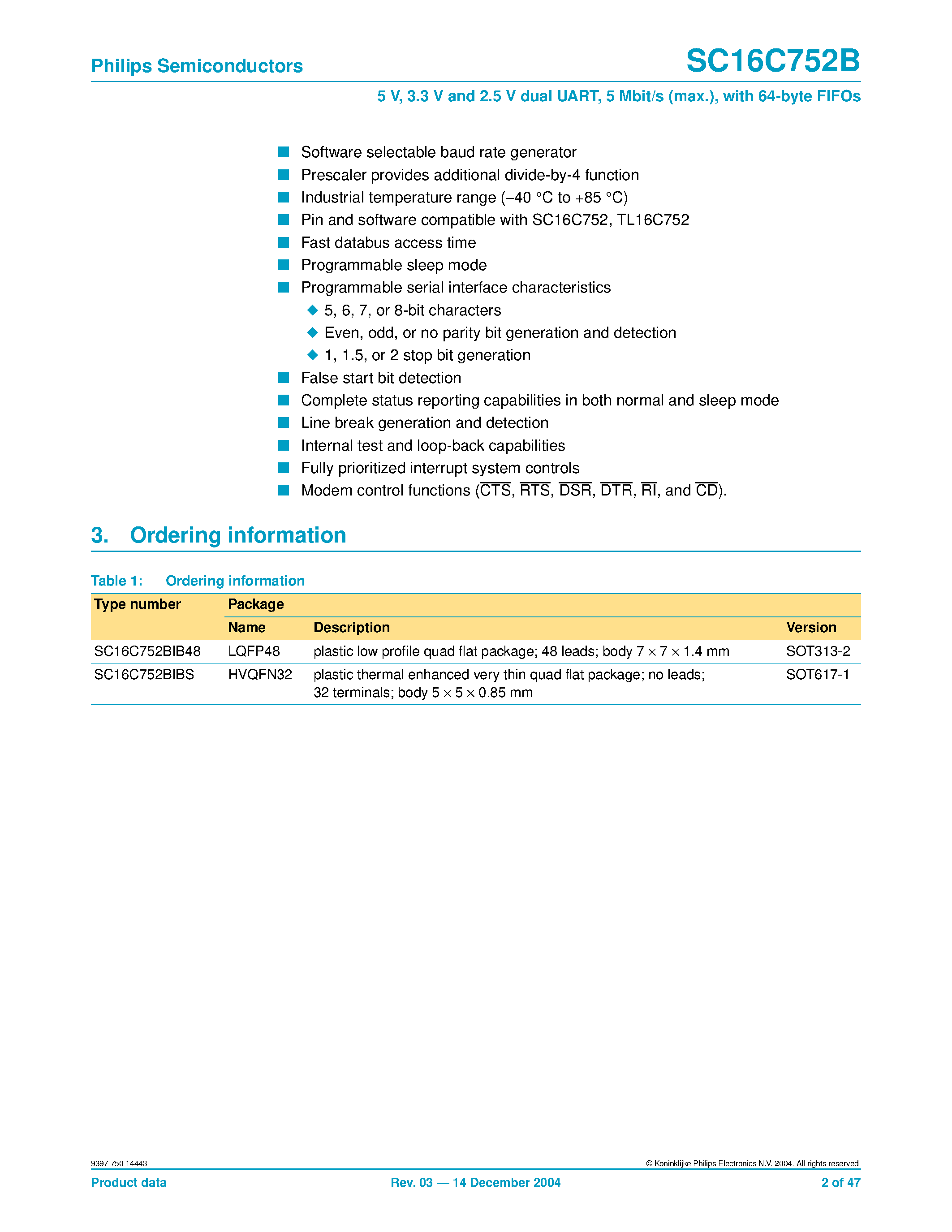

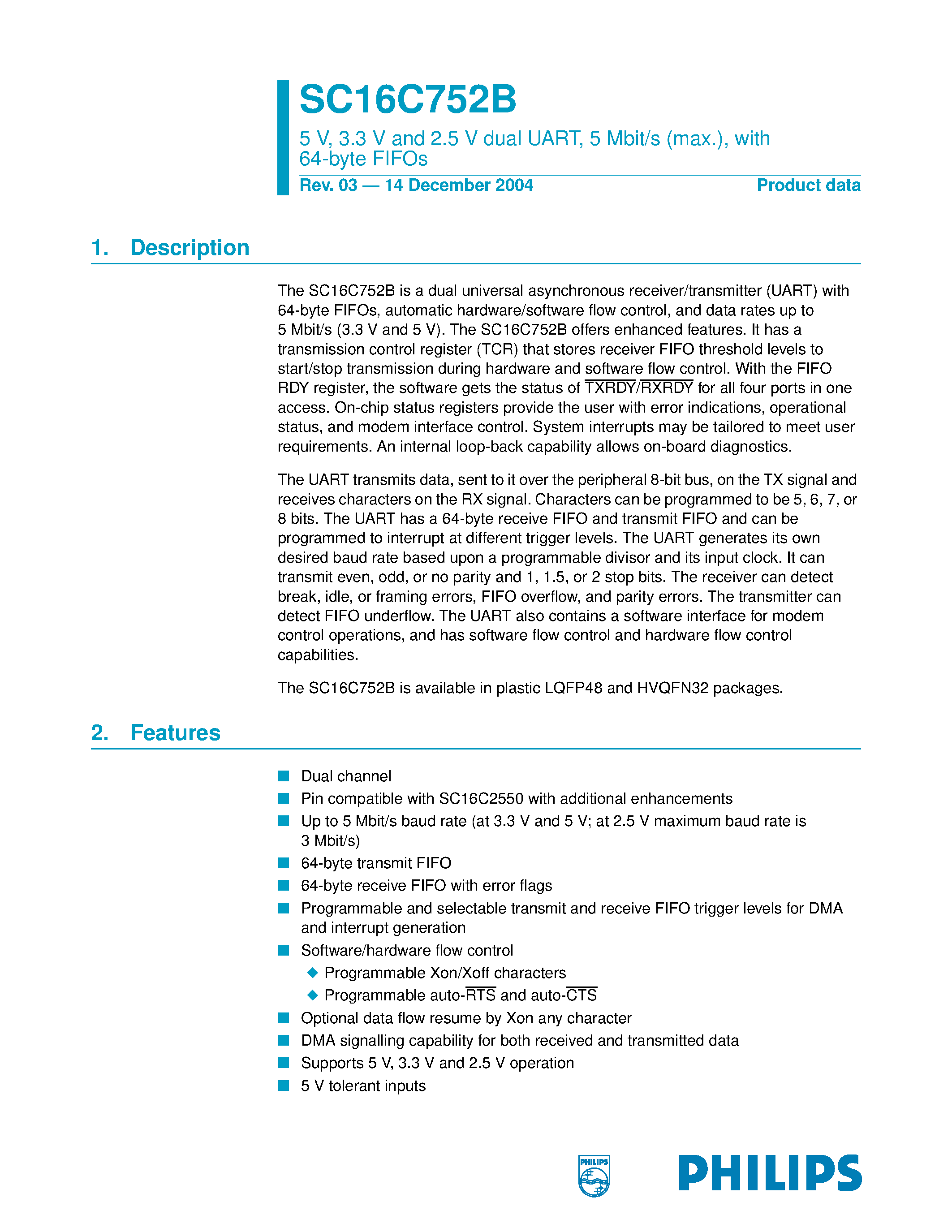

SC16C752B-5 V/ 3.3 V and 2.5 V dual UART/ 5 Mbit/s (max.)/ with 64-byte FIFOs
Description:5 V/ 3.3 V and 2.5 V dual UART/ 5 Mbit/s (max.)/ with 64-byte FIFOs
