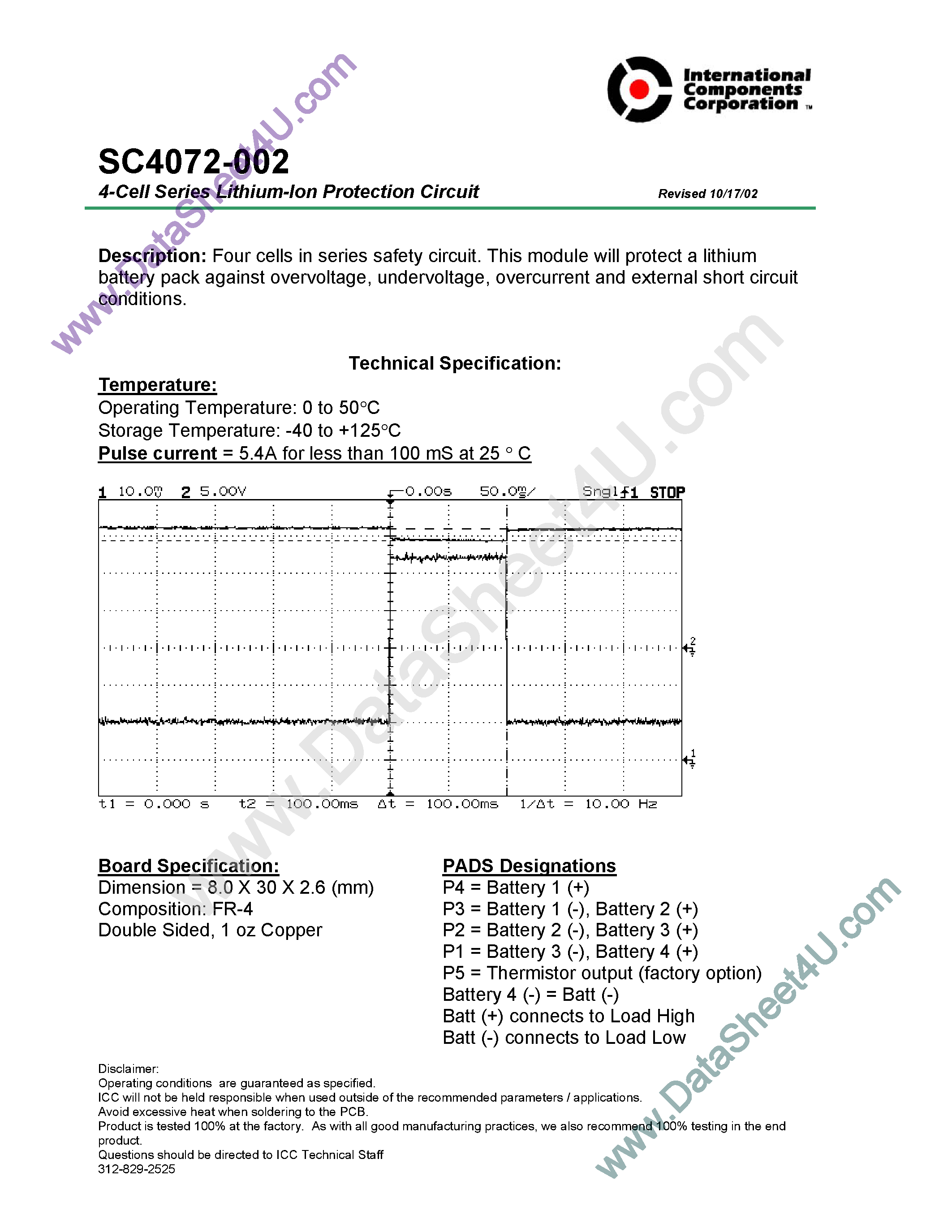

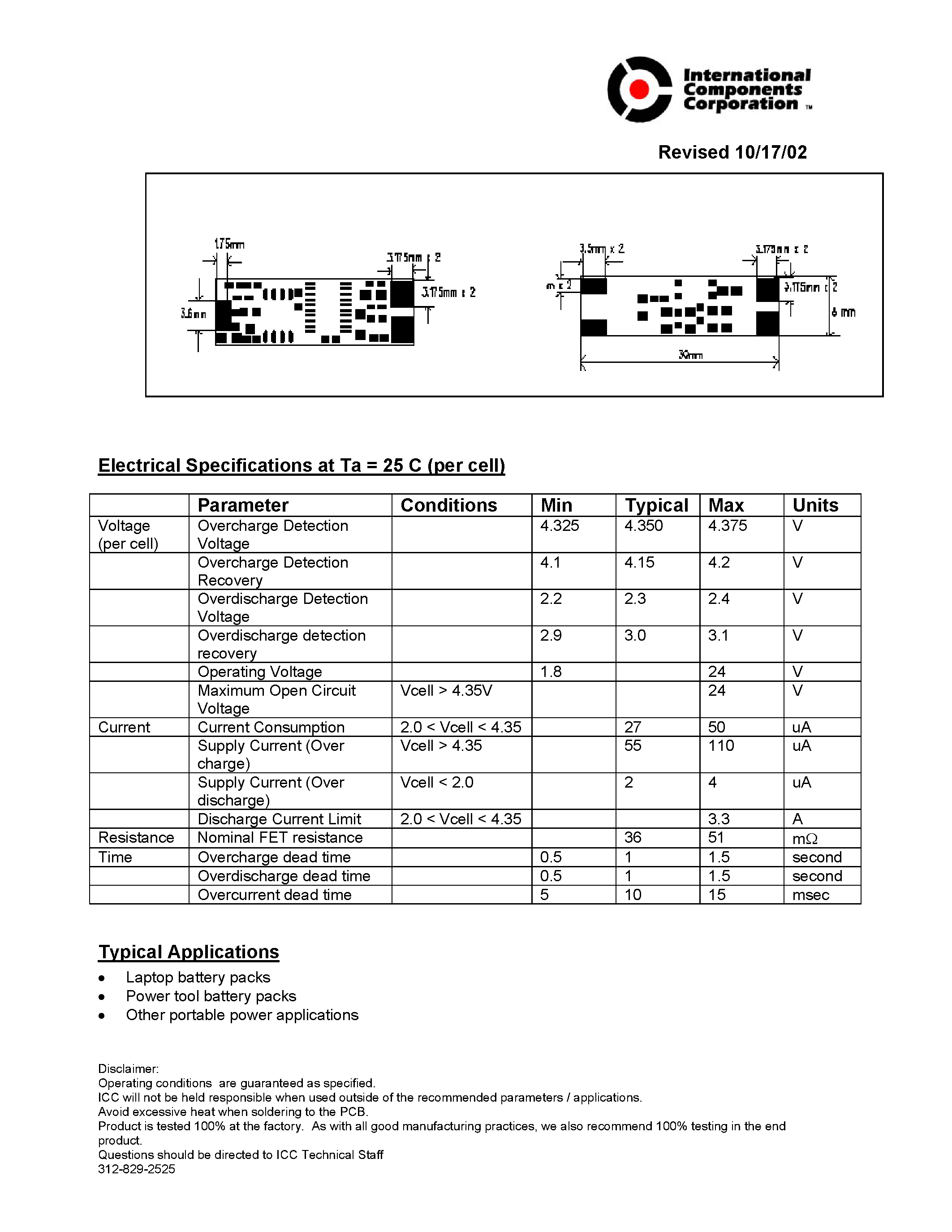

SC4072-002-4-cell Lithium-ion SaFETy Circuit
Producer:International Components
Description:4-cell Lithium-ion SaFETy Circuit
Others with the same file: SC4072-002
Datasheet SC4072-002 - 4-cell Lithium-ion SaFETy Circuit page 1
Datasheet SC4072-002 - 4-cell Lithium-ion SaFETy Circuit page 2
