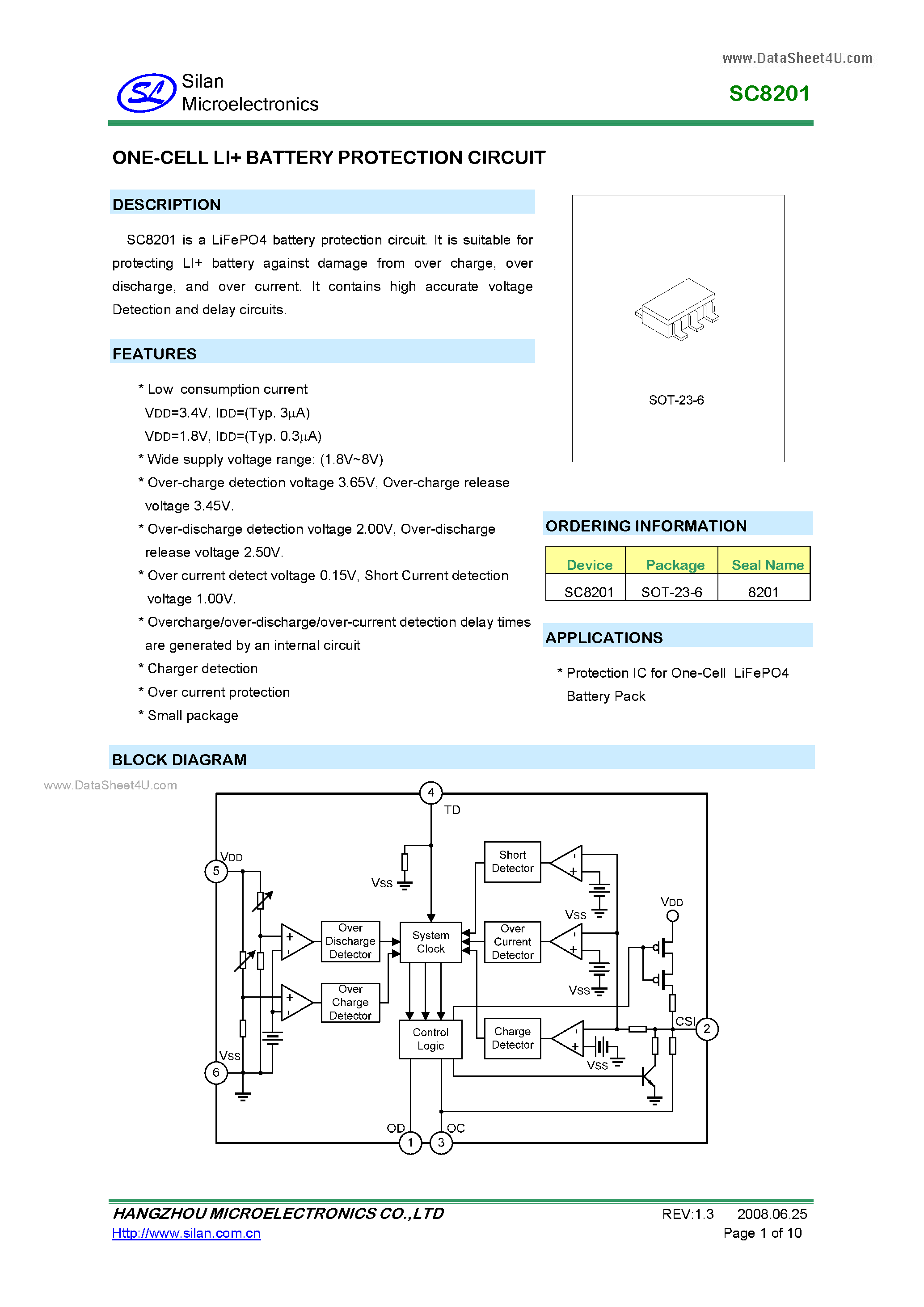

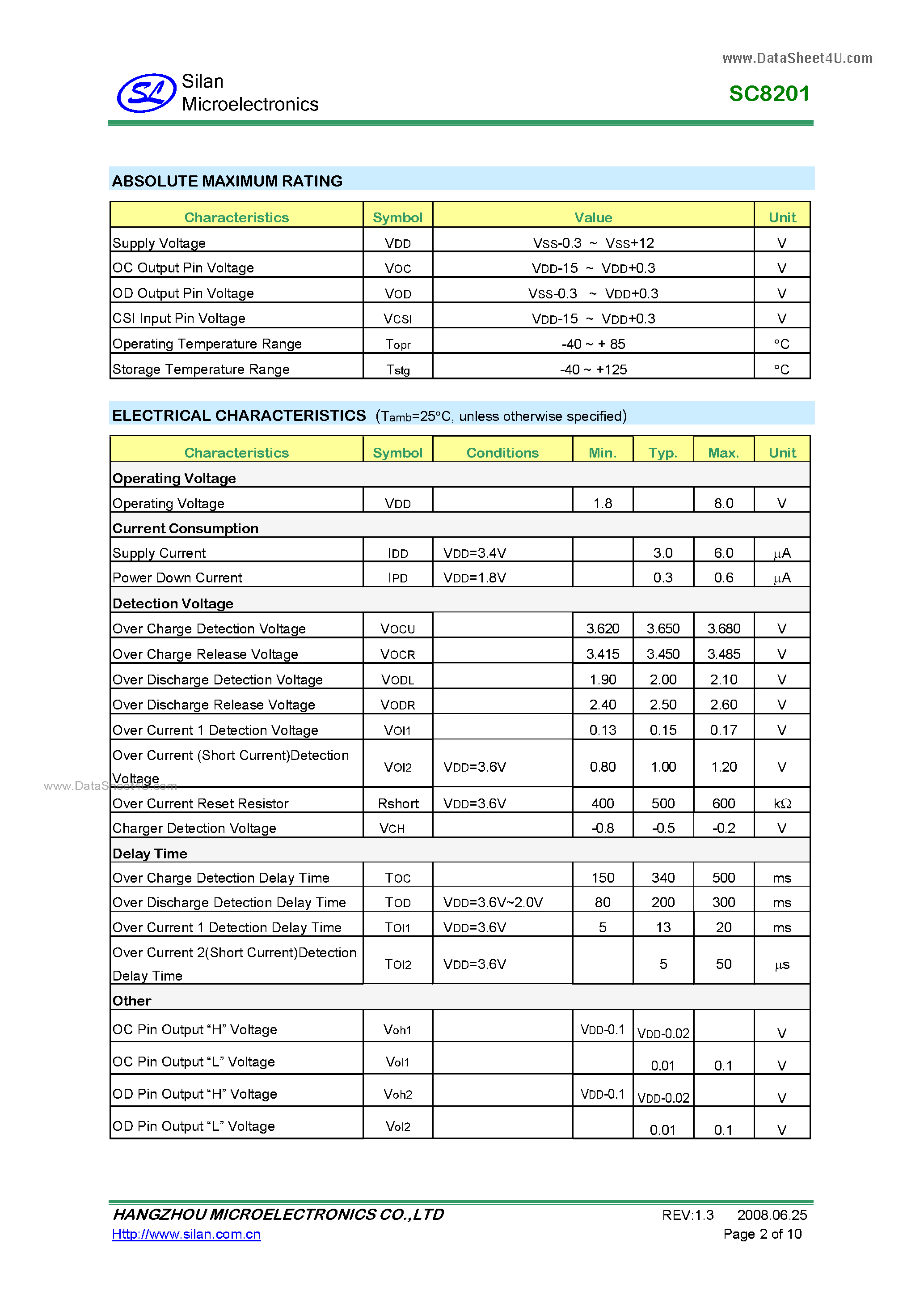

SC8201-ONE-CELL LI BATTERY PROTECTION CIRCUIT
Producer:Silan Microelectronics
Description:ONE-CELL LI BATTERY PROTECTION CIRCUIT
Others with the same file: SC8201
Datasheet SC8201 - ONE-CELL LI BATTERY PROTECTION CIRCUIT page 1
Datasheet SC8201 - ONE-CELL LI BATTERY PROTECTION CIRCUIT page 2
