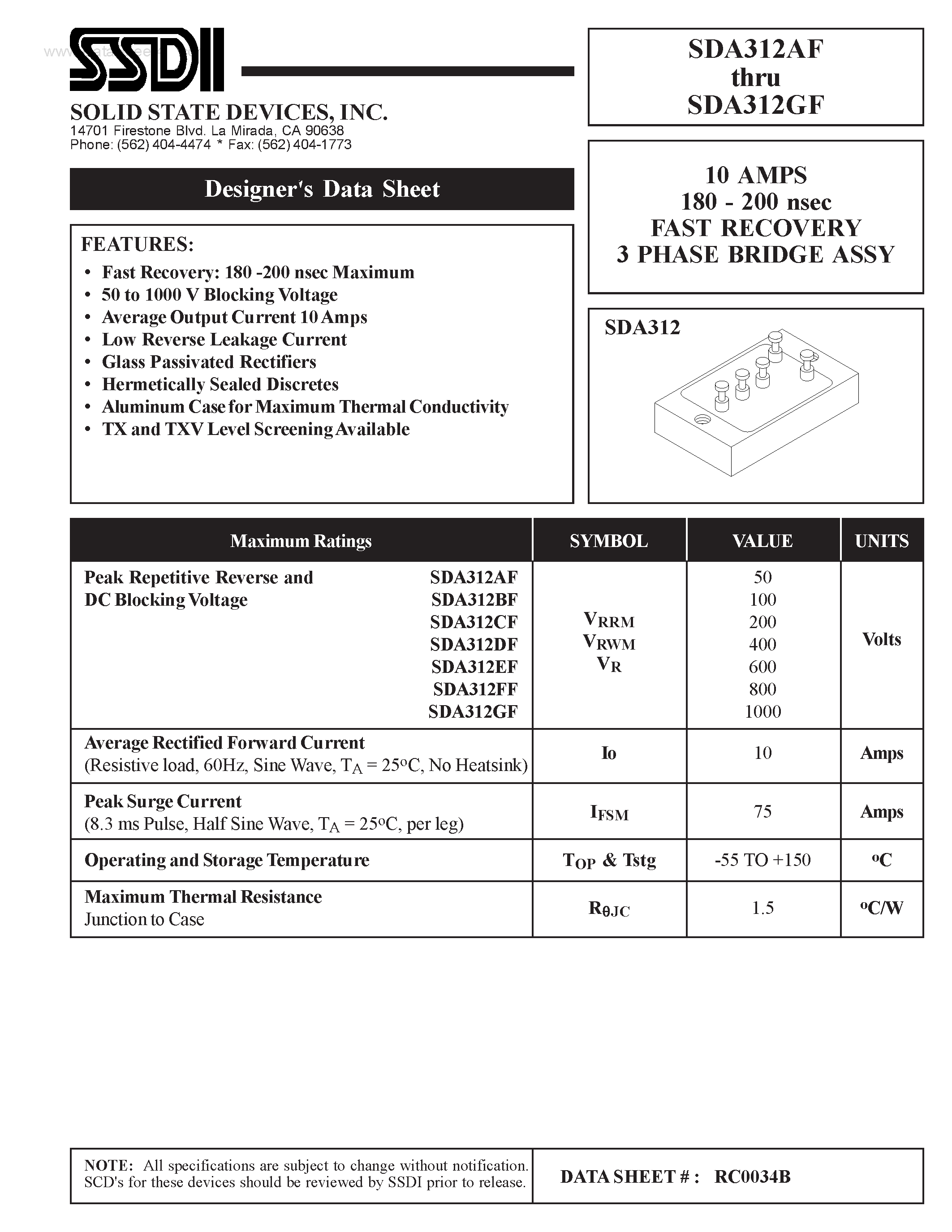

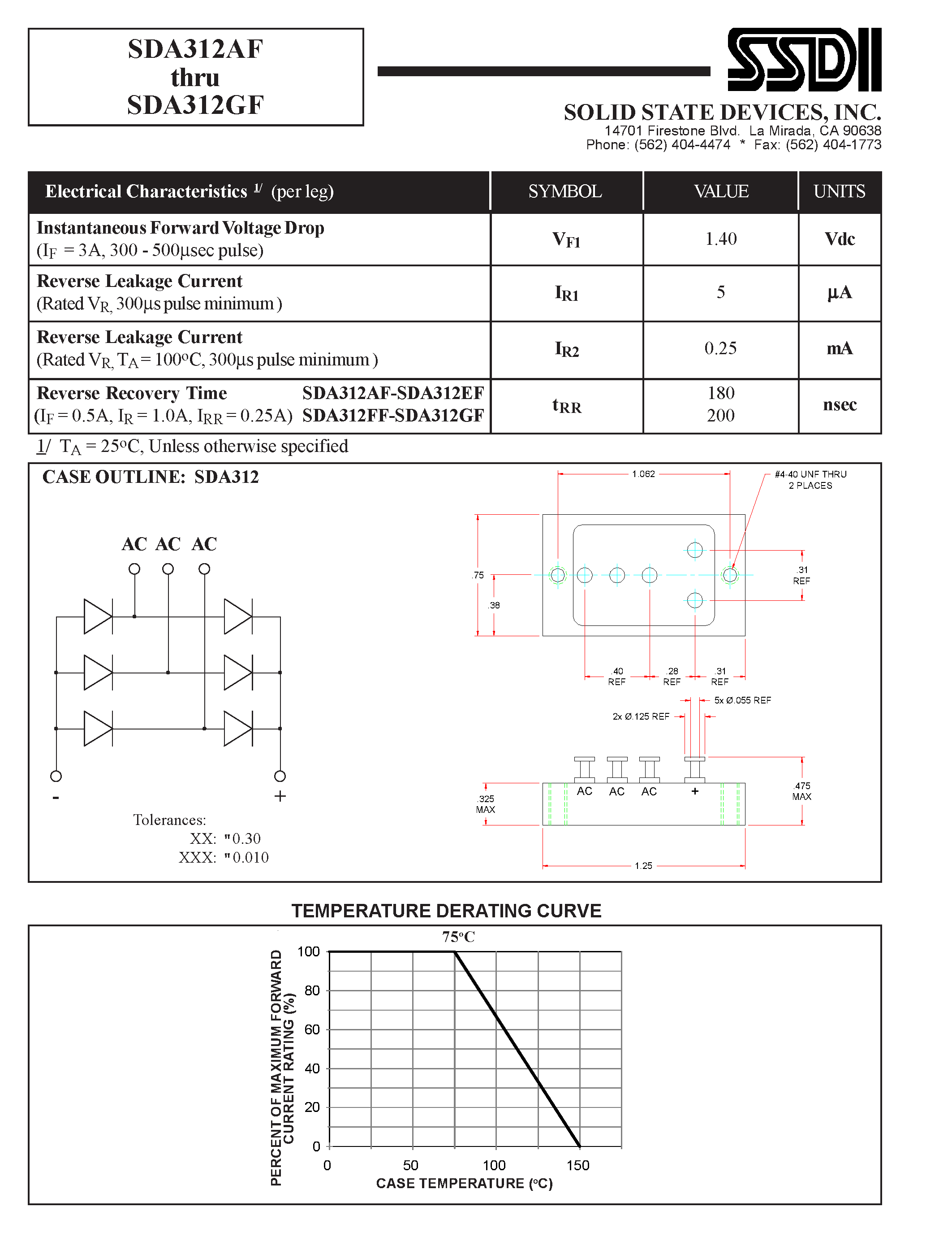

SDA312AF-(SDA312AF - SDA312GF) FAST RECOVERY 3 PHASE BRIDGE ASSY
Producer:SSDI
Description:(SDA312AF - SDA312GF) FAST RECOVERY 3 PHASE BRIDGE ASSY
