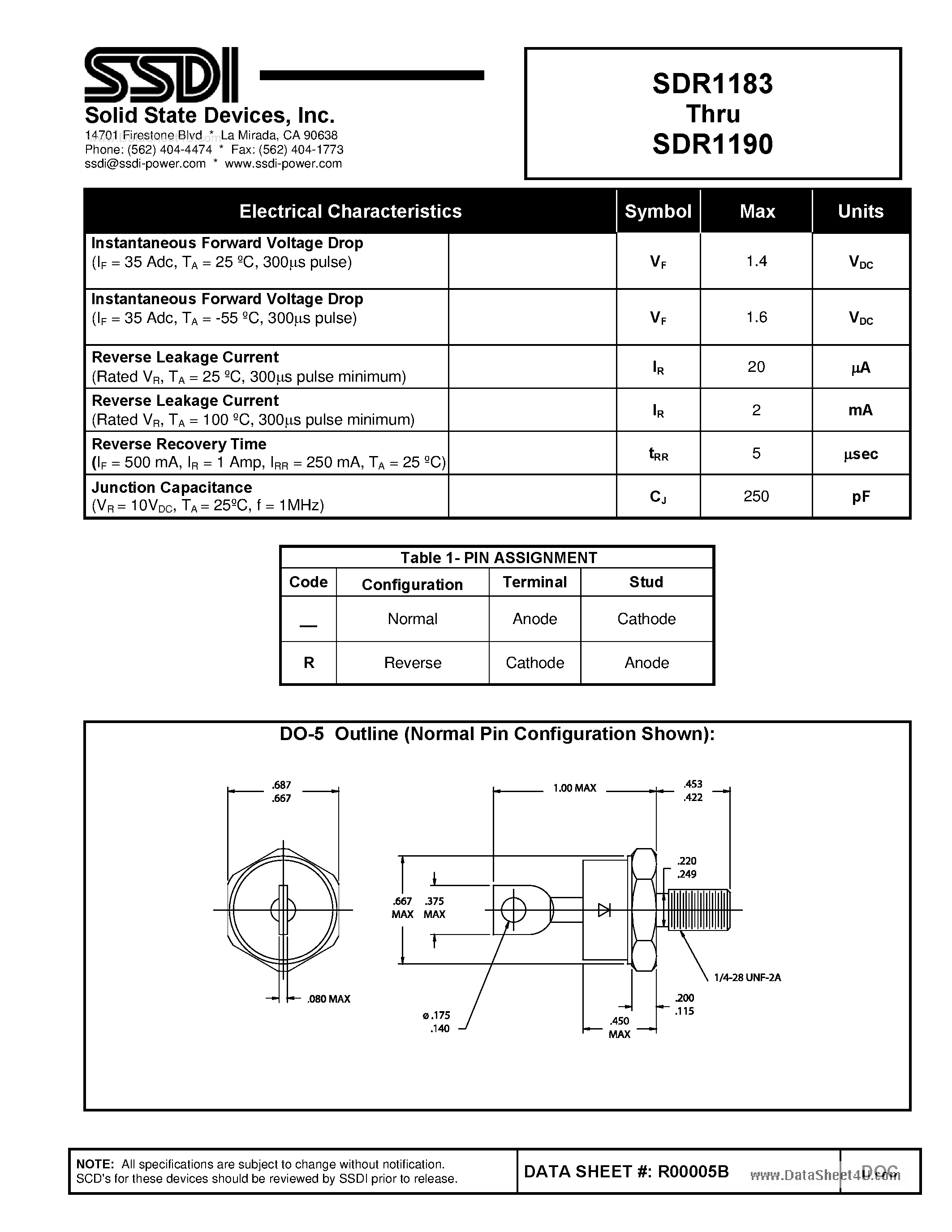

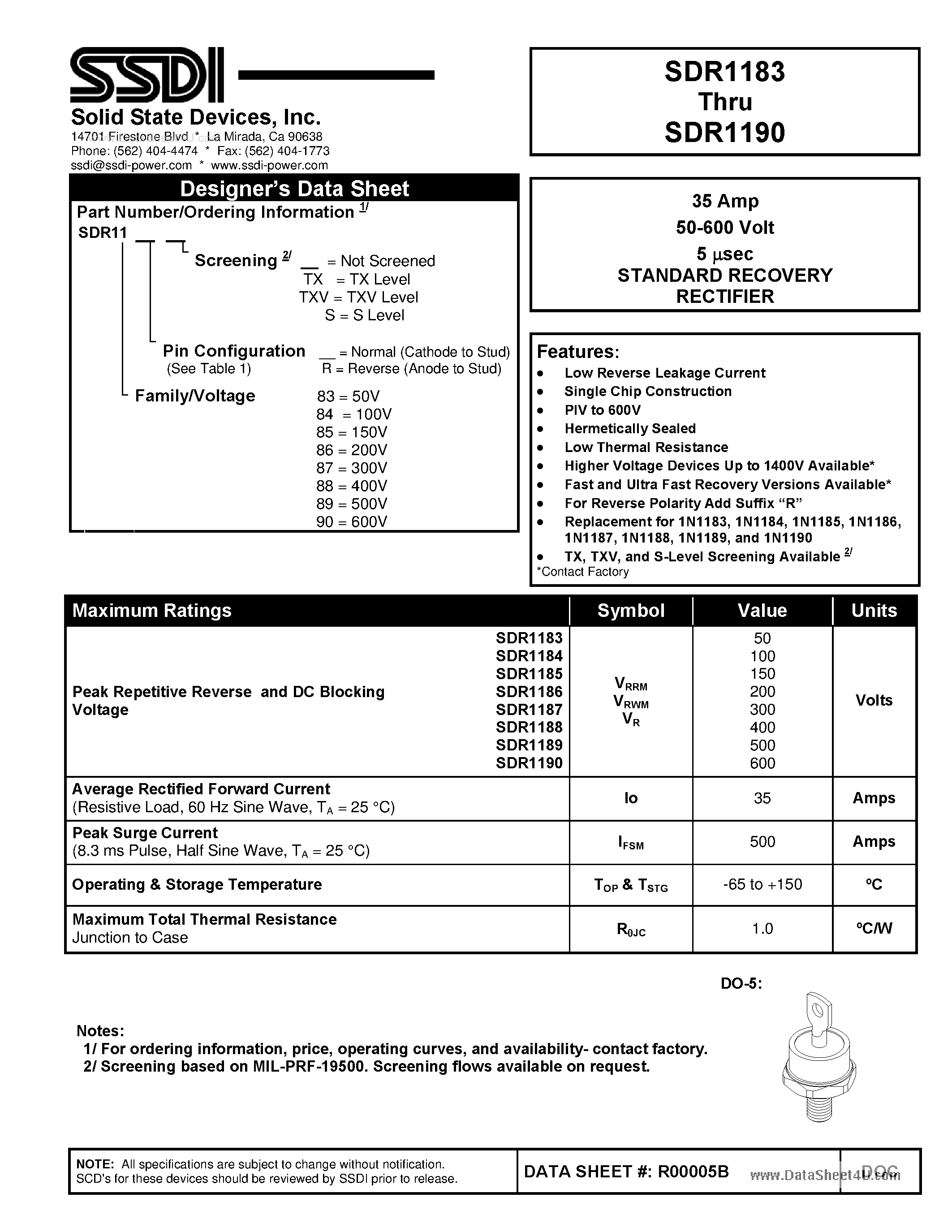

SDR1183-(SDR1183 - SDR1190) 35 Amp 50-600 Volt 5 nsec STANDARD RECOVERY RECTIFIER
Producer:Solid States Devices
Description:(SDR1183 - SDR1190) 35 Amp 50-600 Volt 5 nsec STANDARD RECOVERY RECTIFIER
