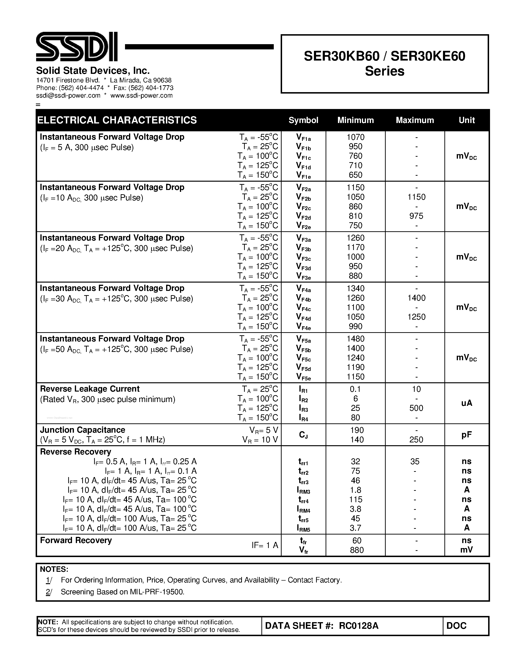

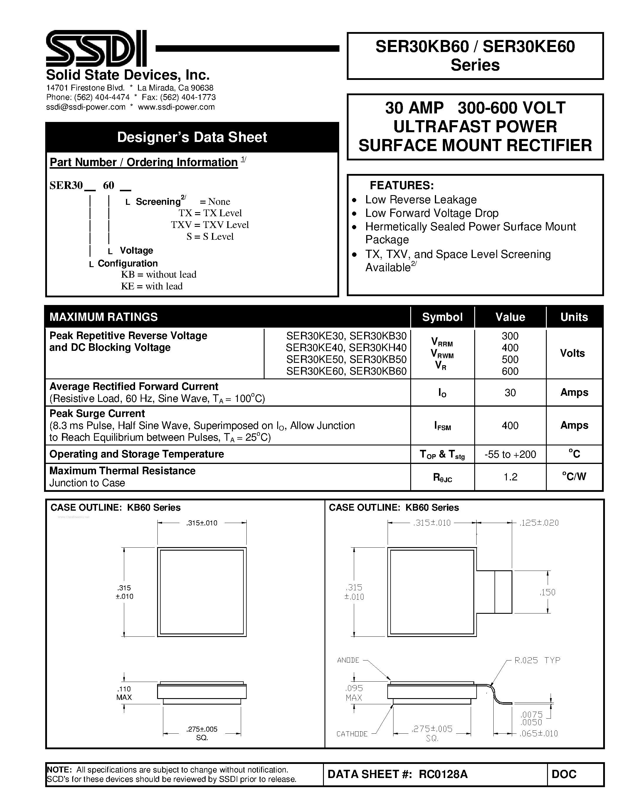

SER30KB30-30AMP 300-600 VOLT ULTRAFAST POWER SURFACE MOUNT RECTIFIER
Producer:Solid States Devices
Description:30AMP 300-600 VOLT ULTRAFAST POWER SURFACE MOUNT RECTIFIER
