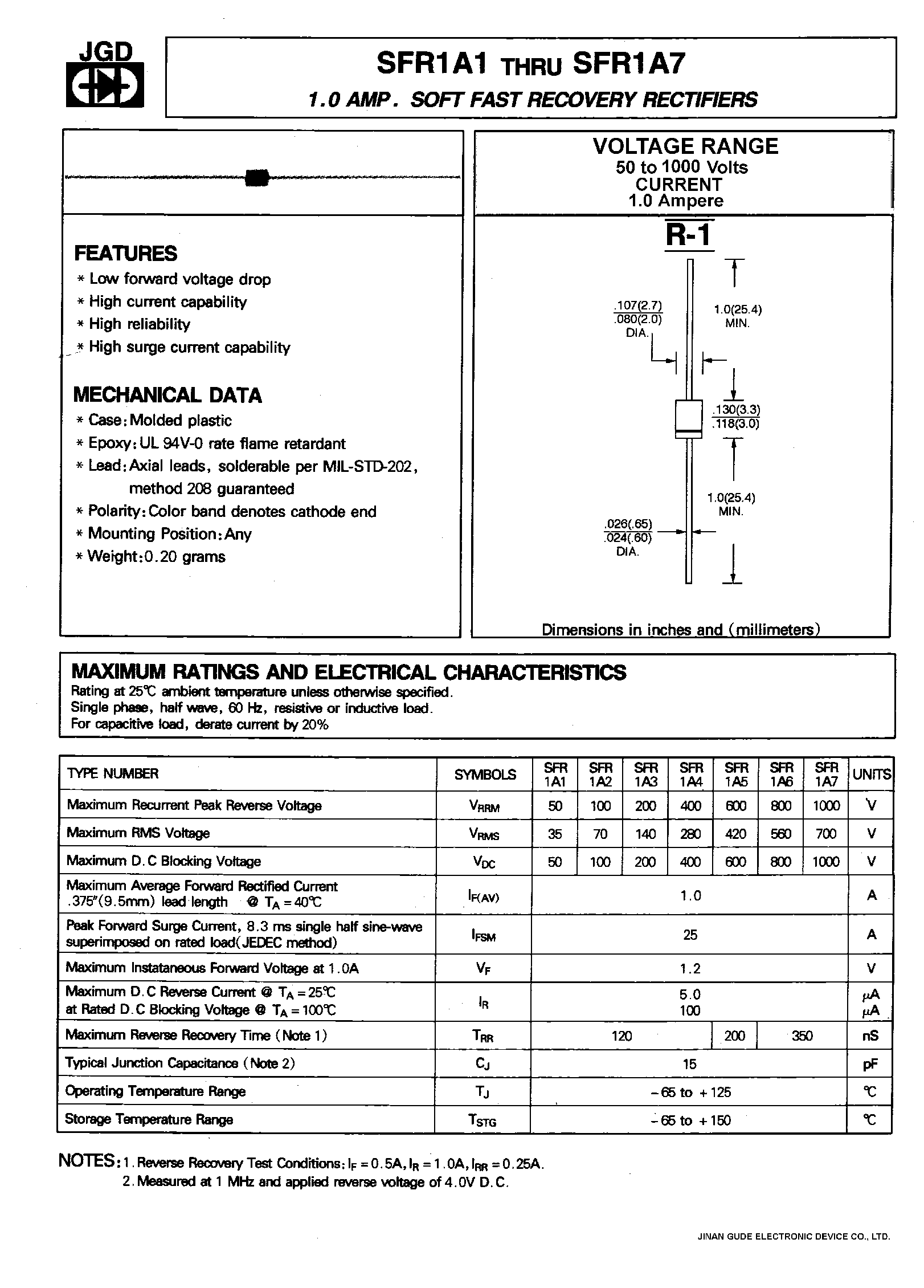

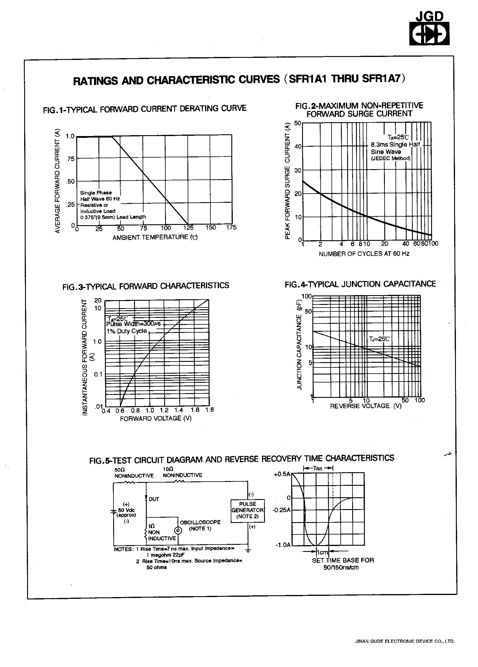

SFR1A5-1.0 AMP. SOFT FAST RECOVERY RECTIFIERS
Producer:Jinan Gude Electronic Device
Description:1.0 AMP. SOFT FAST RECOVERY RECTIFIERS
Others with the same file: SFR1A5
Datasheet SFR1A5 - 1.0 AMP. SOFT FAST RECOVERY RECTIFIERS page 1
Datasheet SFR1A5 - 1.0 AMP. SOFT FAST RECOVERY RECTIFIERS page 2
