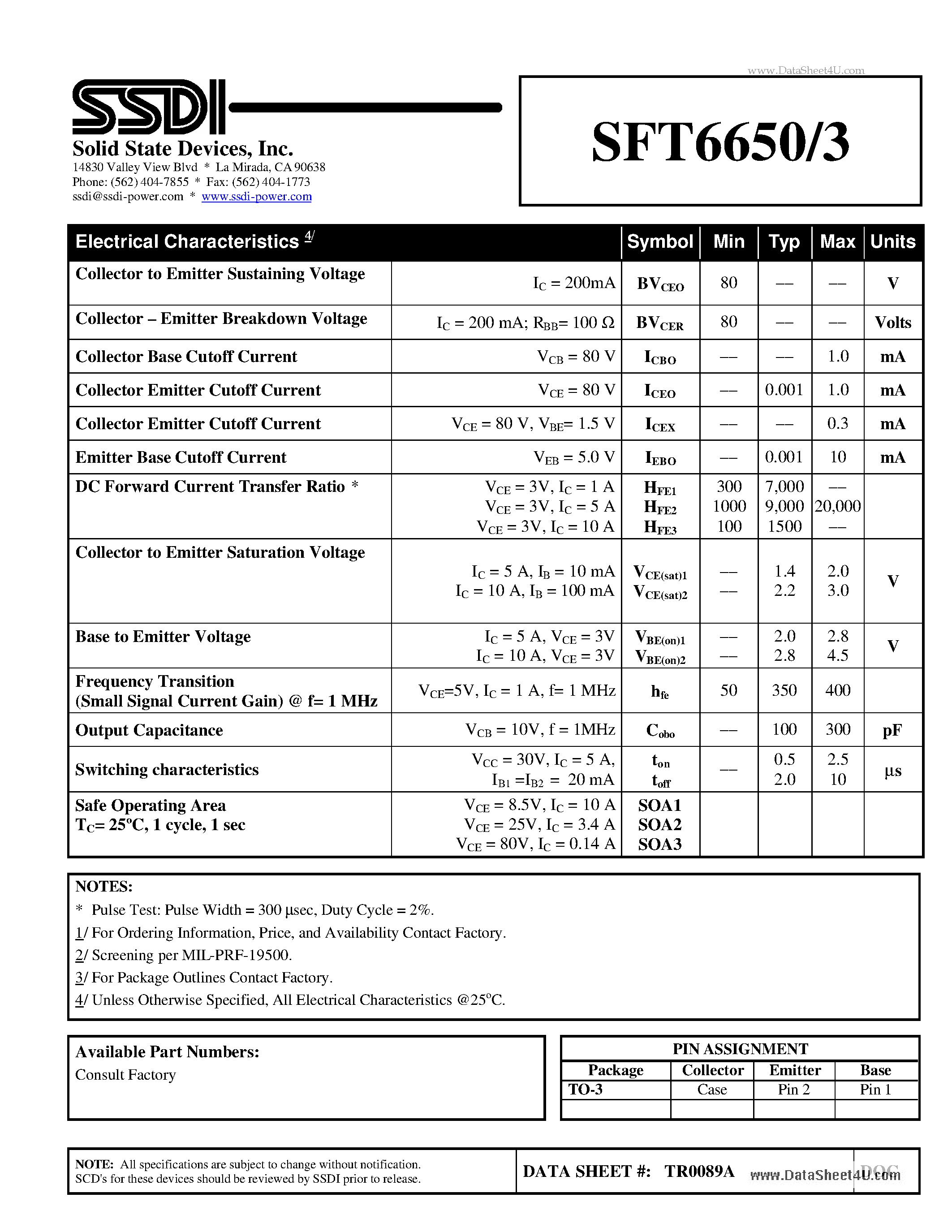

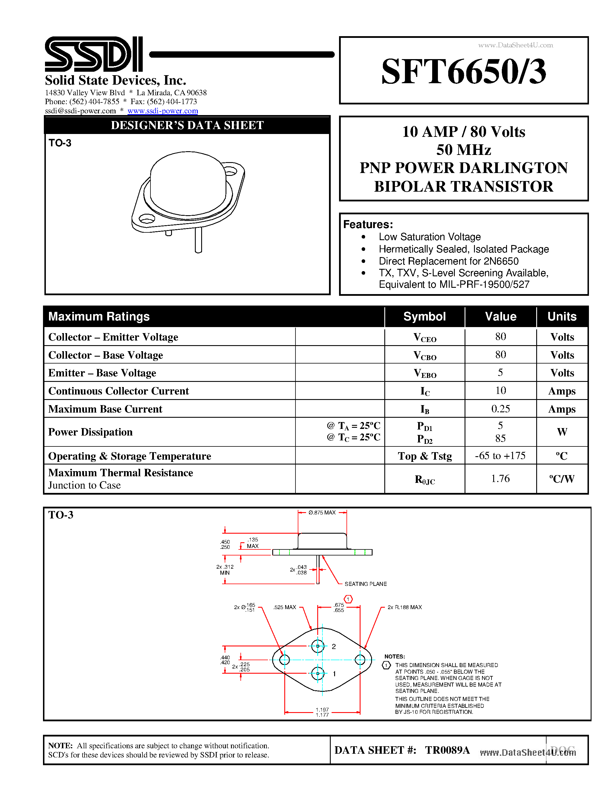

SFT6650-3-10 AMP / 80 Volts 50 MHz PNP POWER DARLINGTON BIPOLAR TRANSISTOR
Producer:Solid States Devices
Description:10 AMP / 80 Volts 50 MHz PNP POWER DARLINGTON BIPOLAR TRANSISTOR
Others with the same file: SFT6650-3
Datasheet SFT6650-3 - 10 AMP / 80 Volts 50 MHz PNP POWER DARLINGTON BIPOLAR TRANSISTOR page 1
Datasheet SFT6650-3 - 10 AMP / 80 Volts 50 MHz PNP POWER DARLINGTON BIPOLAR TRANSISTOR page 2
