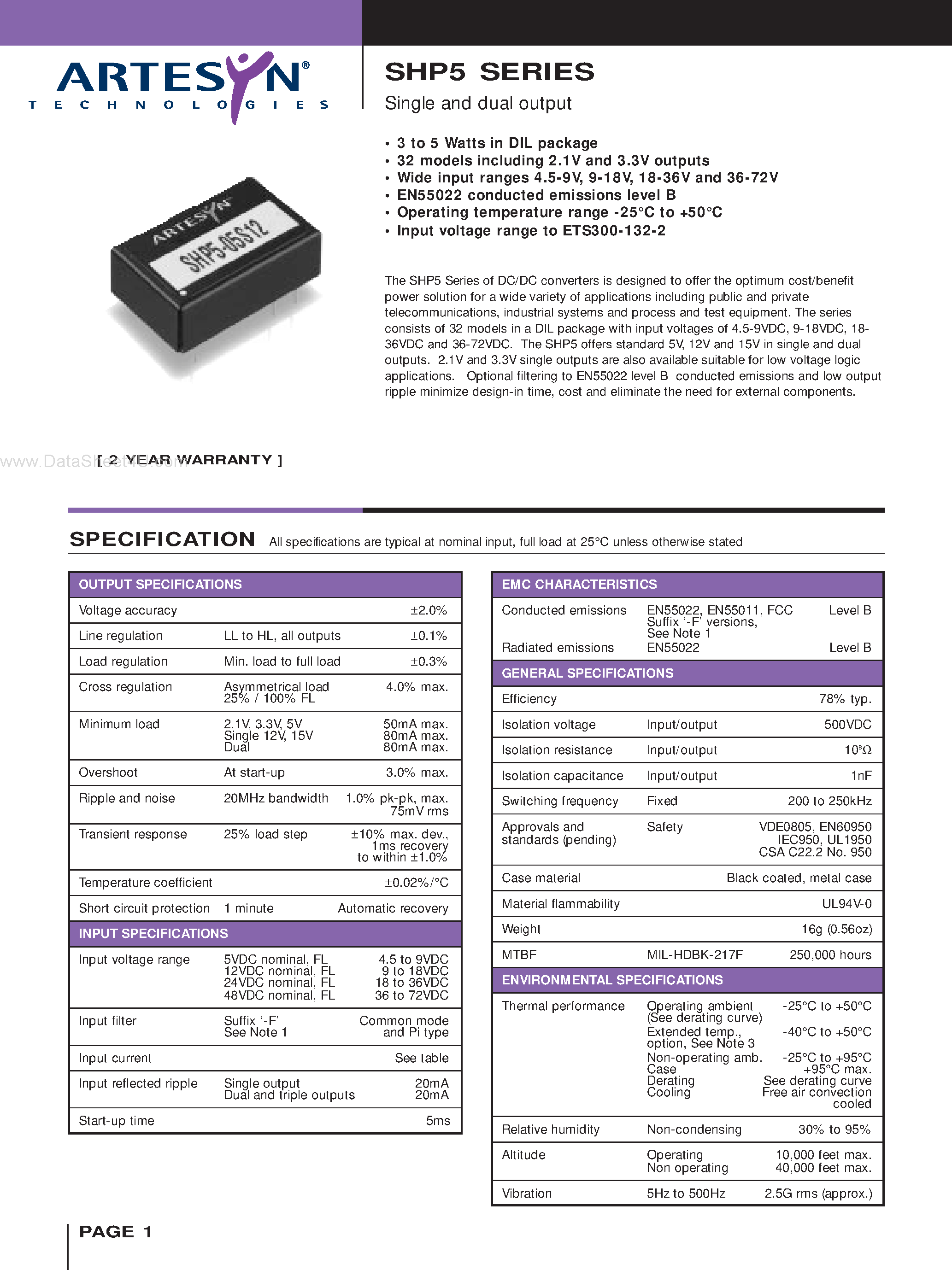

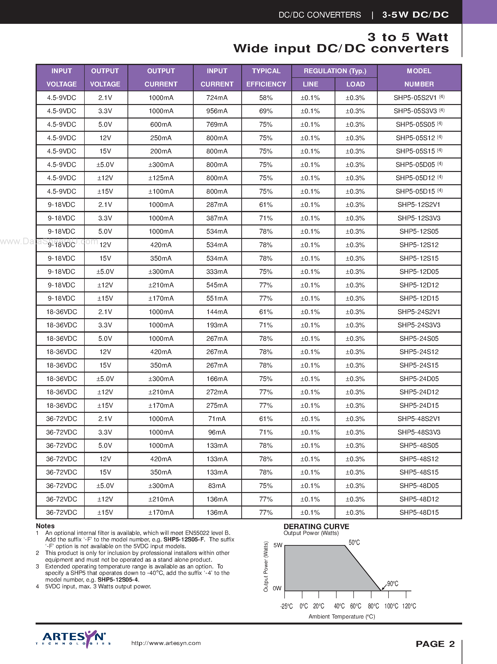

SHP5-Single and dual output 3 to 5 Watt Wide input DC/DC converters
Producer:Artesyn Technologies
Description:Single and dual output 3 to 5 Watt Wide input DC/DC converters
