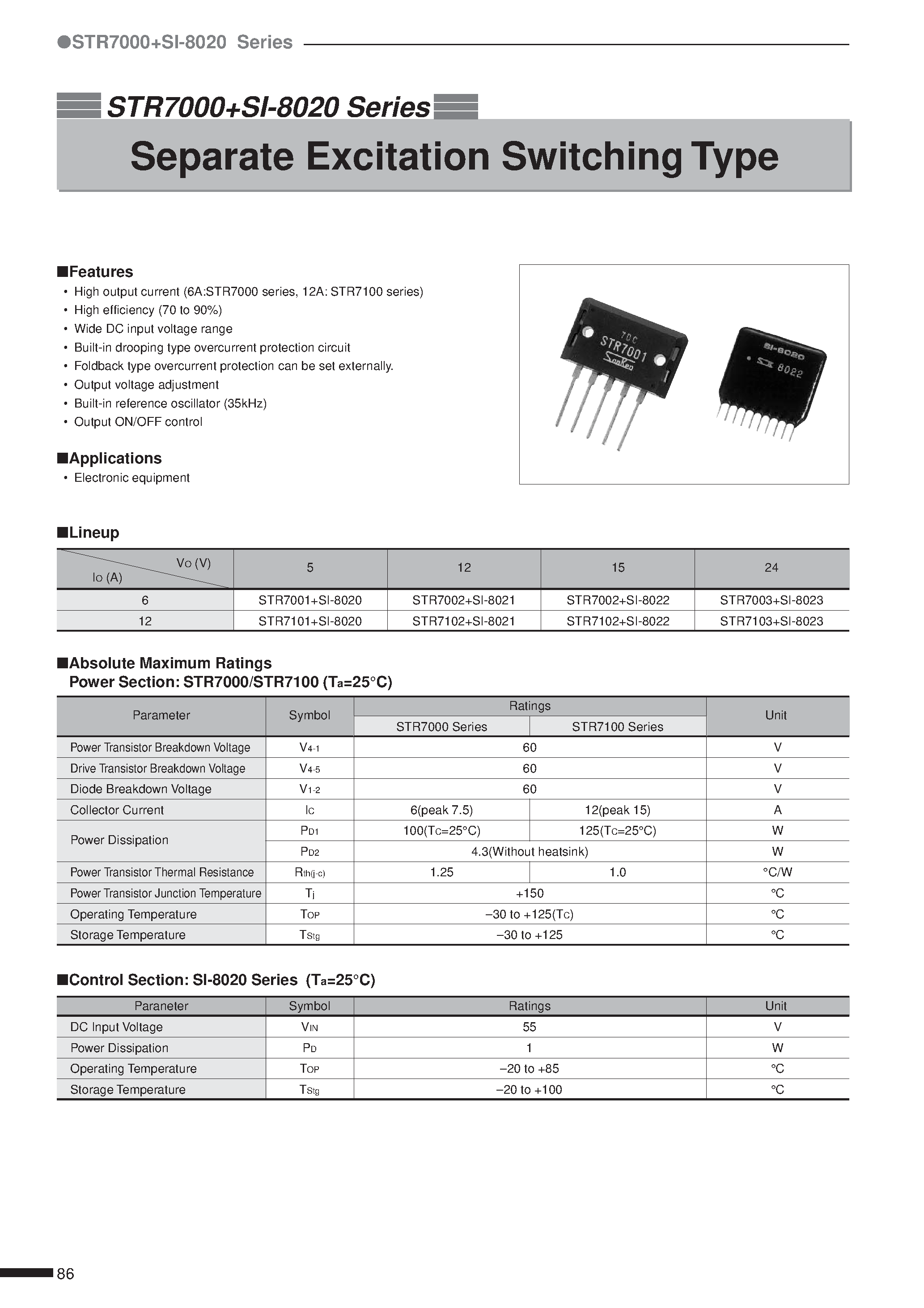

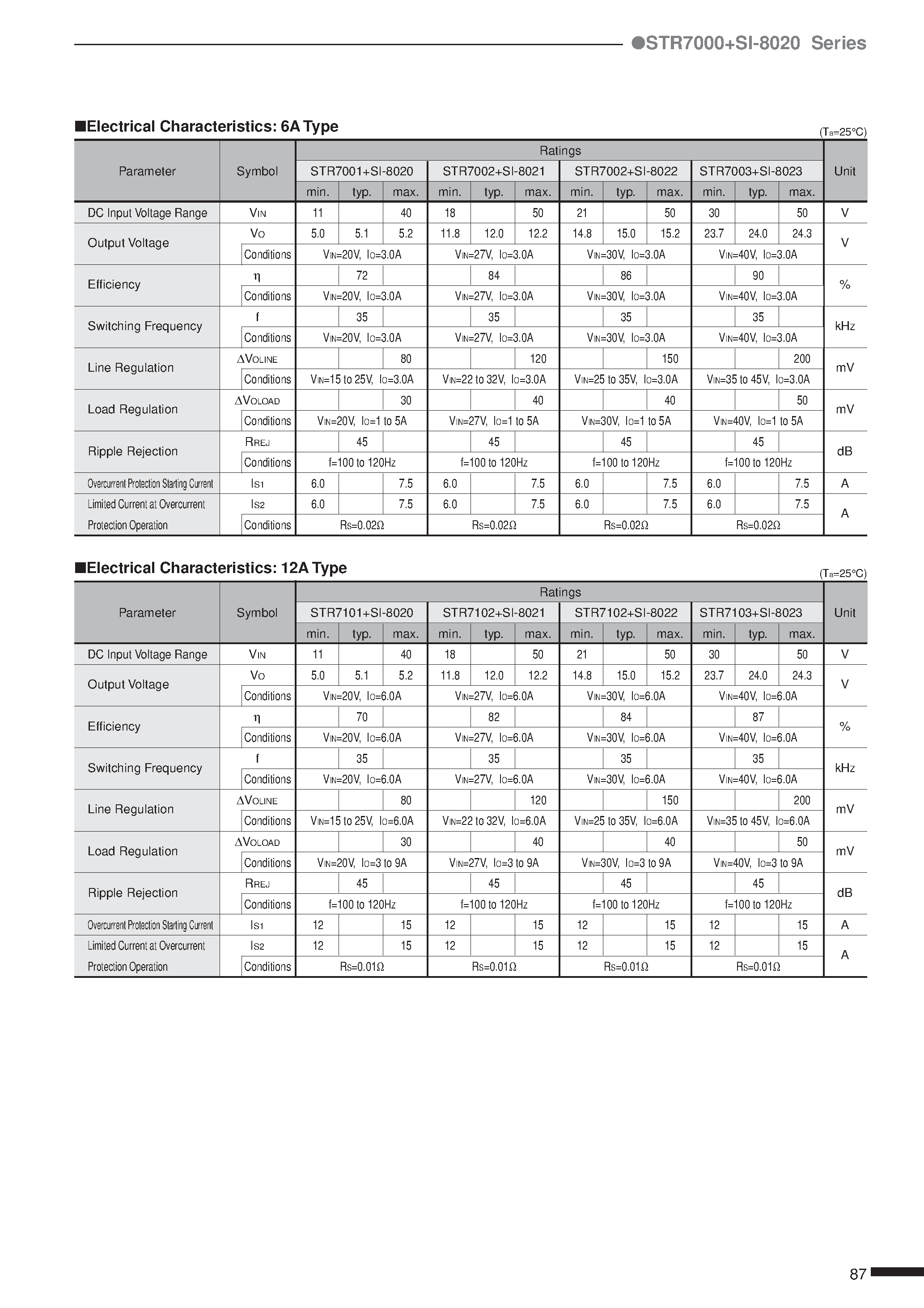

SI-8020-Separate Excitation Switching Type
Producer:Sanken electric
Description:Separate Excitation Switching Type
Others with the same file: SI-8020
Datasheet SI-8020 - Separate Excitation Switching Type page 1
Datasheet SI-8020 - Separate Excitation Switching Type page 2
