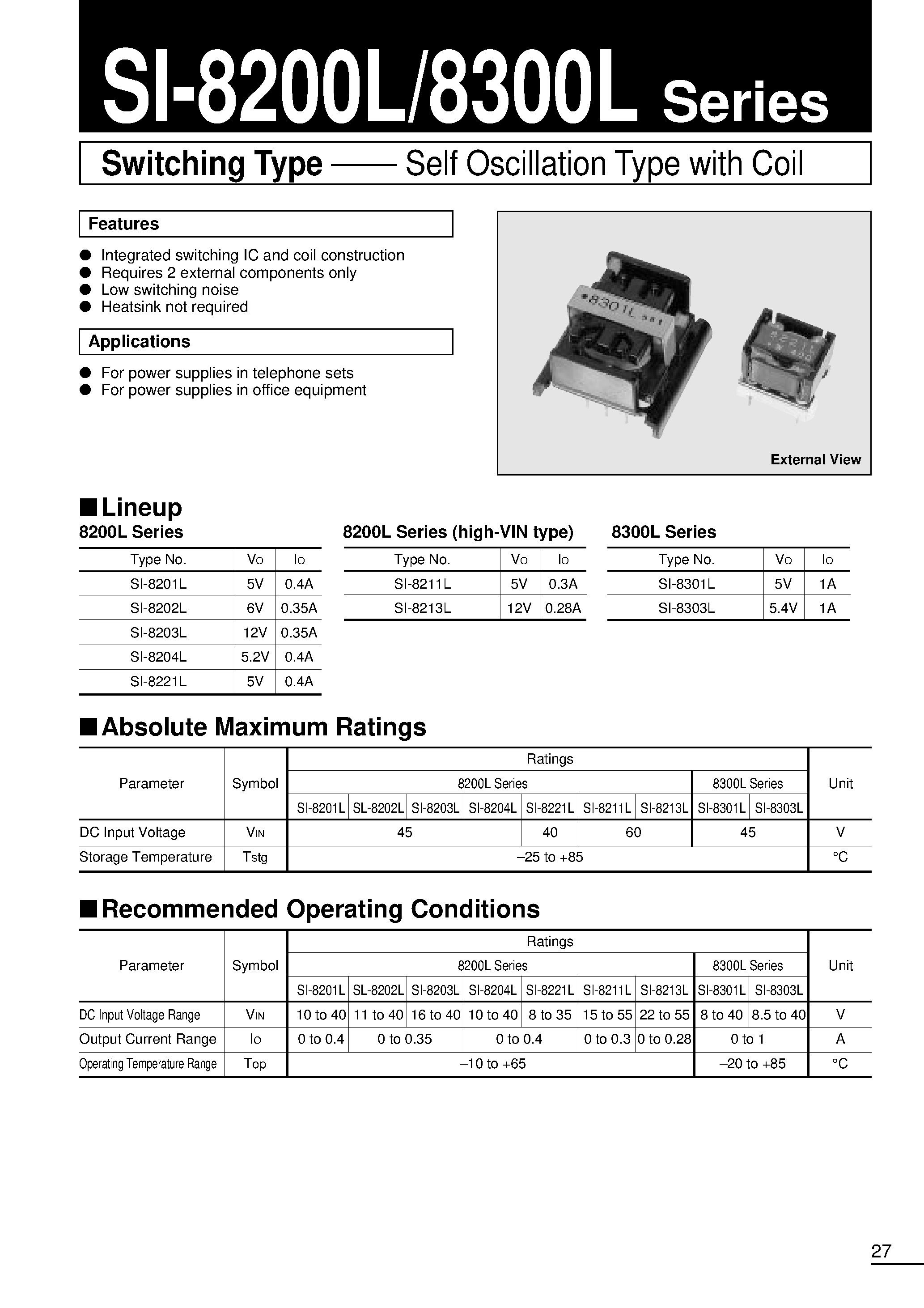

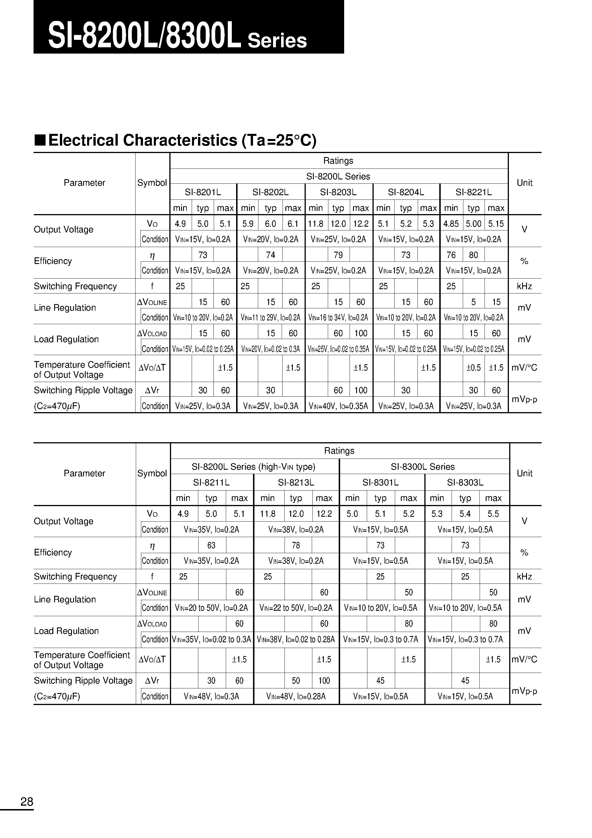

SI-8221-Switching Type(Self Oscillation Type with Coil)
Producer:Sanken electric
Description:Switching Type(Self Oscillation Type with Coil)
Others with the same file: SI-8221
Datasheet SI-8221 - Switching Type(Self Oscillation Type with Coil) page 1
Datasheet SI-8221 - Switching Type(Self Oscillation Type with Coil) page 2
