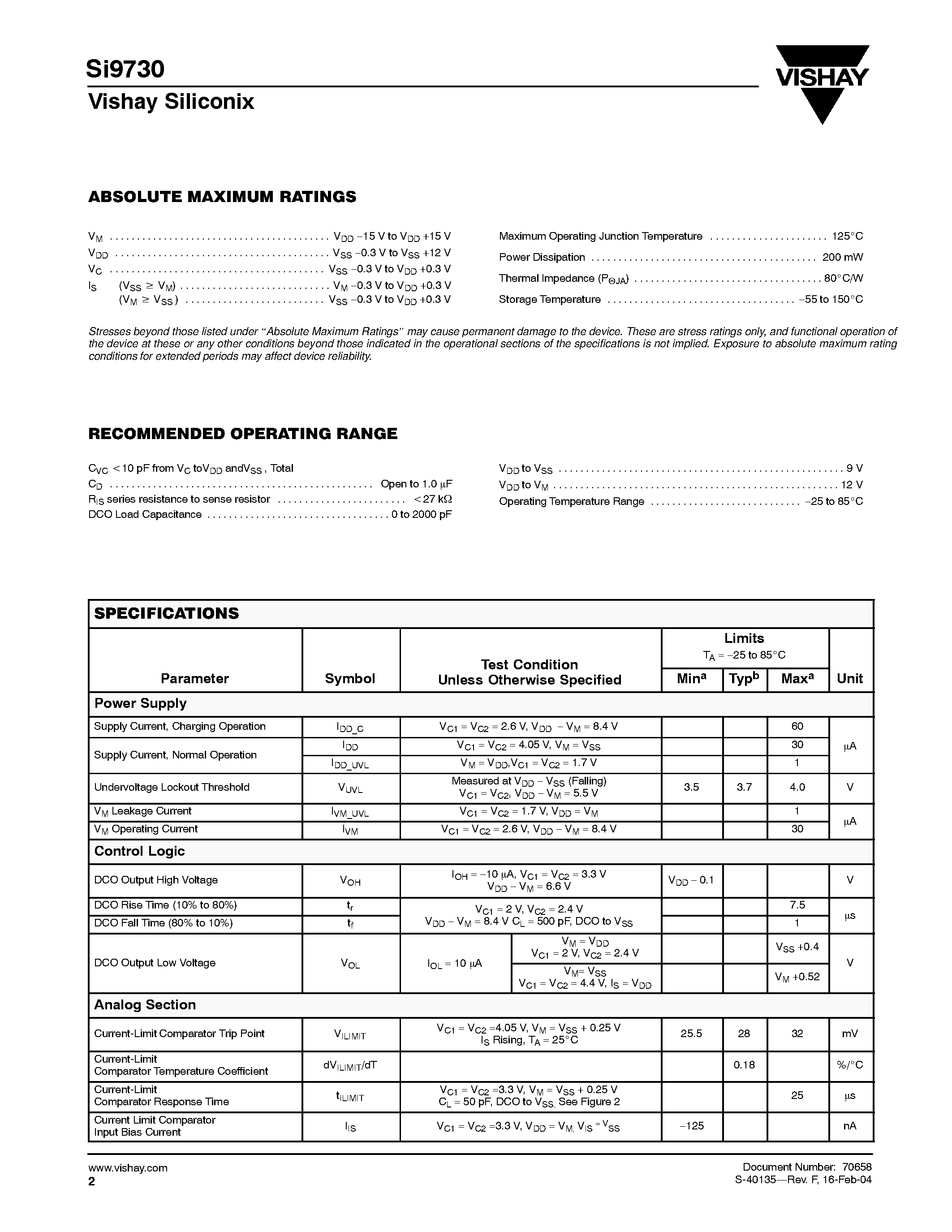

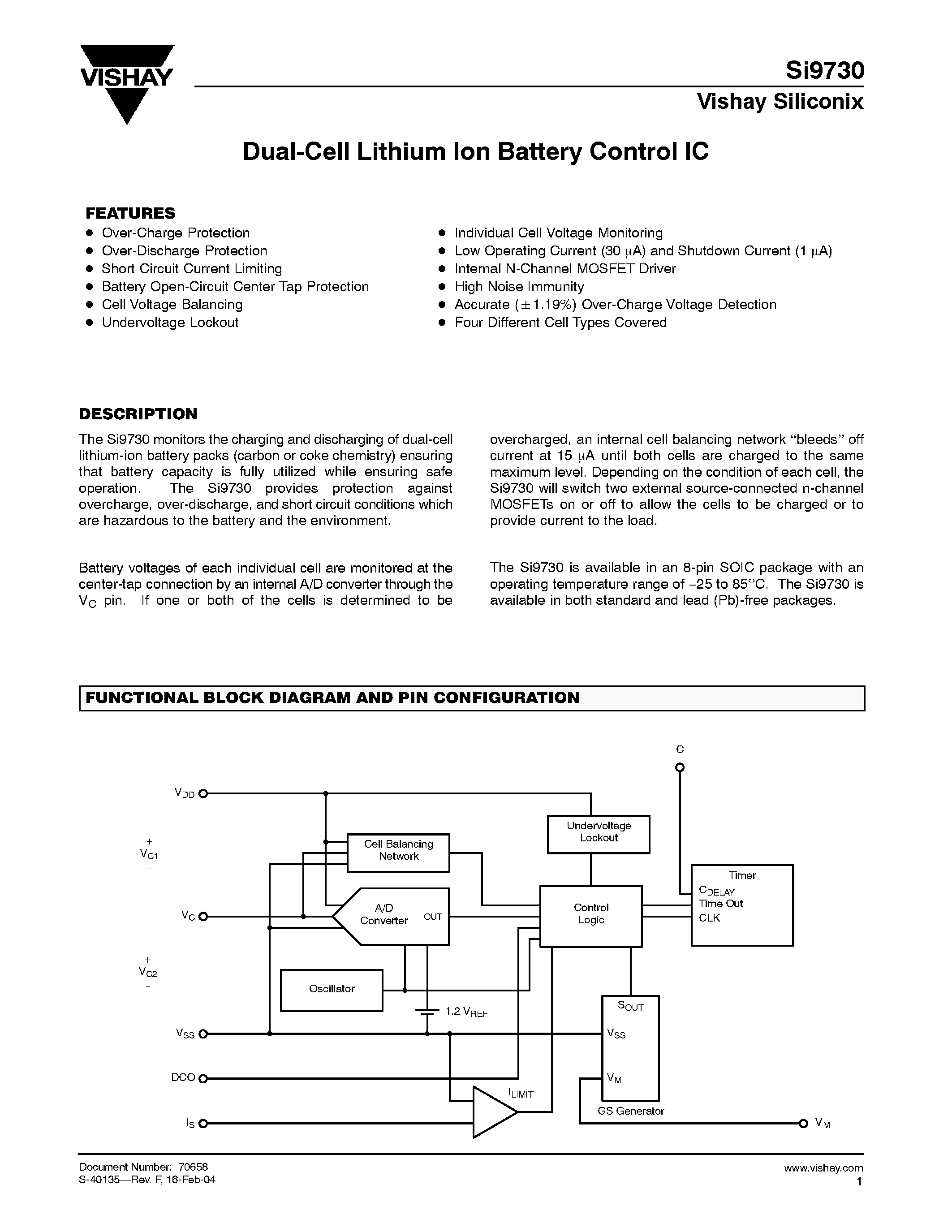

SI9730-Dual-Cell Lithium Ion Battery Control IC
Producer:Vishay Siliconix
Description:Dual-Cell Lithium Ion Battery Control IC
Others with the same file: SI9730
Datasheet SI9730 - Dual-Cell Lithium Ion Battery Control IC page 1
Datasheet SI9730 - Dual-Cell Lithium Ion Battery Control IC page 2
