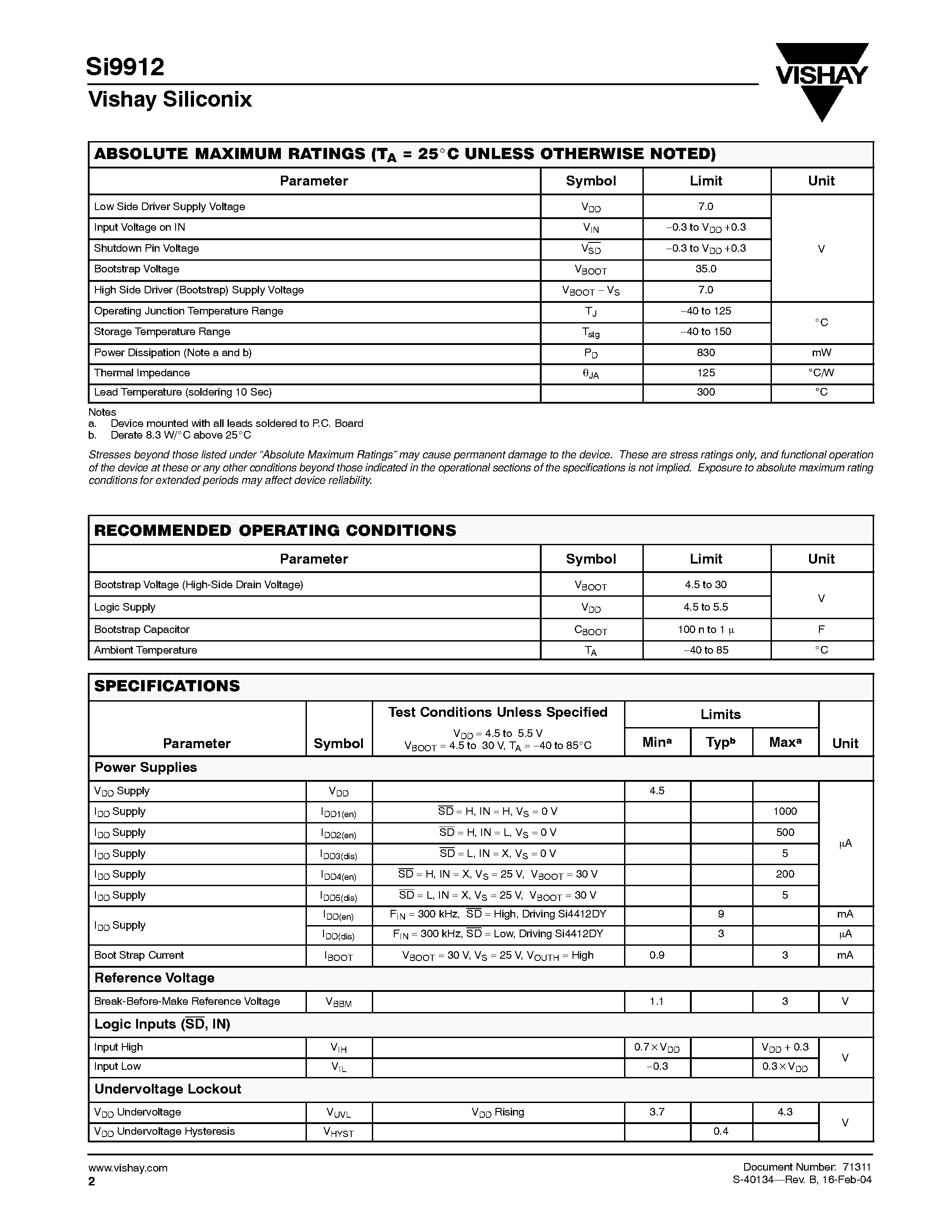

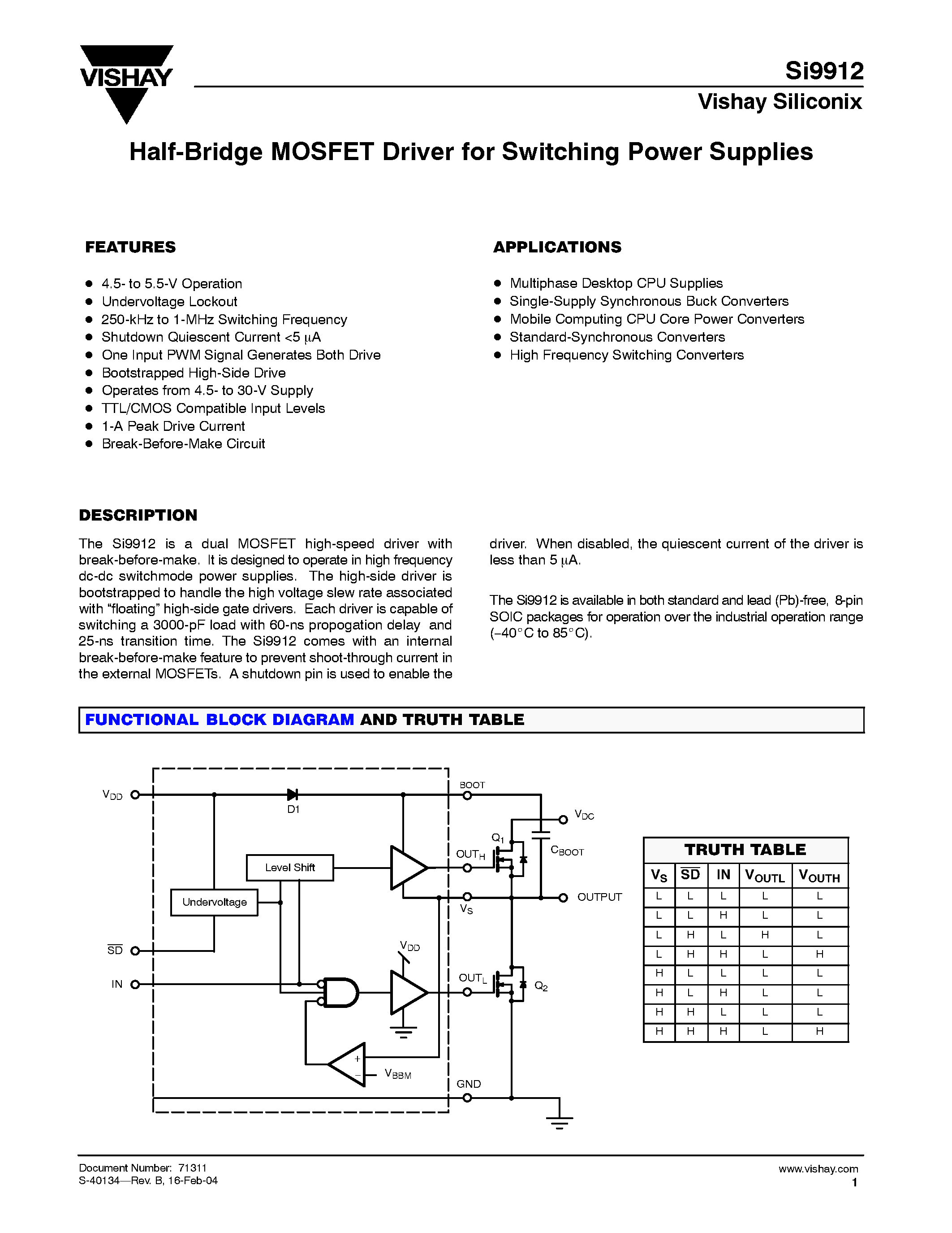

SI9912-Half-Bridge MOSFET Driver for Switching Power Supplies
Producer:Vishay Siliconix
Description:Half-Bridge MOSFET Driver for Switching Power Supplies
Others with the same file: SI9912
Datasheet SI9912 - Half-Bridge MOSFET Driver for Switching Power Supplies page 1
Datasheet SI9912 - Half-Bridge MOSFET Driver for Switching Power Supplies page 2
