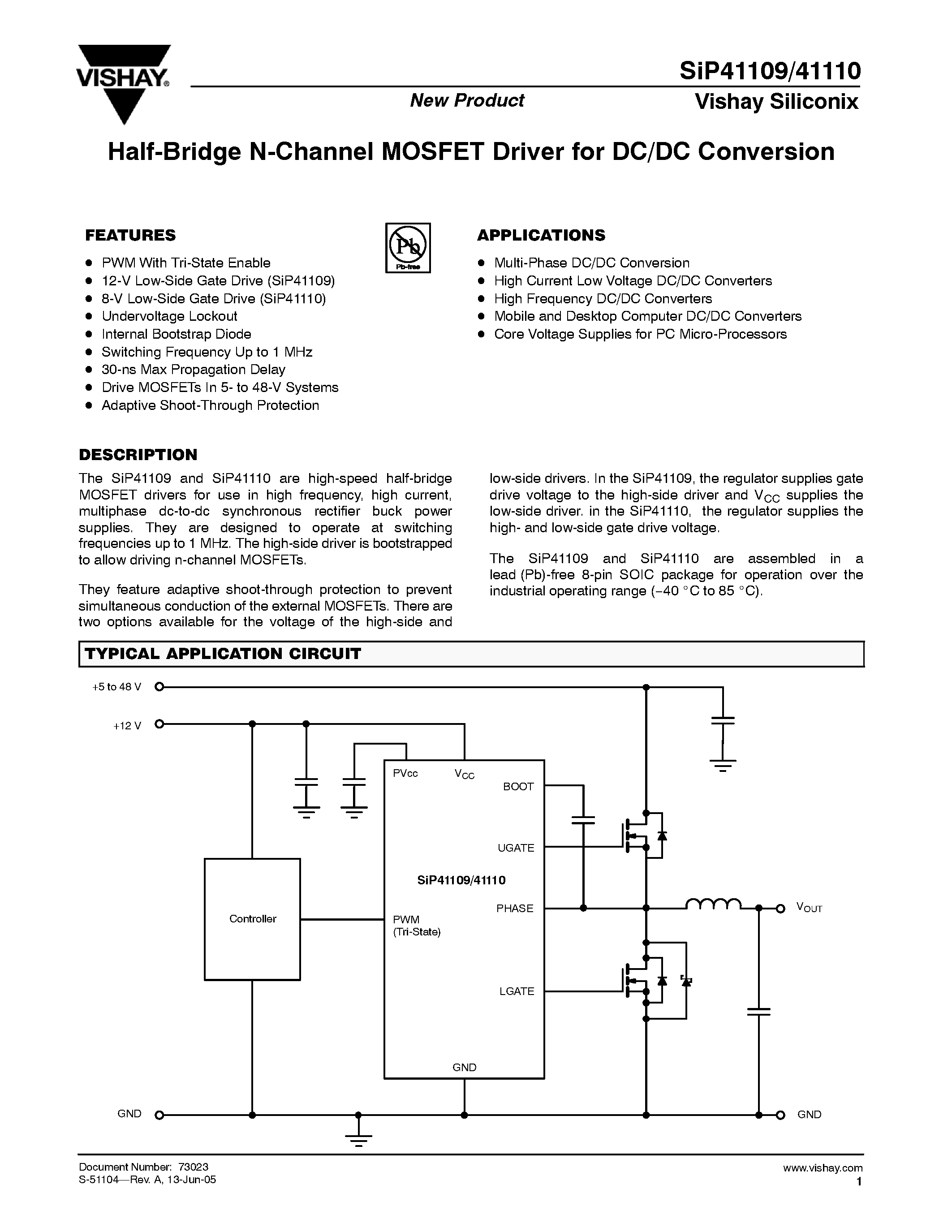

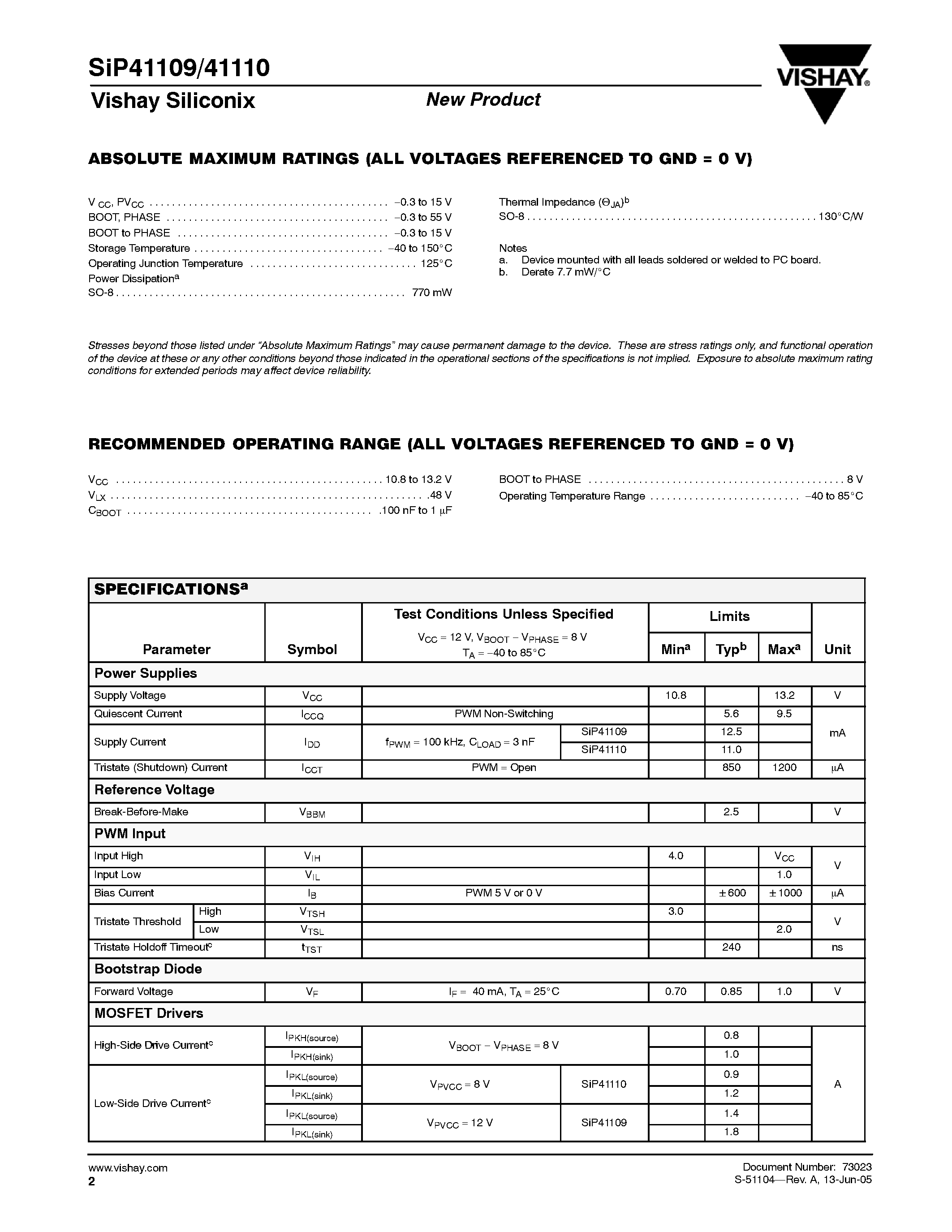

SIP41109-(SIP41109 / SIP41110) Half-Bridge N-Channel MOSFET Driver for DC/DC Conversion
Producer:Vishay Siliconix
Description:(SIP41109 / SIP41110) Half-Bridge N-Channel MOSFET Driver for DC/DC Conversion
Others with the same file: SIP41109 | SIP41110
