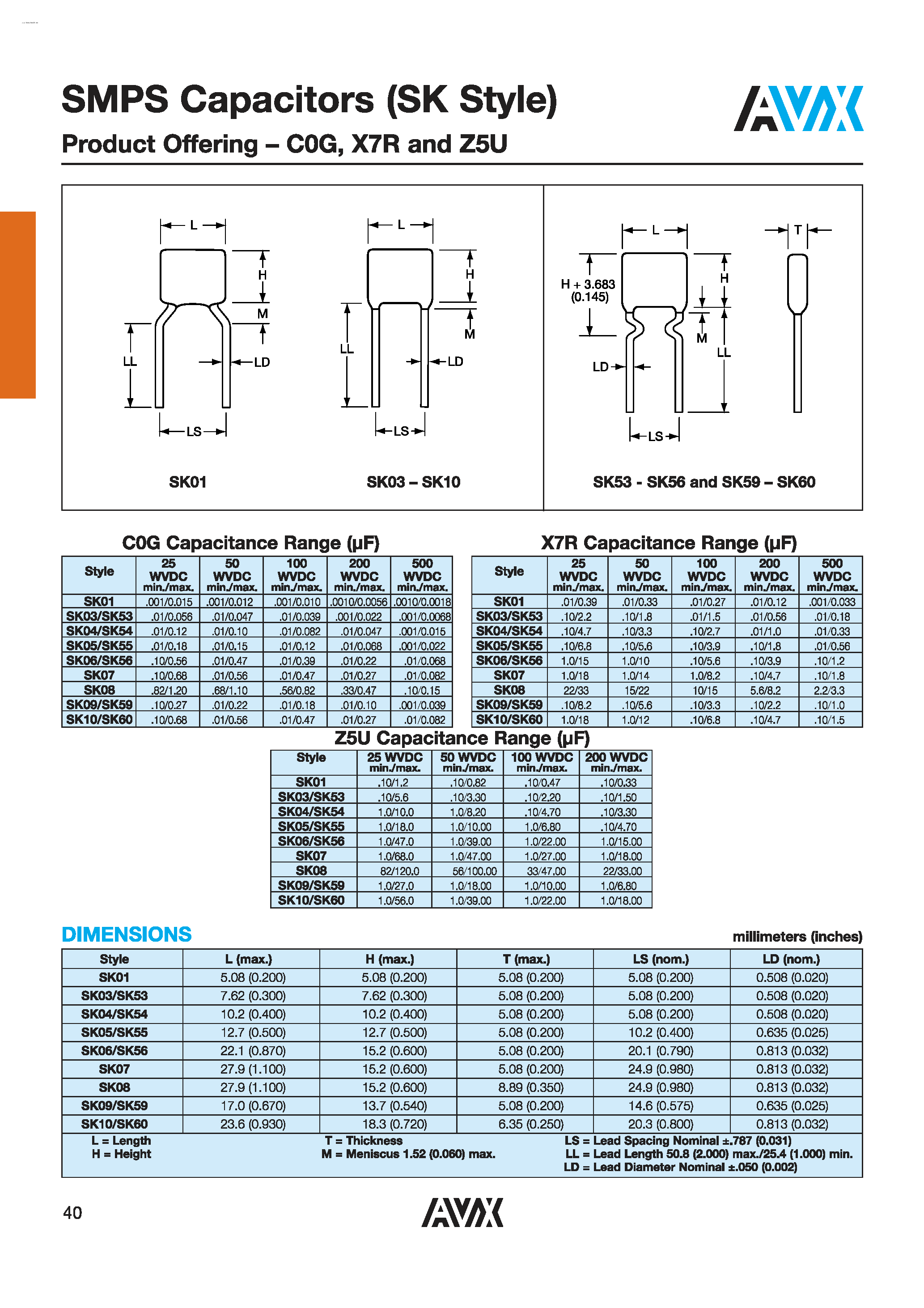

Datasheet SK011AxxxxxA - SMPS Capacitors page 1

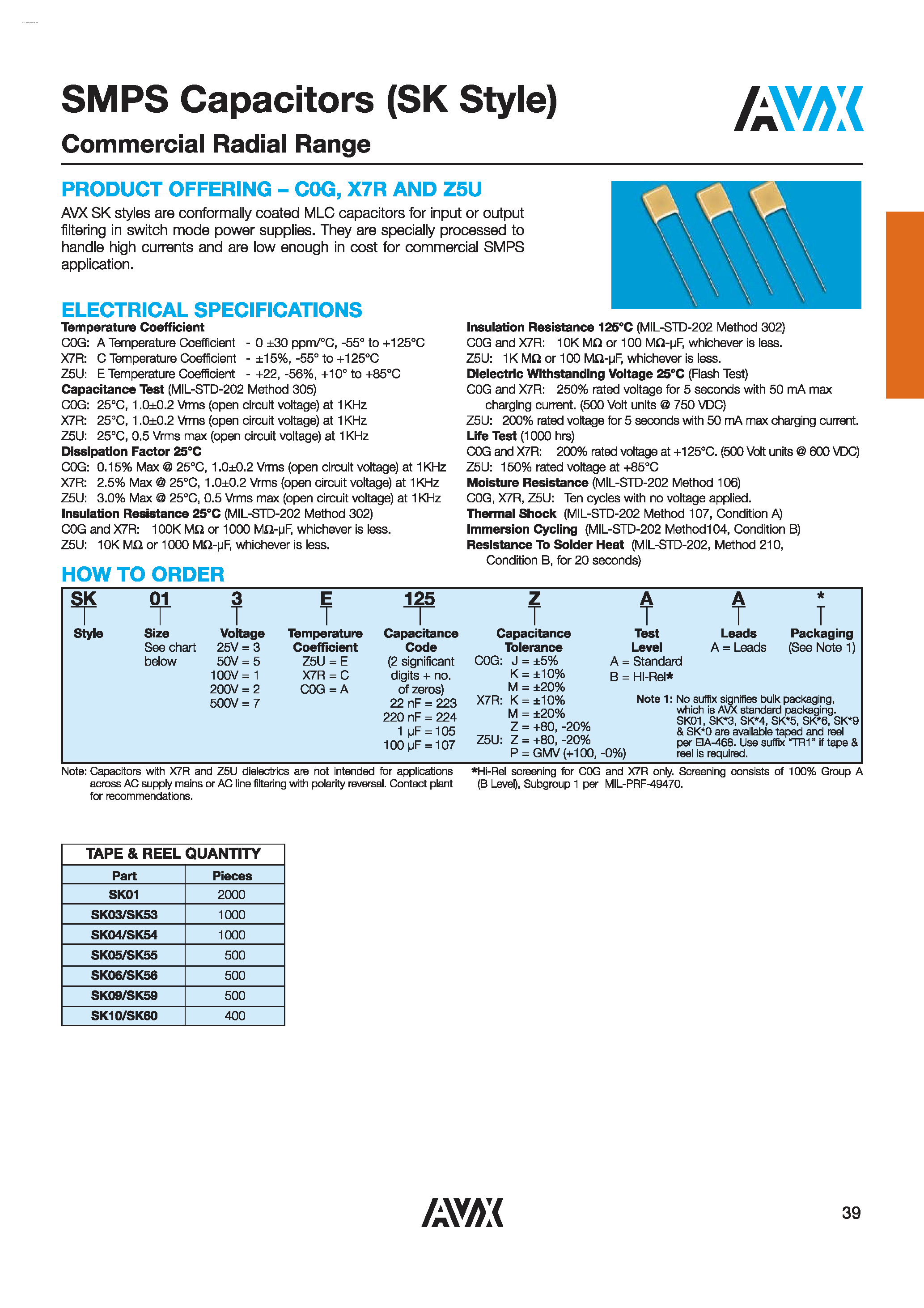

Datasheet SK011AxxxxxA - SMPS Capacitors page 2
