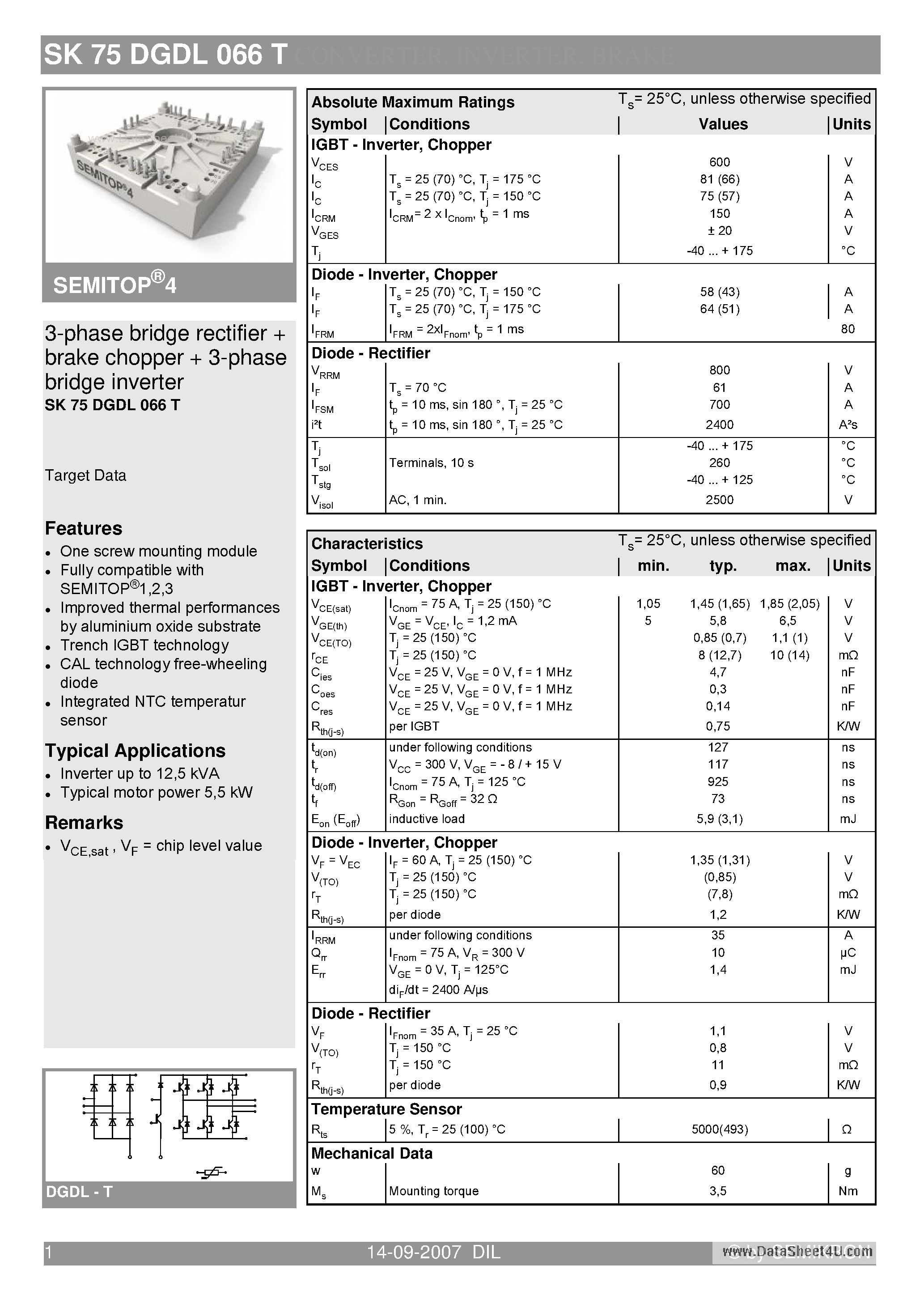

SK75DGDL066T-3-phase bridge rectifier brake chopper 3-phase bridge inverter
Producer:Semikron International
Description:3-phase bridge rectifier brake chopper 3-phase bridge inverter
Others with the same file: SK75DGDL066T
Datasheet SK75DGDL066T - 3-phase bridge rectifier brake chopper 3-phase bridge inverter page 1

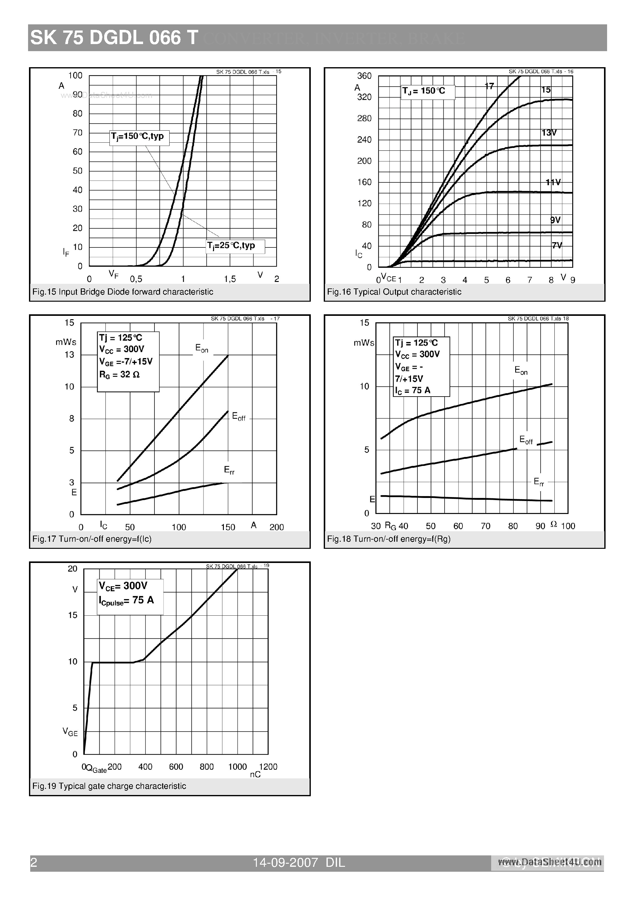

Datasheet SK75DGDL066T - 3-phase bridge rectifier brake chopper 3-phase bridge inverter page 2
