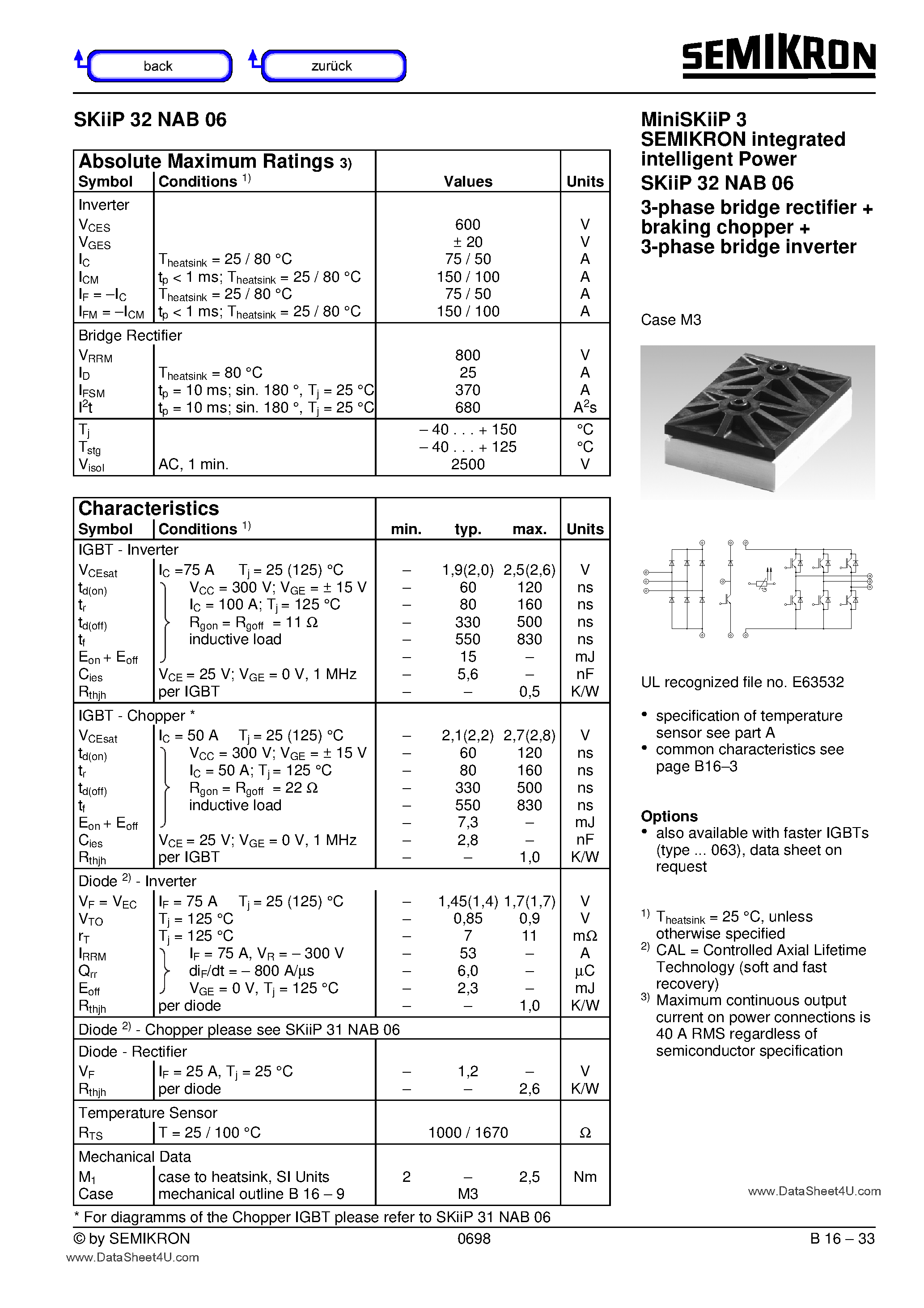

Datasheet SKIIP32NAB06 - 3-phase bridge rectifier + braking chopper + 3-phase bridge inverter page 1

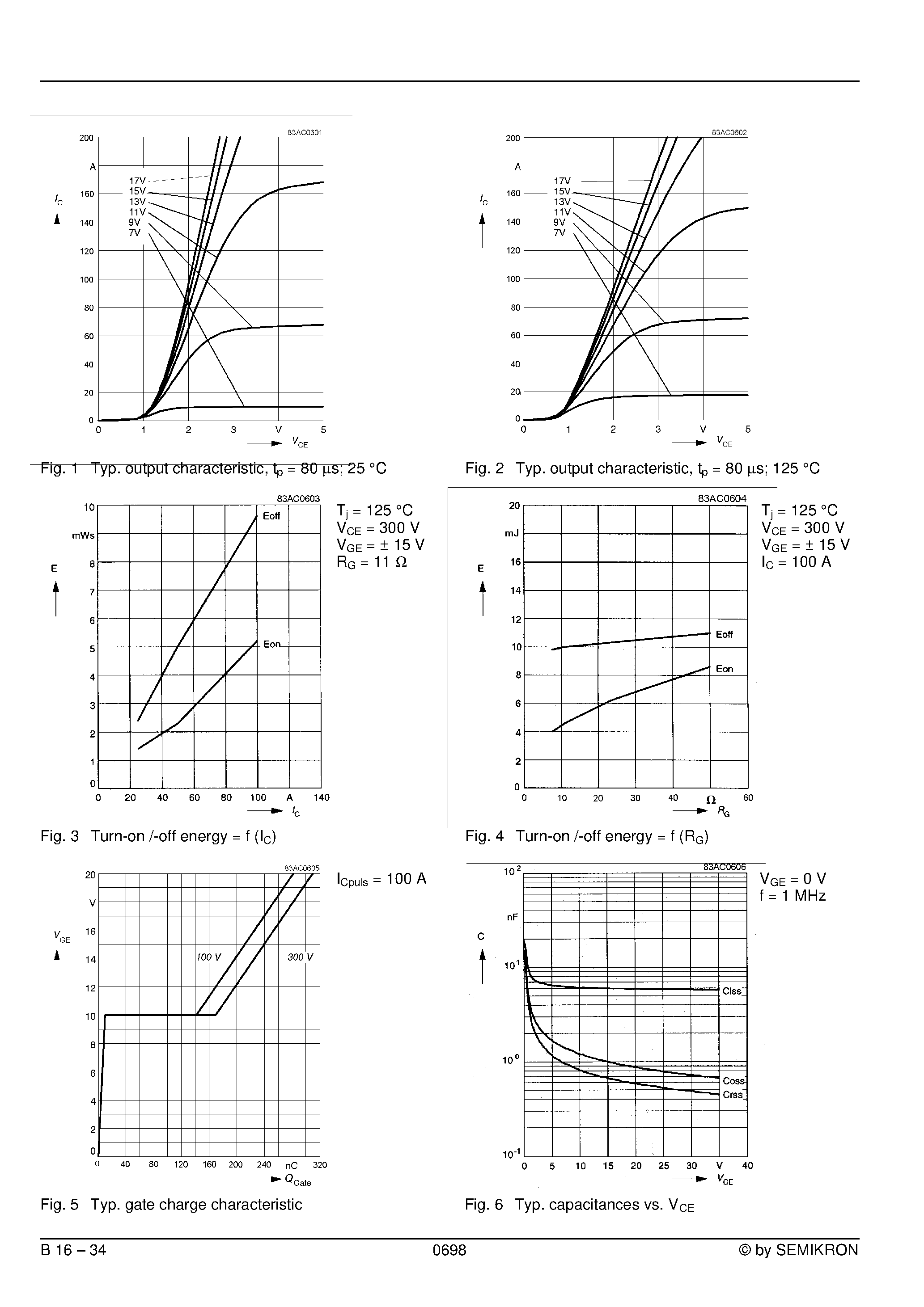

Datasheet SKIIP32NAB06 - 3-phase bridge rectifier + braking chopper + 3-phase bridge inverter page 2
