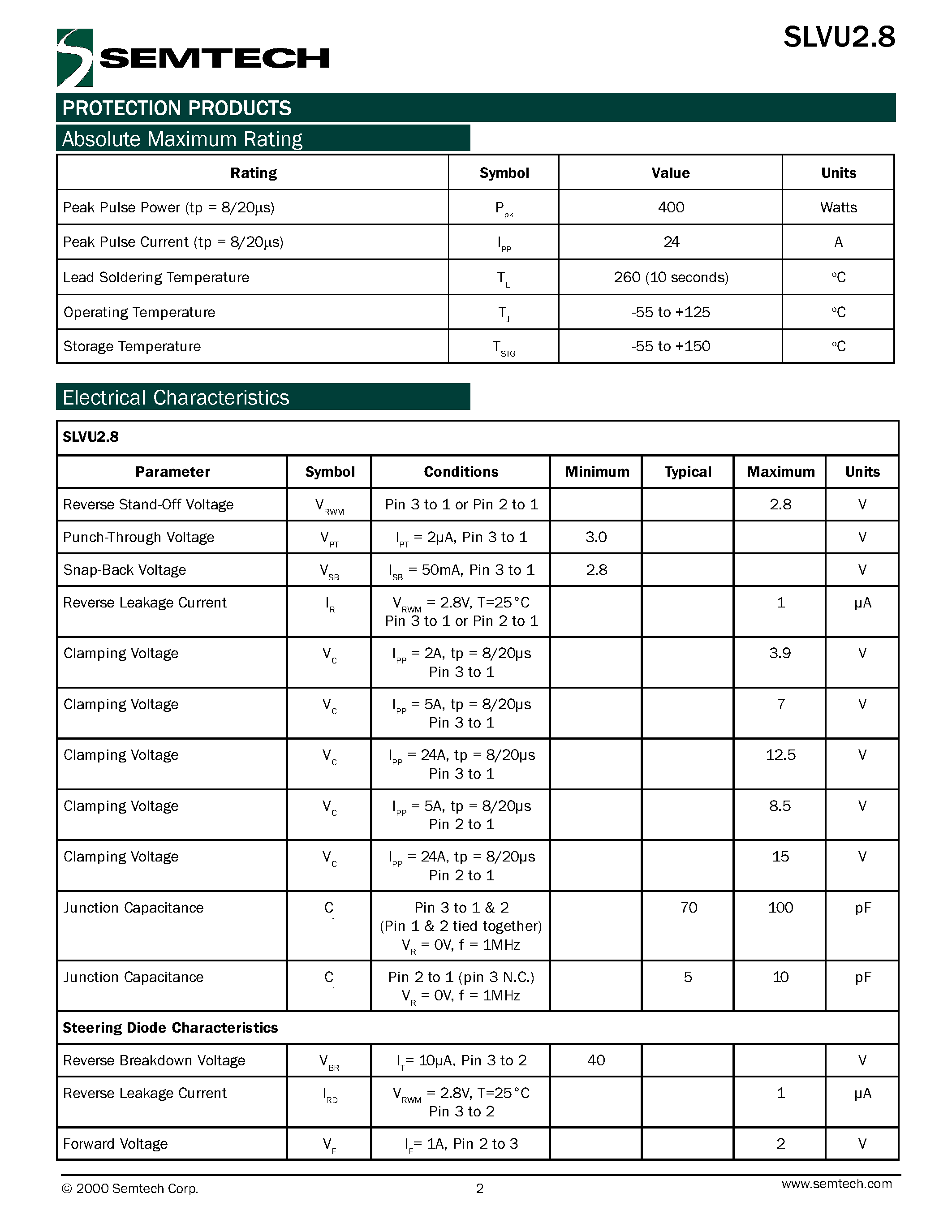

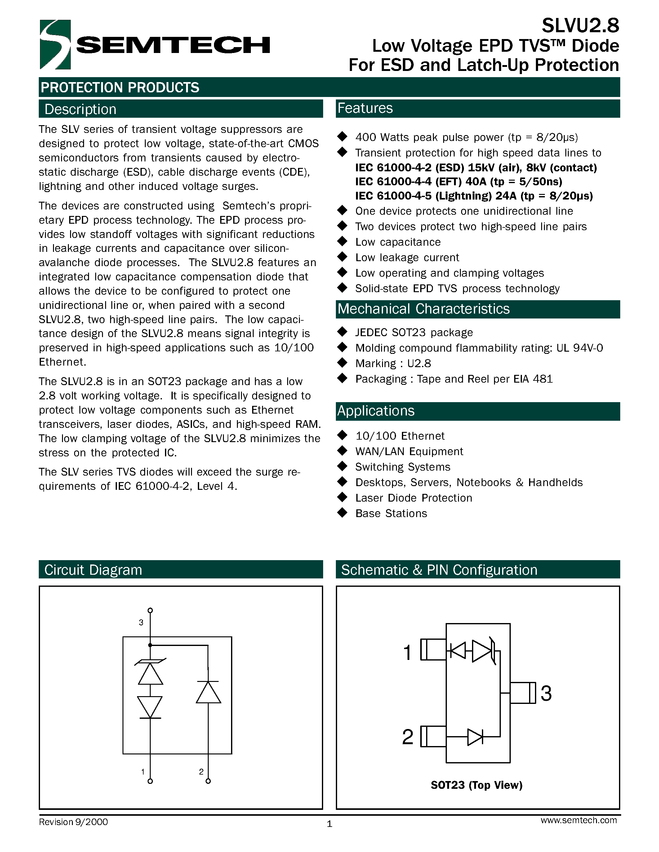

SLVU2.8-Low Voltage EPD TVS Diodes For ESD and Latch-Up Protection
Producer:Semtech Corporation
Description:Low Voltage EPD TVS Diodes For ESD and Latch-Up Protection
Others with the same file: SLVU2.8
Datasheet SLVU2.8 - Low Voltage EPD TVS Diodes For ESD and Latch-Up Protection page 1
Datasheet SLVU2.8 - Low Voltage EPD TVS Diodes For ESD and Latch-Up Protection page 2
