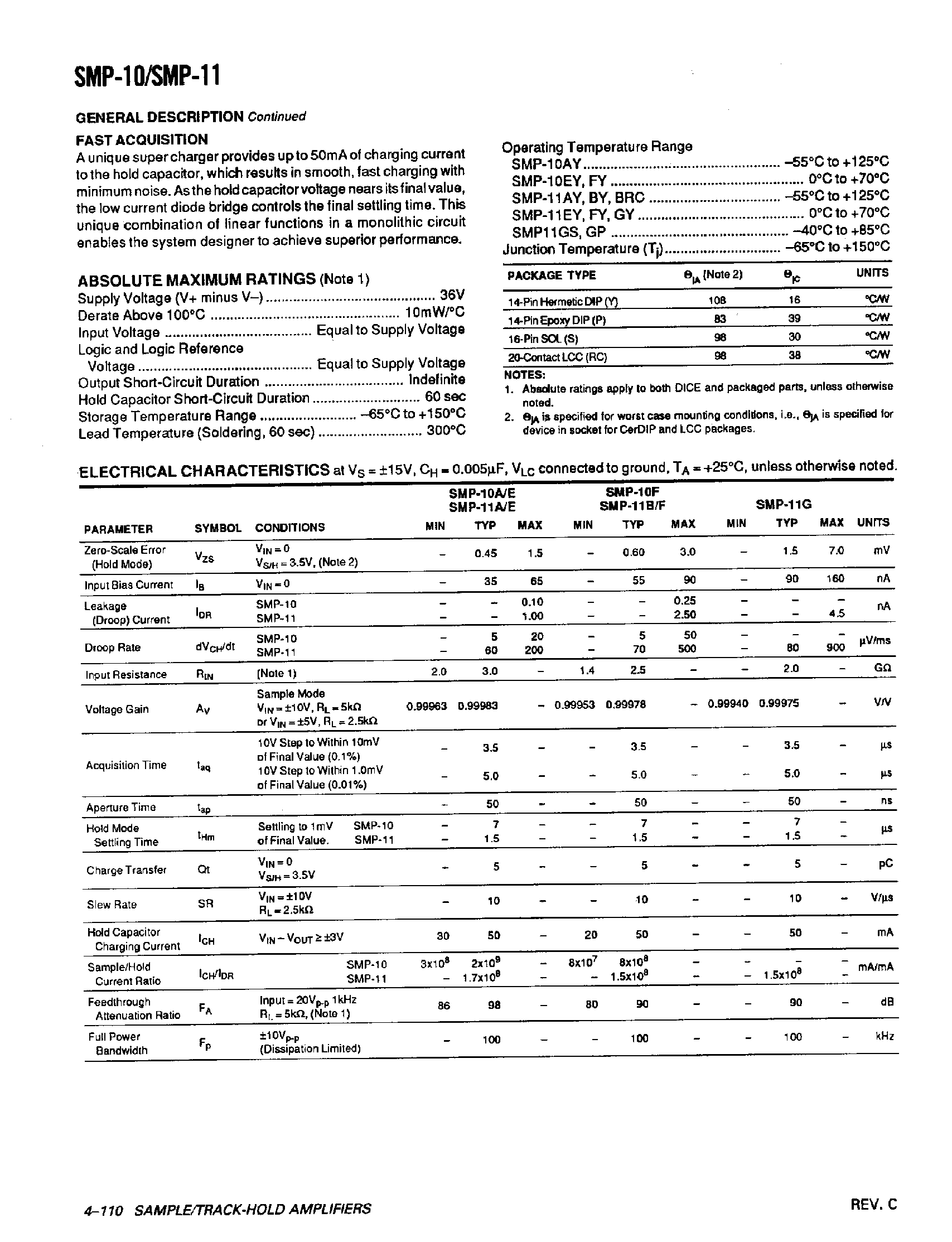

SMP11G-Low Droop Rate / Accurate / Sample and Hold Amplifiers
Producer:Analog Devices
Description:Low Droop Rate / Accurate / Sample and Hold Amplifiers
Others with the same file: SMP11G
Datasheet SMP11G - Low Droop Rate / Accurate / Sample and Hold Amplifiers page 1
Datasheet SMP11G - Low Droop Rate / Accurate / Sample and Hold Amplifiers page 2
