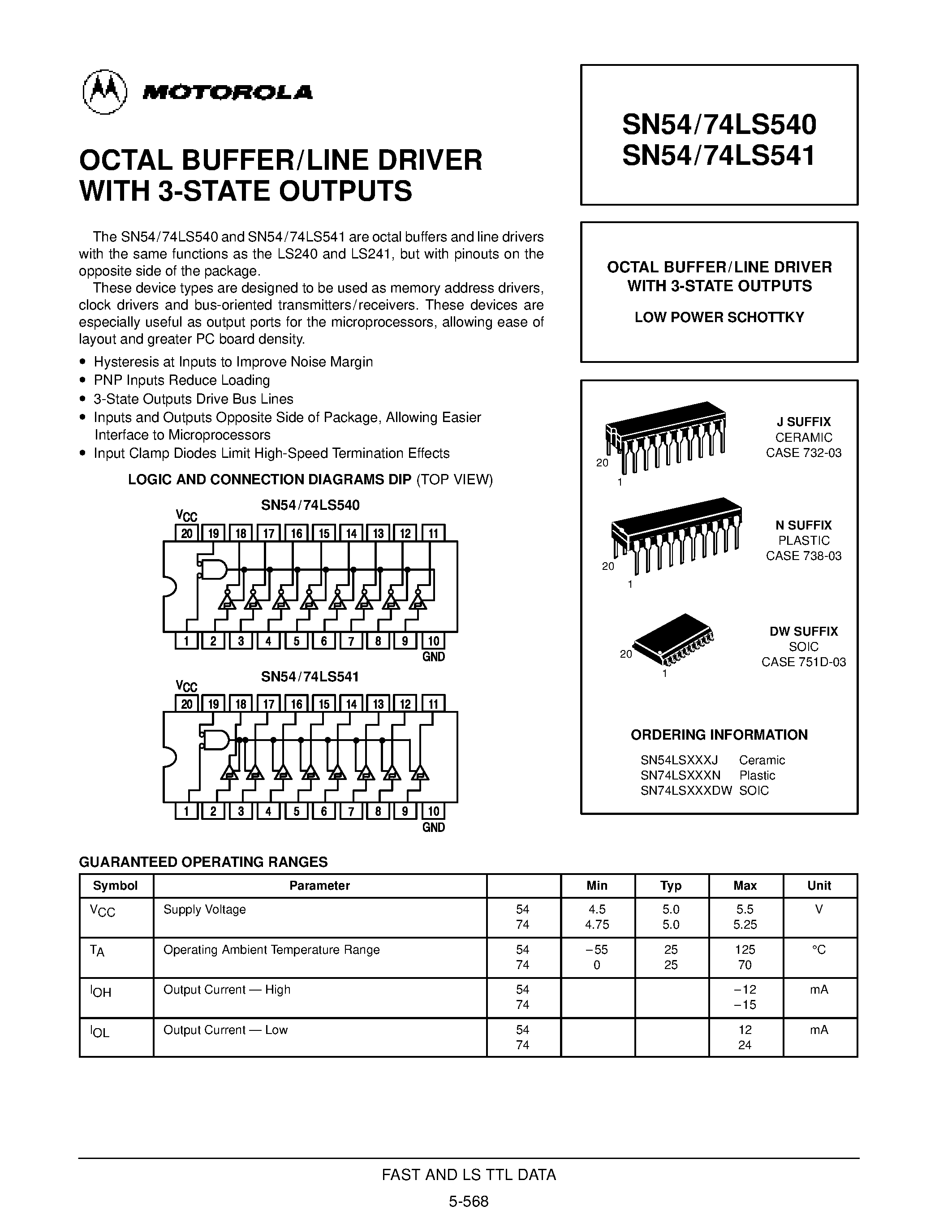

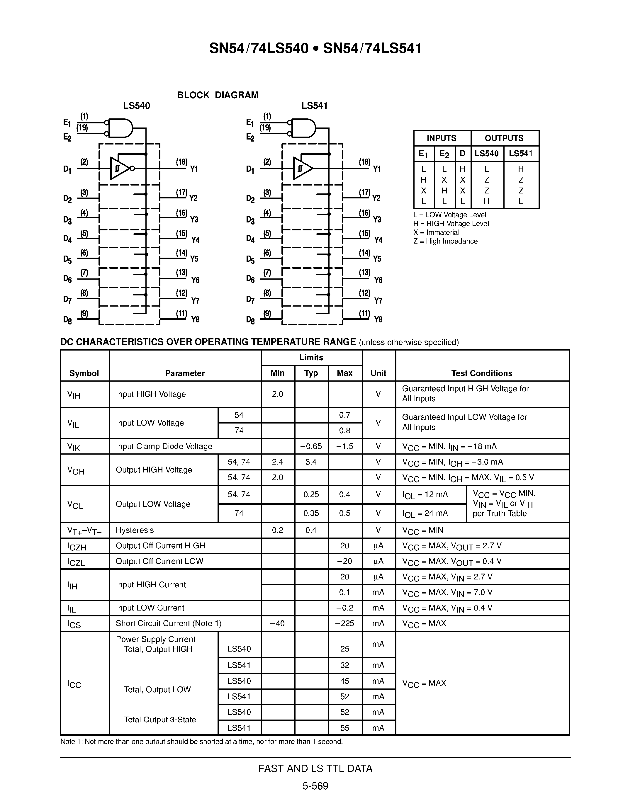

SN54LS240J-OCTAL BUFFER/LINE DRIVER WITH 3-STATE OUTPUTS
Producer:Motorola Inc
Description:OCTAL BUFFER/LINE DRIVER WITH 3-STATE OUTPUTS
Others with the same file: SN54LS240J
Datasheet SN54LS240J - OCTAL BUFFER/LINE DRIVER WITH 3-STATE OUTPUTS page 1
Datasheet SN54LS240J - OCTAL BUFFER/LINE DRIVER WITH 3-STATE OUTPUTS page 2
