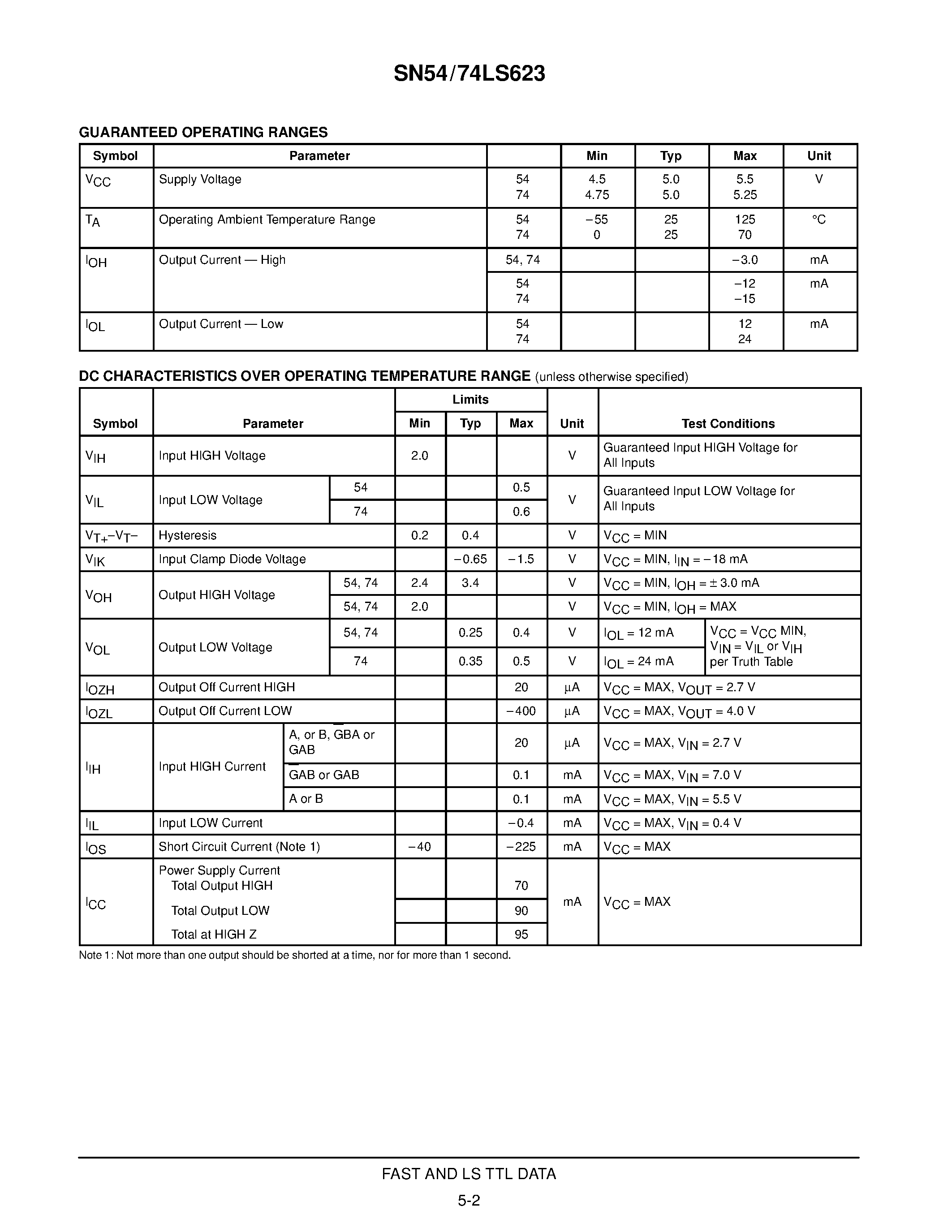

SN54LS623-OCTAL BUS TRANSCEIVER WITH 3-STATE OUTPUT
Producer:Motorola Inc
Description:OCTAL BUS TRANSCEIVER WITH 3-STATE OUTPUT
