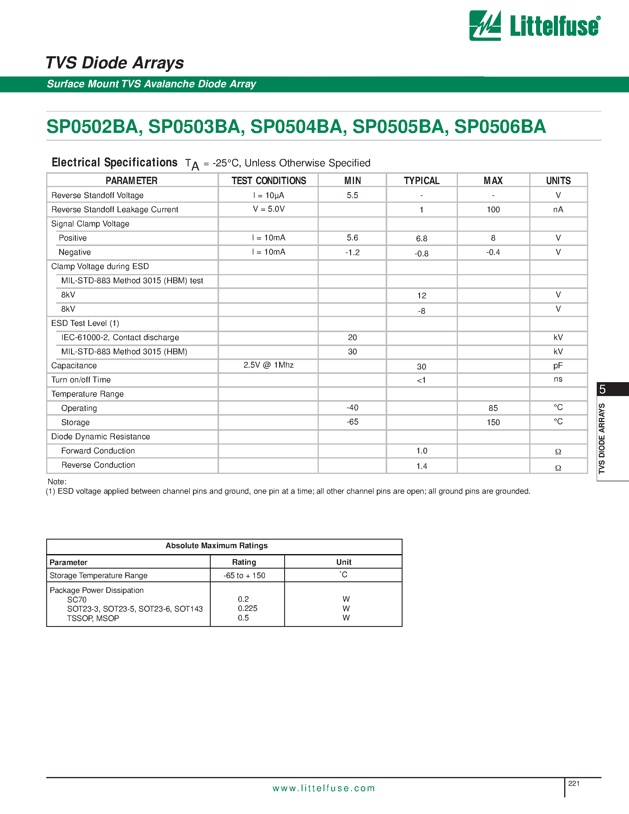

Datasheet SP0502BA - (SP0502BA - SP0506BA) TVS Diode Arrays - Surface Mount TVS Avalanche Diode Array page 1

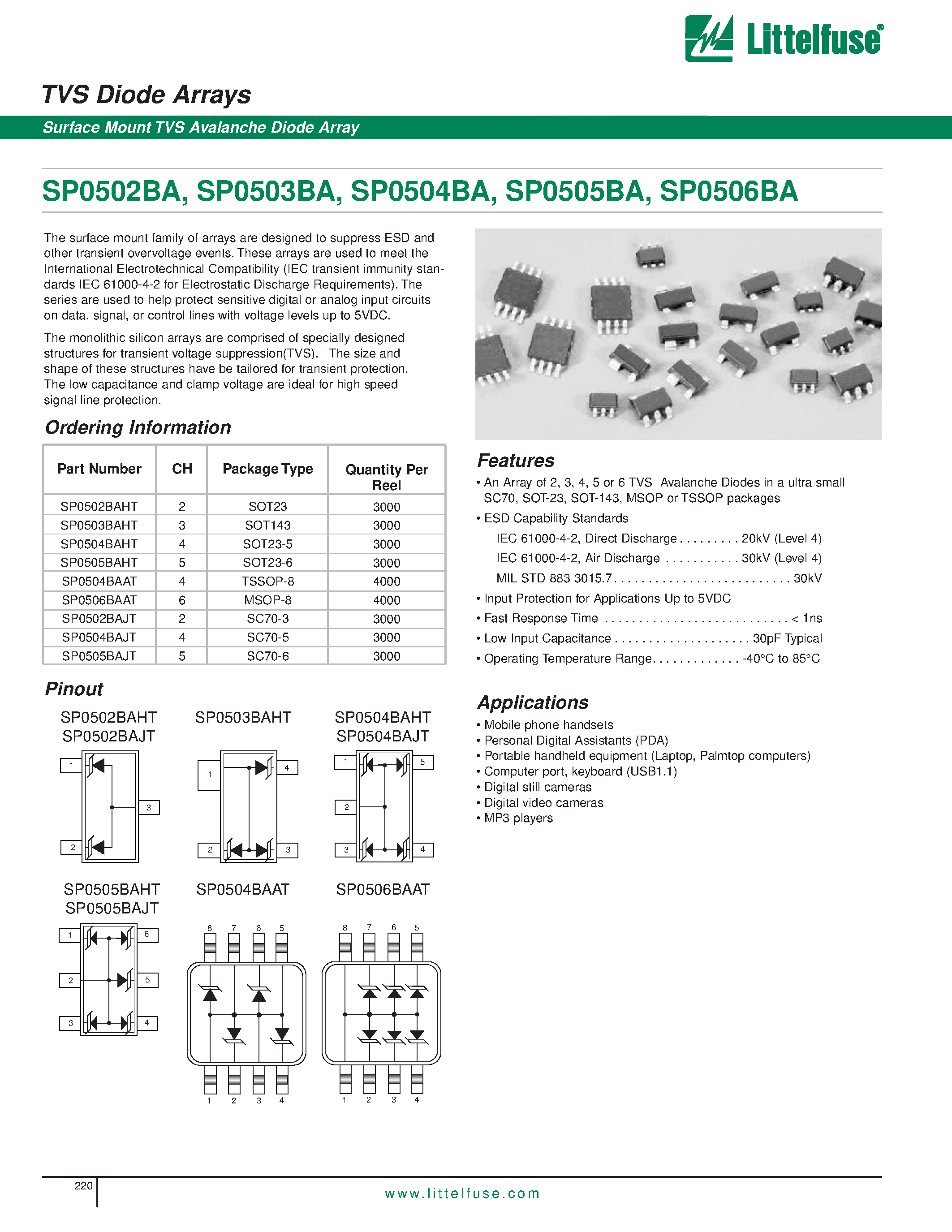

Datasheet SP0502BA - (SP0502BA - SP0506BA) TVS Diode Arrays - Surface Mount TVS Avalanche Diode Array page 2
