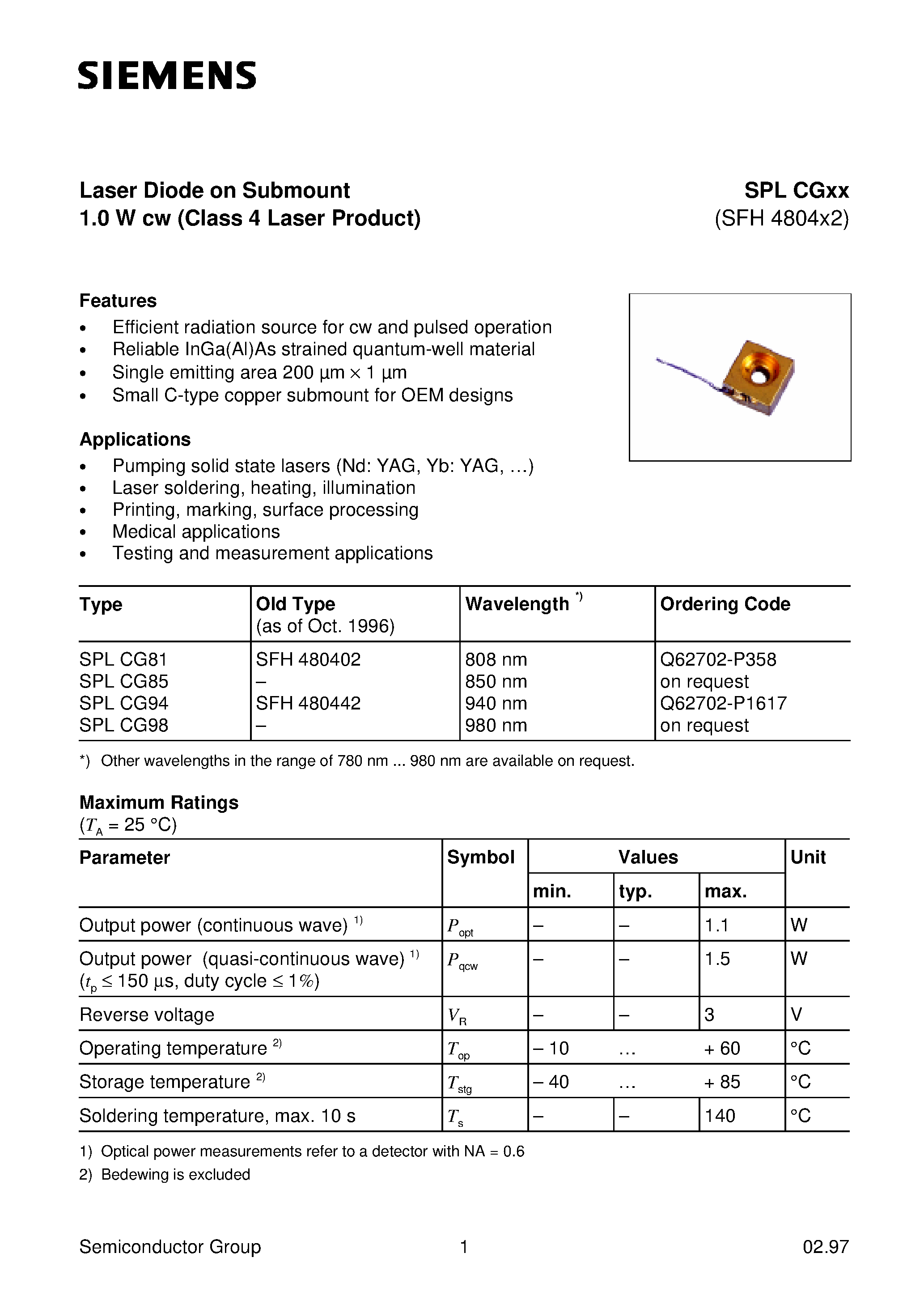

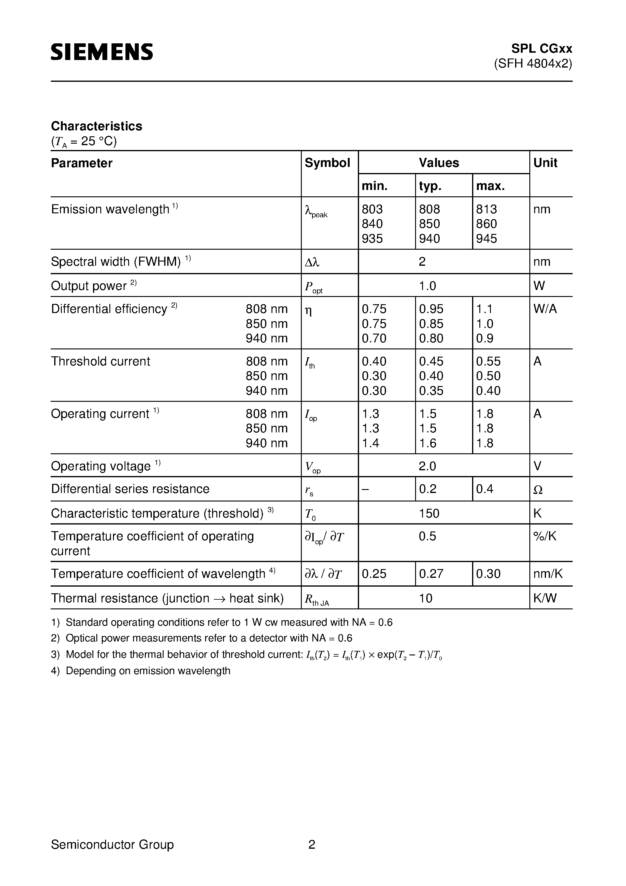

SPLCGxxx-Laser Diode on Submount 1.0 W cw Class 4 Laser Product
Producer:Siemens Semiconductor
Description:Laser Diode on Submount 1.0 W cw Class 4 Laser Product
Others with the same file: SPLCGxxx
Datasheet SPLCGxxx - Laser Diode on Submount 1.0 W cw Class 4 Laser Product page 1
Datasheet SPLCGxxx - Laser Diode on Submount 1.0 W cw Class 4 Laser Product page 2
