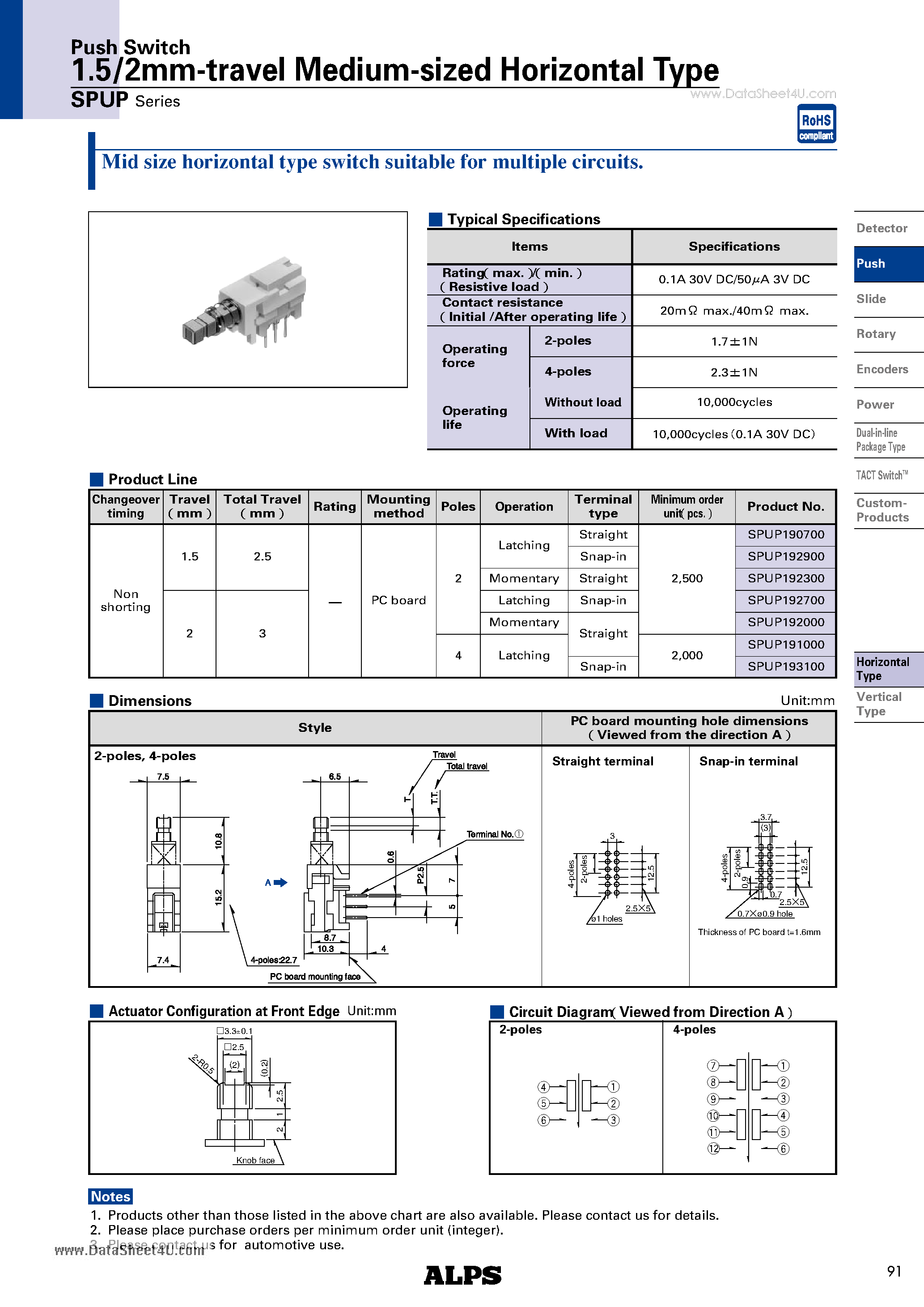

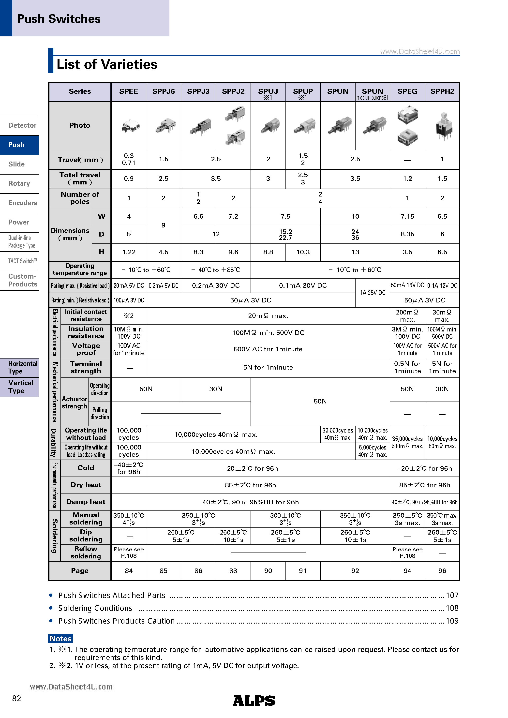

SPUP-1.5/2mm-travel Medium-sized Horizontal Type
Producer:ALPS ELECTRIC
Description:1.5/2mm-travel Medium-sized Horizontal Type
Others with the same file: SPUP
Datasheet SPUP - 1.5/2mm-travel Medium-sized Horizontal Type page 1
Datasheet SPUP - 1.5/2mm-travel Medium-sized Horizontal Type page 2
