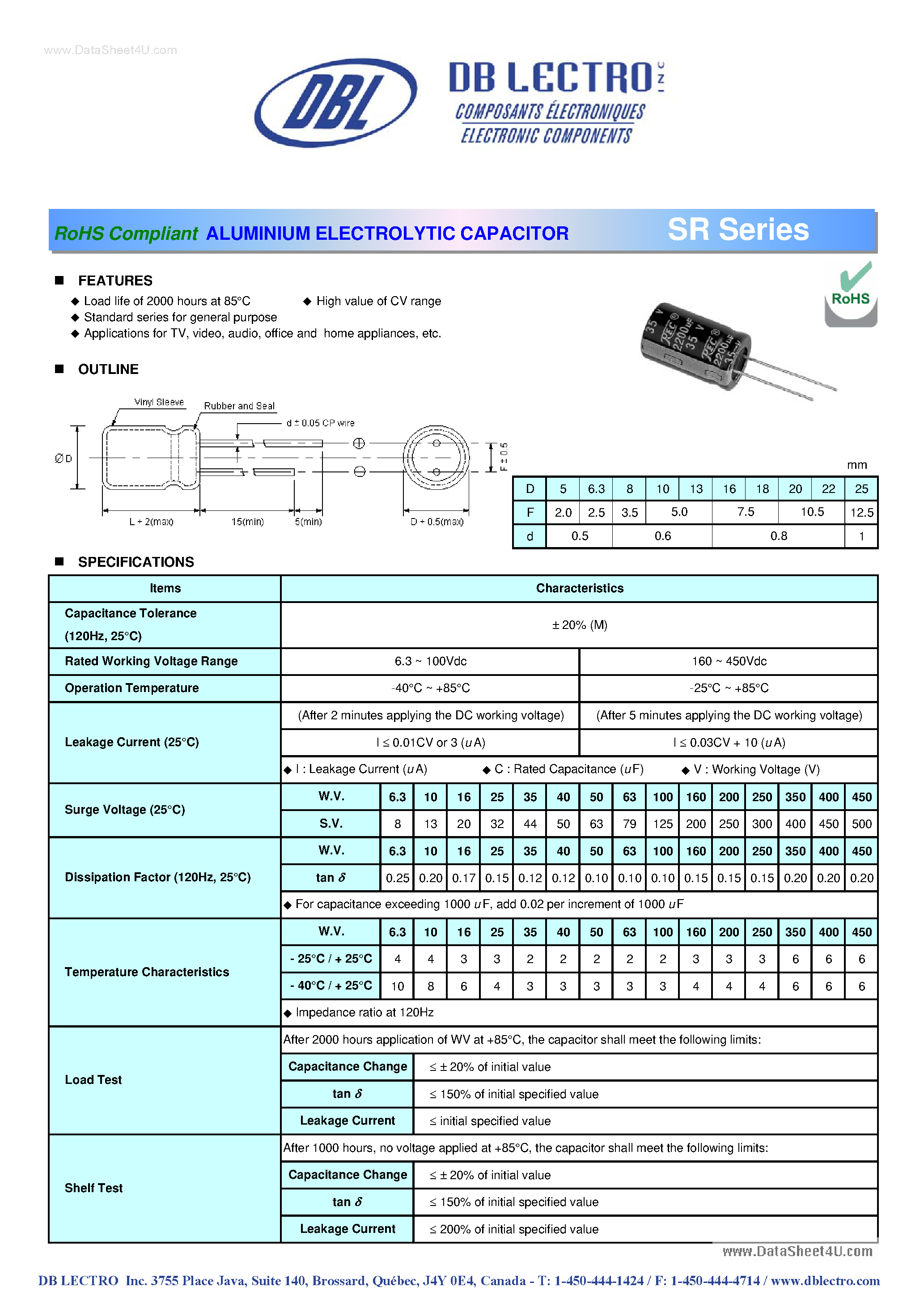

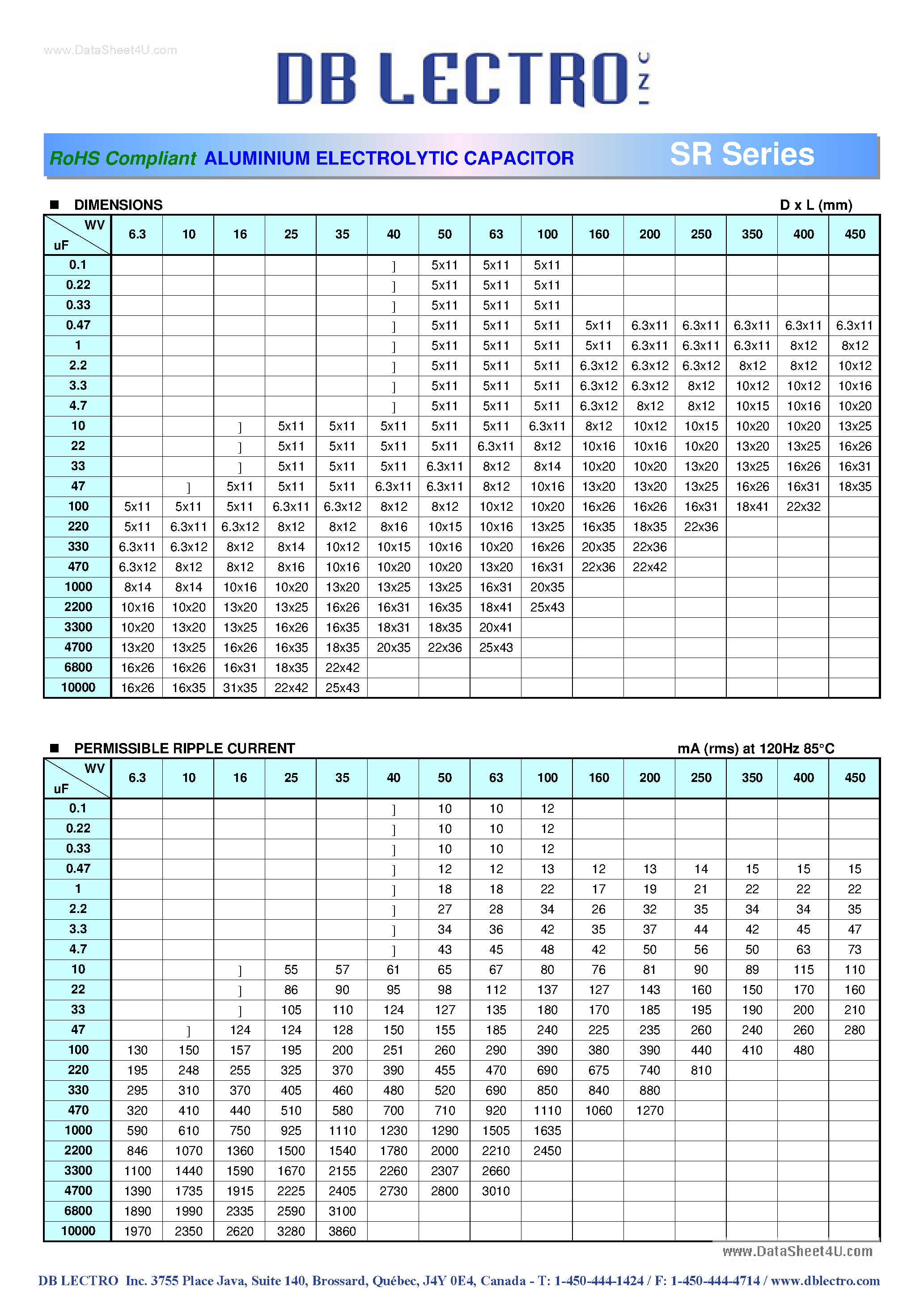

SR2A100-(SR Series) ALUMINIUM ELECTROLYTIC CAPACITOR
Producer:DB Lectro
Description:(SR Series) ALUMINIUM ELECTROLYTIC CAPACITOR
Others with the same file: SR2A100 | SR2A101
SR2A101KC
Datasheet SR2A100 - (SR Series) ALUMINIUM ELECTROLYTIC CAPACITOR page 1
Datasheet SR2A100 - (SR Series) ALUMINIUM ELECTROLYTIC CAPACITOR page 2
