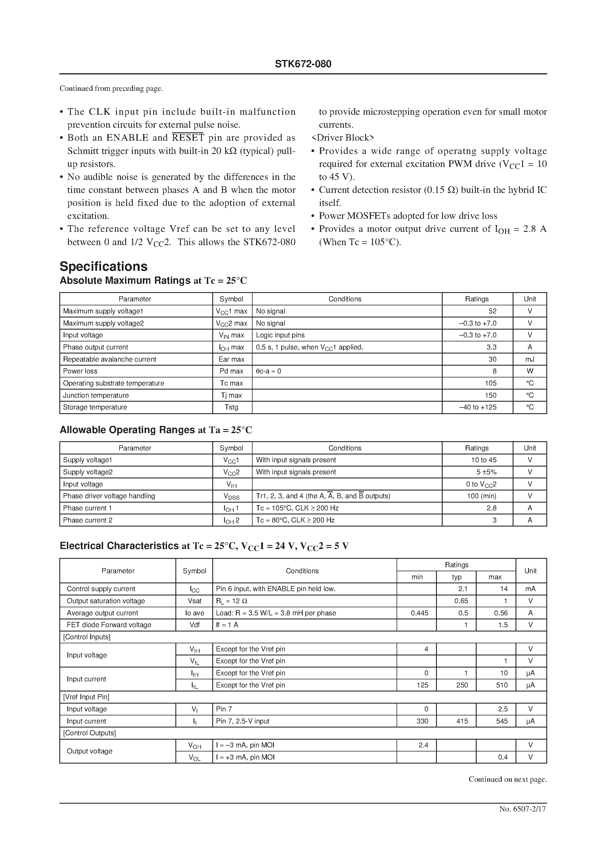

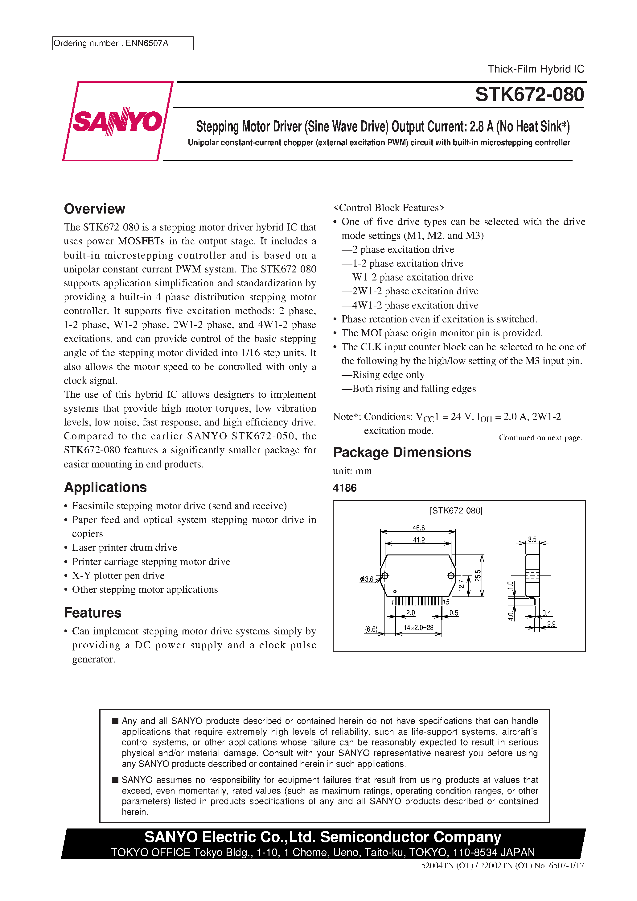

STK672-080-Stepping Motor Driver (Sine Wave Drive) Output Current : 2.8 A (No Heat Sink)
Producer:Sanyo Semicon Device
Description:Stepping Motor Driver (Sine Wave Drive) Output Current : 2.8 A (No Heat Sink)
